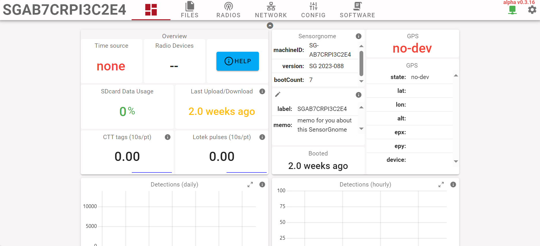

I’m attempting to upgrade many of my sensorgnomes to V2 software (2024-053), but I am having similar GPS issues. I’m hoping to deploy these receivers in a remote area without cell or internet connectivity and will need the GPS to work.
I’ve tried multiple power sources and running different GPS hats (Adafruit versions) but no changes. I receive the same no-dev. I’ve tried multiple reboots as well. Some of my other RPIs seem to have a much easier time working with the GPS. I’ve been conducting my testing at the field house with a clear line of sight to the sky. I have tested the archived version of the software (V1), and these units work in the same location and with the same power sources.
I will leave the SG-573ARPI3EDB9 running and connected to the internet for the next 24 hours or so to collect the software logs. Let me know if you have any thoughts.

I SSH’d into the gnome and ran that command and received:
