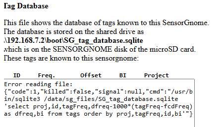

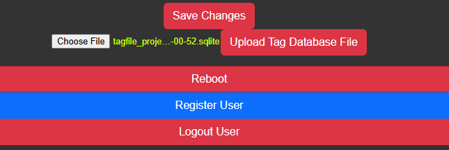

I tried to download my project Tag database from after I downloaded my tags on the Motus website Uploading a local tag database | SensorGnome User Guide and then upload it via the Ethernet Connection
but then
Error reading file: {“code”:1,“killed”:false,“signal”:null,“cmd”:“/usr/bin/sqlite3 /data/sg_files/SG_tag_database.sqlite ‘select proj,id,tagFreq,dfreq-1000*(tagFreq-fcdFreq) as dfreq,bi from tags order by proj,tagFreq,id,bi’”}
I know how to go in the command line, maybe try to fix it there?

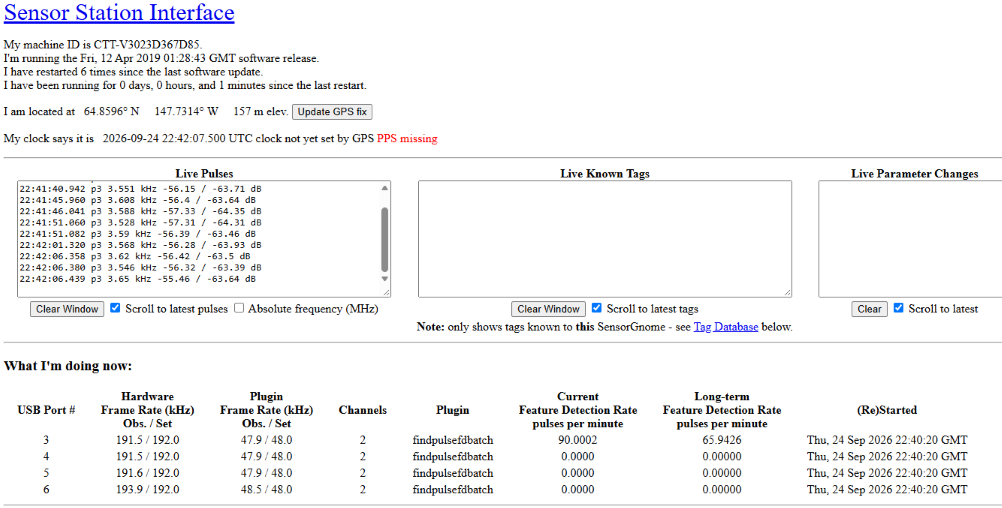

Thank you!! So much! I’m just trying to figure out why is the tag not showing up.. :) and then I will try to test the tower range once this tag gets detected. I know it is on, I can hear it on SRX Lotek receiver…
Here are also "Live Pulses and activity on USB port #3…

Eva, the error message look very familiar. i suspect it is due to sqlite file getting corrupted during upload to the sensorstation. i have a written a cheat sheet for what has worked for me. see this similar post in the motus community forum. it’s buried in there. if you cant find it there , or if it still fails please post back and we can try to work through it. https://community.motus.org/t/tag-database-file-upload-fail/1289 -Rich

Hi Rich, I just did what you suggested in your detailed instructions and it was QUICK and EASY to follow and i had it done in 20 minutes! Thank you so much! Now I can go around the town and start the real testing to see how far the tags will get detected! Thank you so much again!!
