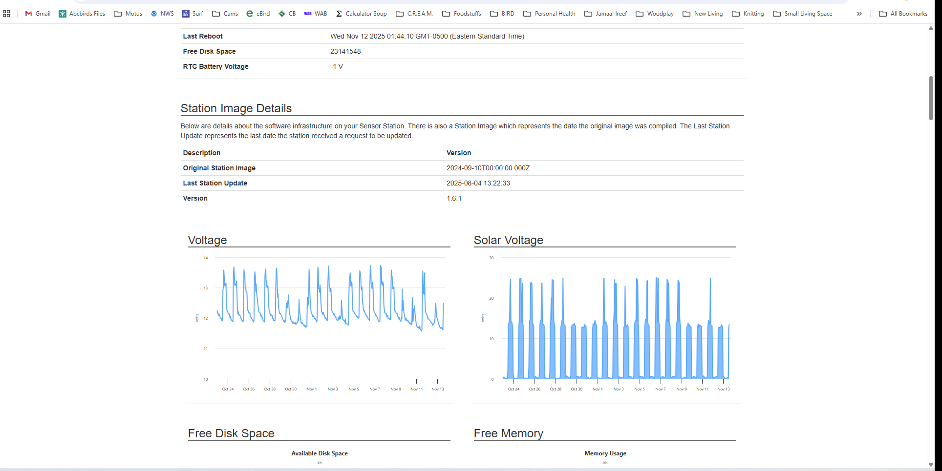

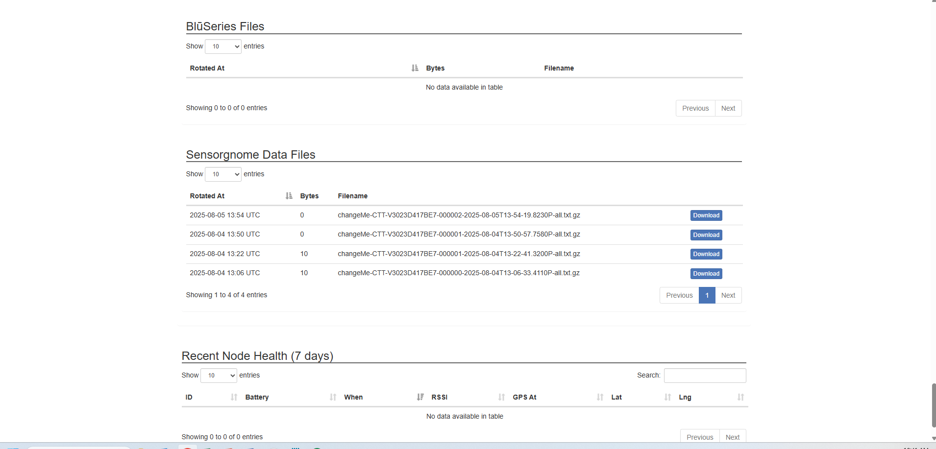

One of our cellular-connected V3.2 Sensorstations (V3023D417BE7) is behaving normally except for the fact that no SGdata files are being sent to the servers. Power is solar, but steady, and all other log files, check-ins and GPS files are regular and up to date. Cellular signal is very strong; recorded at -53db during last visit. Only running 2 antennas on each frequency, so very manageable load on the USB hub.
The issue was clocked withing 24 hours of deployment and was returned to a few days later. A manual data download produced regular, hourly SGdata files in daily folders for the four days it had been running at that point. Any reasons SGdata files would be written but not sent along with other data packets? Anyone else experience a bug like this?

I was finally able to fix the filename issue and your sensorgnome data is getting uploaded now. You should see it in your account within an hour or two.
Out of curiosity, was there something about the filename in this case that wasn’t matching the expected pattern or something else?
They named their SensorGnome files as “Petty’s Island…”. The single apostrophe was interpreted as unicode rather than ASCII, and Python (which we use to upload the files to our servers) didn’t like that unicode character.
I went ahead and changed the name in their deployment.txt file. In the future, we should advise people to not use spaces or apostrophes in the file name.
