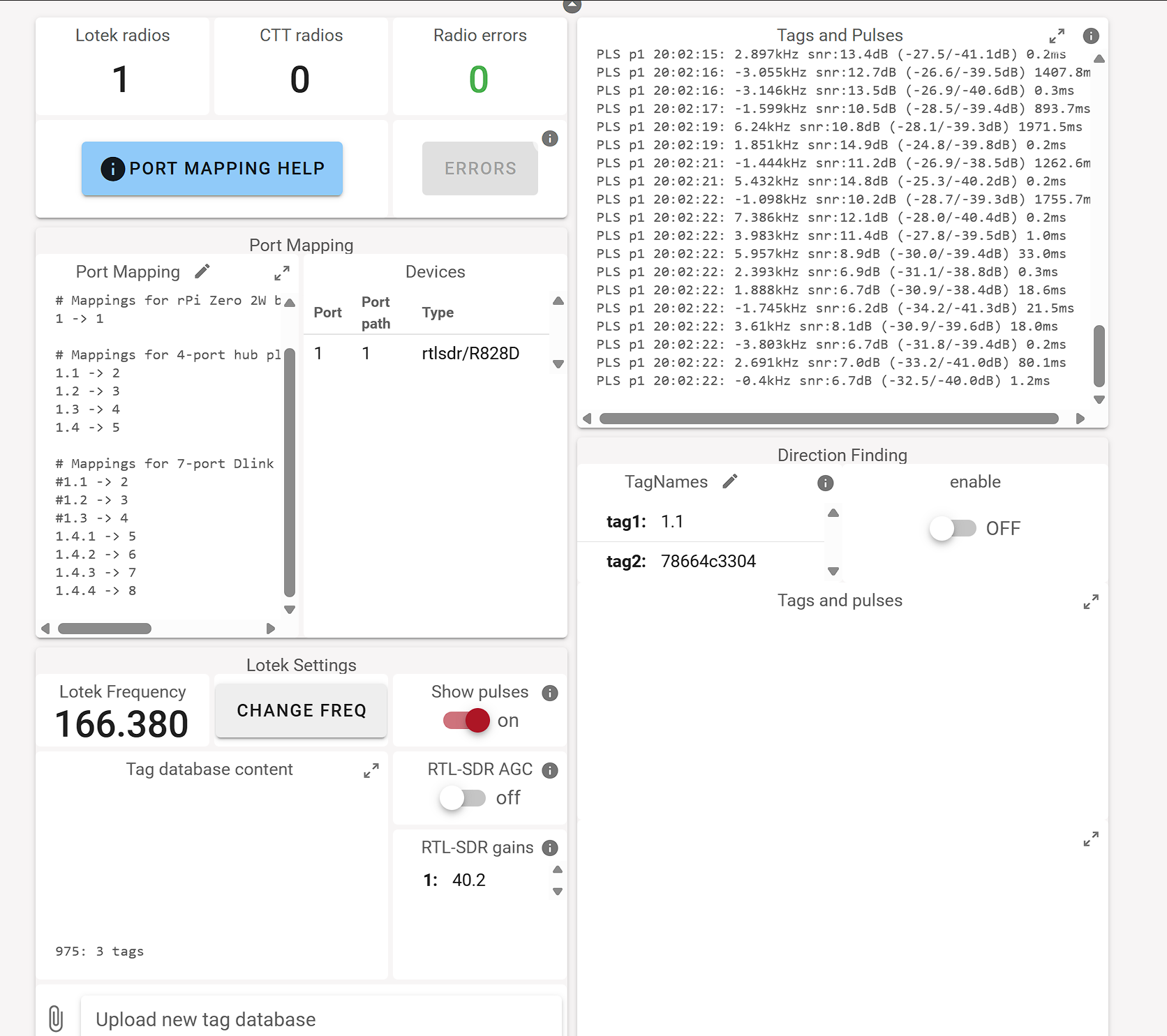

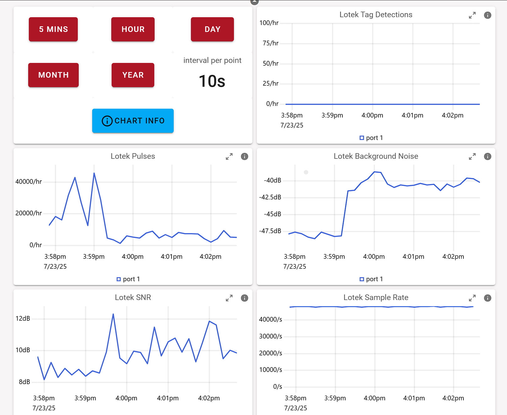

I can currently read out that pulses are being received by the sensorgnome, but these pulses do not correlate to a tag detection as seen below:

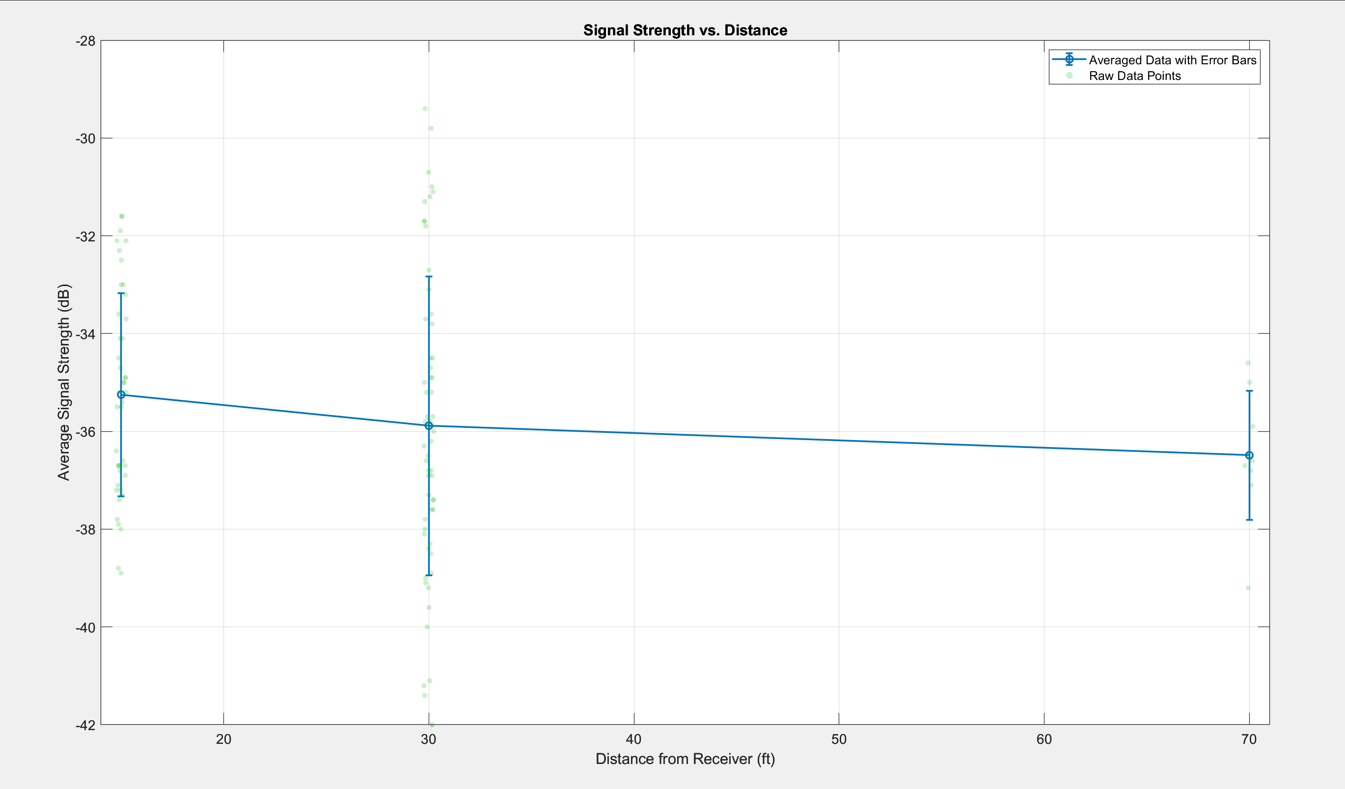

Preliminary testing of signal strength (copy and pasted from the local UI) against distance also show noisy/inconclusive results, which leads me to believe the pulses received at the SG are external noise and not the Lotek tags I’m looking for.

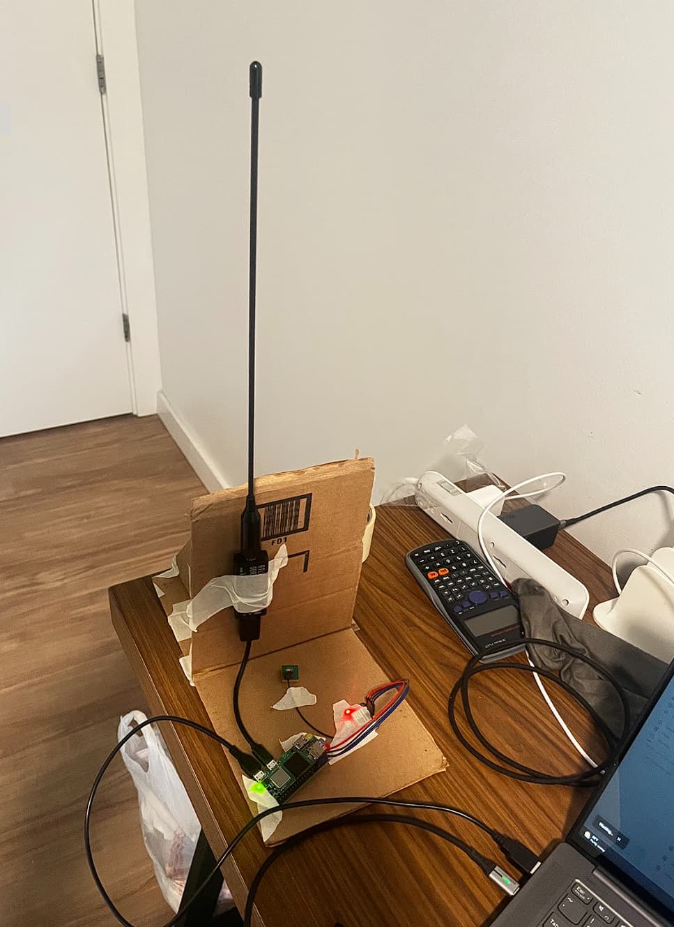

Attached is a picture of the current SG setup, powered by USB connection to a laptop,
, and the SG receiver info is as follows: Project ID: #975 Receiver ID: SG-035ERPZ28B0B

Moving on to the sensorgnome, I utilized the default configuration using a rpi zero 2W, and I’m not too sure how to test that this is working as expected. Attached are some logs from sessions where I record a lot of pulses with no tag detection. SG-035ERPZ28B0B-2025-07-23T20_14_26.930Z-logs.zip (1.9 MB)

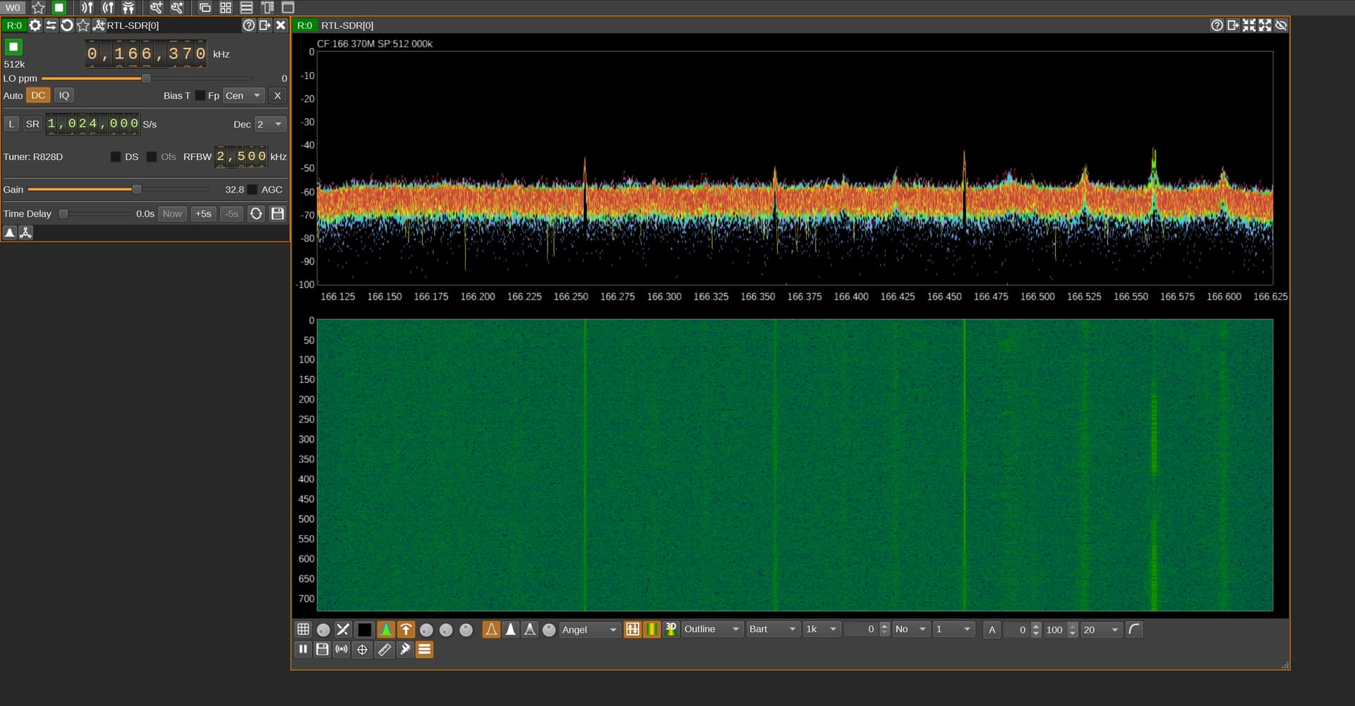

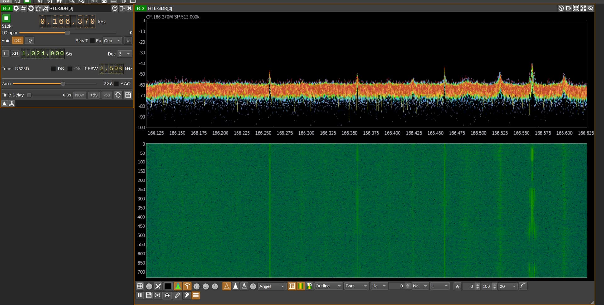

Lastly, to check that the tags have been activated and working as expected, I saw from this forum that SDRangel can be used to check the pulses of the tags, attached are screenshots of the output when the tags are
Right next to the antenna:
Placed in a metal cabinet to prevent the signal from being read:
Attached is also a video of the output when tags are placed next to the antenna, I didn’t see any distinct blips/pulses to show the tags are outputting a signal, which I’m taking to mean that I’m not getting tag detections because my tags aren’t activated.
