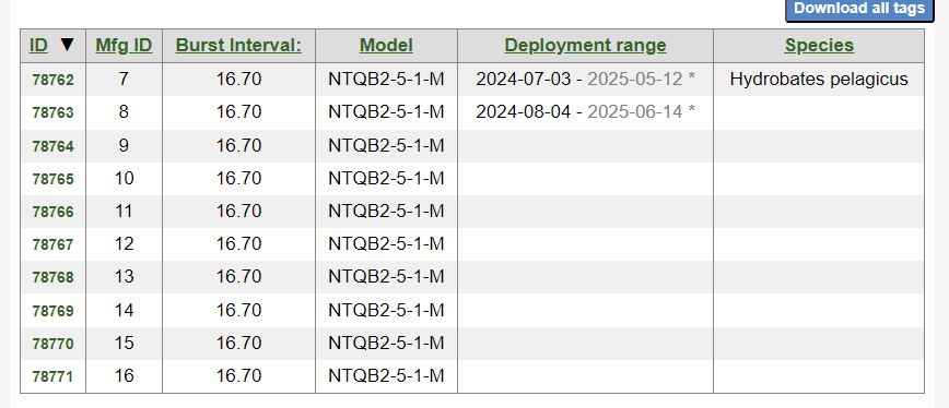

John is a member of Project 652 only so I’m assuming that’s the project in question. If so, there are two tags with deployments (and they would be the only two tags from this project that would be detected).
@user983 when you say you see chirps on the SG interface of the SensorStation, are you referring to the live pulses pane or have you uploaded the tag database to the SS? The latter would be the best approach since you would then be able to spot the tag code of those two tags and easily differentiate that from background radio noise.

CTT-V30B0154C55F is the station ID Tag pane shows tag 652#8
Hope that’s what you need.
And with regard to project 843 it is receivers “CTT-99F6C7F5204A” and “CTT-3749D48FB064” with either 84378 or 84377 tag.
Tag ID for the ABO site is 78763.
