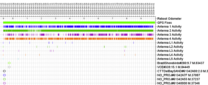

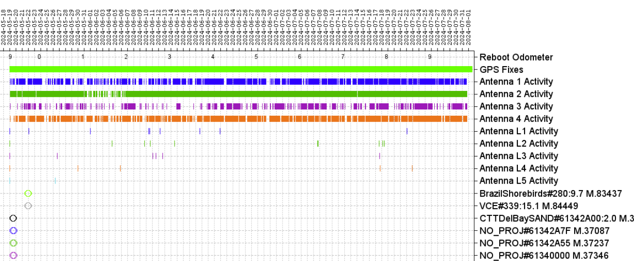

  • The detection timeline shows detections at an hourly resolution

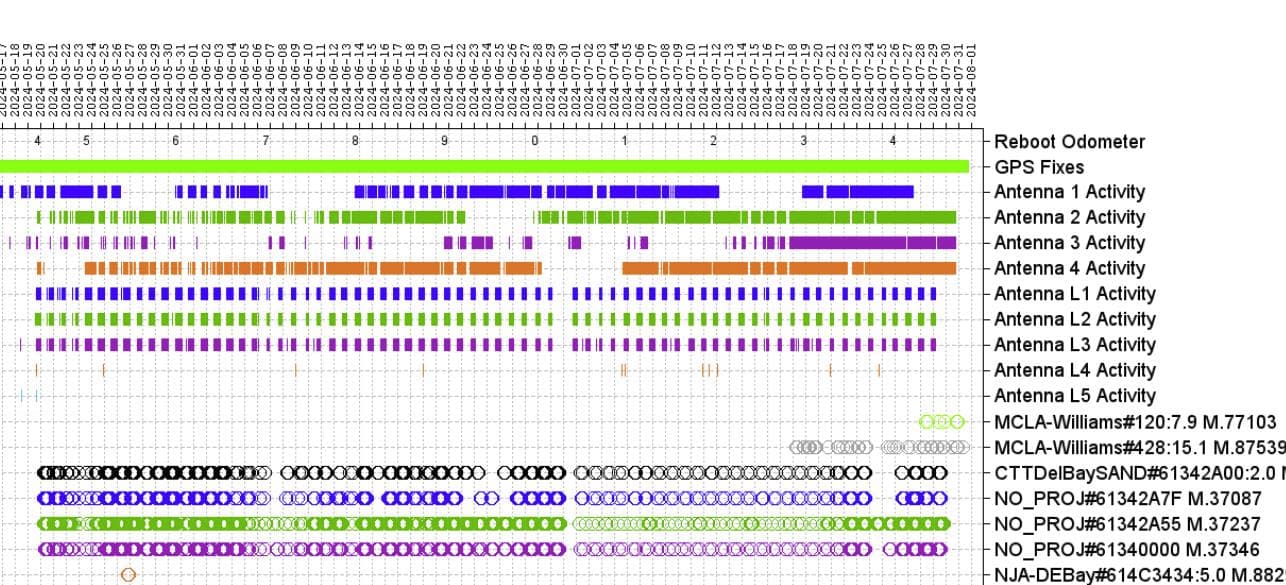

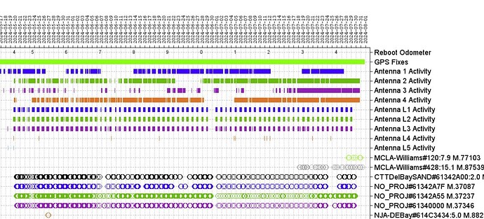

  • The deployment timeline (which may show detections on non-registered CTT tags) also shows “detections” of 3 other CTT tags during this same period. The codes all begin with “6134***”, which suggests they are false positives caused by corrupted tag signals – where the tail end of the code is corrupted into something else. One of those tag codes (6134000) is an extremely common corruption of many other actual codes.
  • This tag was briefly picked up at Sessions Woods the day before October Mountain. Again the same 4 tag codes were associated with it in the deployment timeline.
It definitely appears that a physical tag is present. It could be the tag with the deployment (perhaps it was recovered and this wasn’t recorded) or one of the two other non-registered tags that’s showing up. Of course it could be something else, but that would seem to be the most likely option!

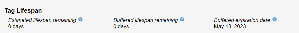

Regardless of whether or not there is a physical tag there, there is also a bug. The “buffered expiration date” was in May 2023. Any detections after this date should not have been displayed on Motus, yet whatever the source of these “detections”, they are still showing up.
