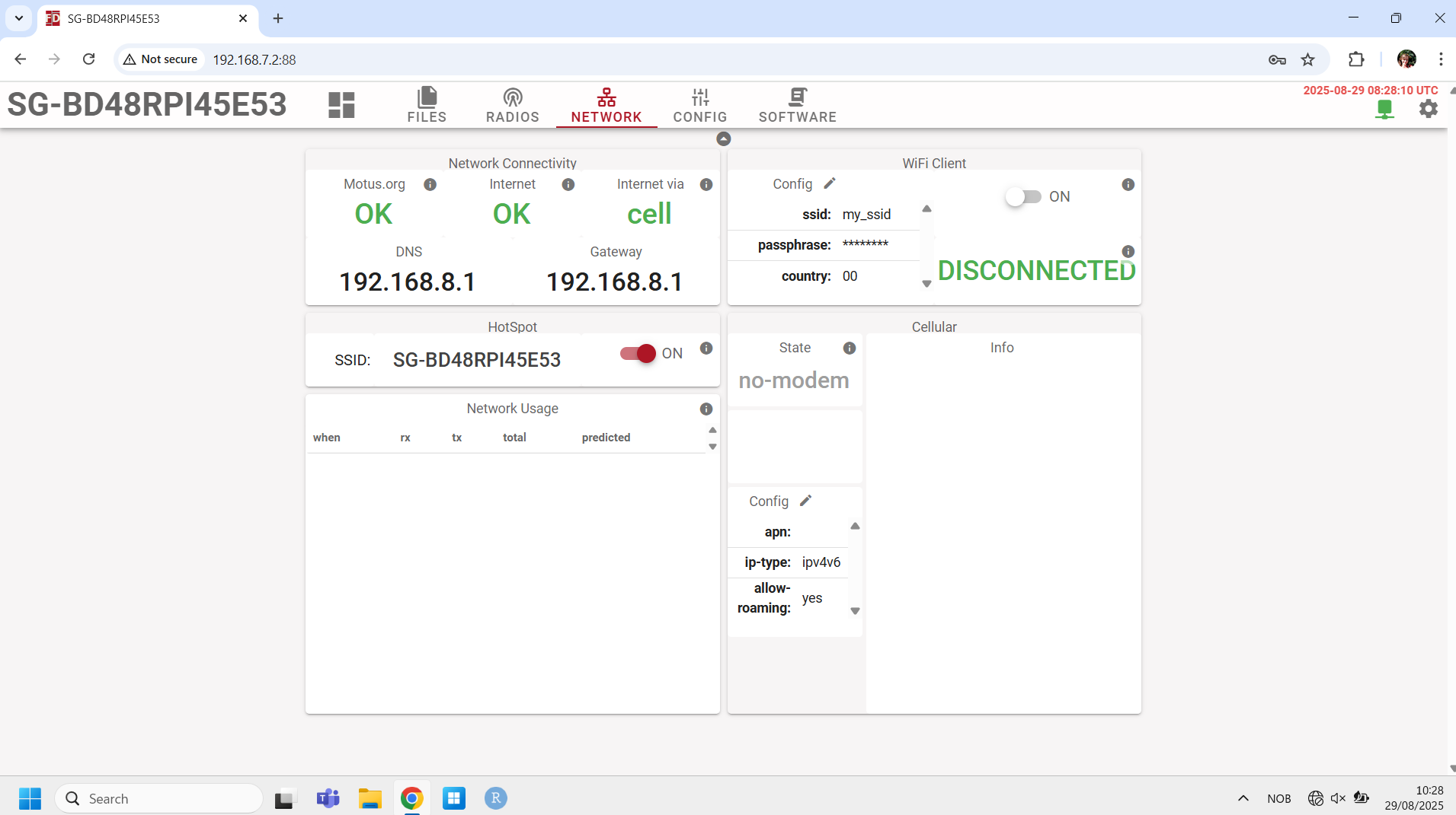

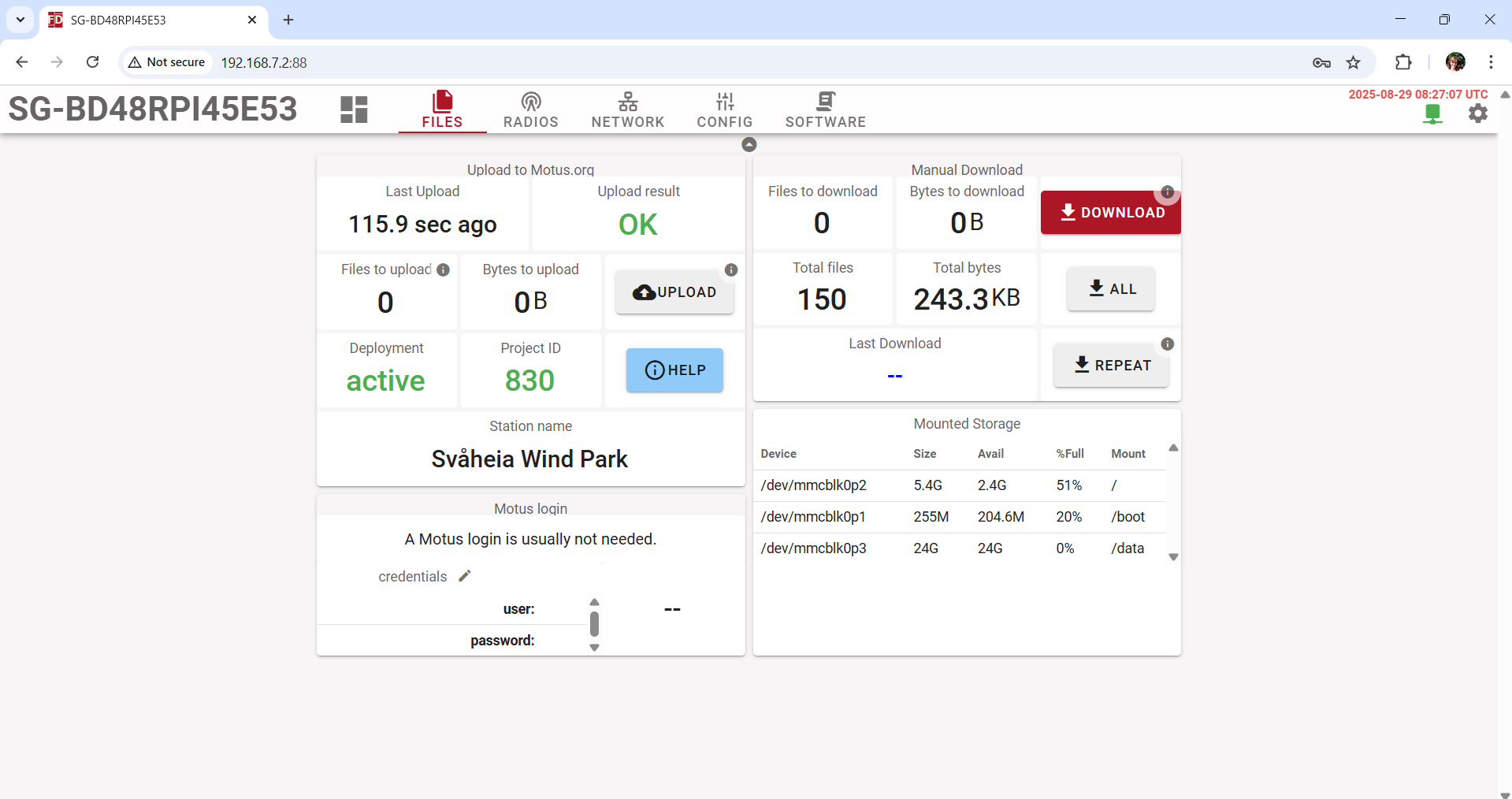

I’ve added a few screenshots of how the station looks like right before you leave.
I took a look at the logs, thanks for keeping the SG powered and managing to reconnect it periodically: this allowed the logs for the periods without connectivity to upload.
As far as I can tell, about an hour after you disconnect from the SG’s access point the SG can no longer make DNS resolutions over the cell network. I’m not seeing any errors, other than the failed resolutions. Right now, I don’t have any ideas… :face_with_bags_under_eyes:
I’m wondering whether there is some timeout and whether it takes the cell modem too long to reconnect or whether it just doesn’t reconnect. Mysterious.
(For others wondering: this is a set-up with a USB cell dongle which shows up as an ethernet device to the SG, i.e., the SG has no idea it’s actually a cell modem.)

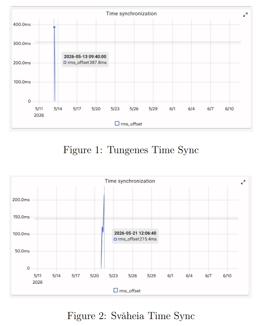

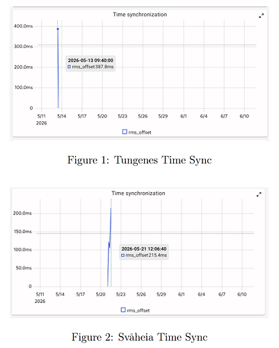

We are wondering now if there is a time sync problem (https://raspberrypi.stackexchange.com/questions/132312/raspberry-pi-cannot-synchronize-clock) that is causing the issues we have:
We will try to change the timeout variable for both stations and see if that fixes the problem. Is it correct to assume that we can connect to our stations remotely to change the timeout variable? On both of the stations it took quite a long time to actually get a GPS fix with the G-mouse receiver we are using. We were also wondering the need for the G-mouse in the system, if we have correct metadata for the station on the website and the 4G dongle could provide with the time, can we just remove the GPS?

The suspicion that the time sync is the problem seems suspect to me because your station stops working after only an hour. The rPi clock doesn’t drift by enough to prevent TLS connections from completing in that amount of time. The TLS drift allowance is a few minutes (it depends on implementation) and it would take an rPi several days to drift that much. We’re certainly not talking milliseconds here.
