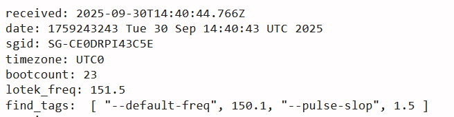

According to the logs it appears to have been set correctly, but the info log (on sensorgnome.net) appears to show the default frequency is set to 150.1, but it also says “lotek_freq = 151.5” so I’m not sure what’s going on there.
If you’re able to revisit the site, take a look at the web interface under the “config” tab to see what the –default-freq is set to under “module_options”.

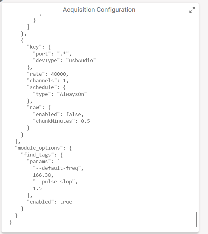

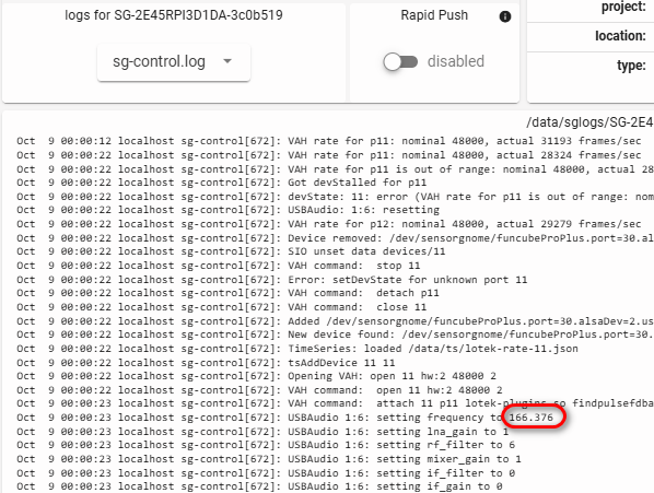

Also note that, while 151.5 is the frequency the tags broadcast at, it’s not actually what the FunCubes are set to. Rather, they are set 4 kHz below the nominal. You will be able to confirm this in your logs. I’ve given an example below of an SG here in Canada that listening for tags on 166.380. This adjustment should take place automatically when you select the nominal frequency in the UI, but it’s helpful context if you are looking in the sgcontrol logs and wonder why you are seeing frequency values of 151.496 instead of the 151.5 that you set! And example below of a receiver here in Canada listening for tags at the nominal frequency of 166.38
