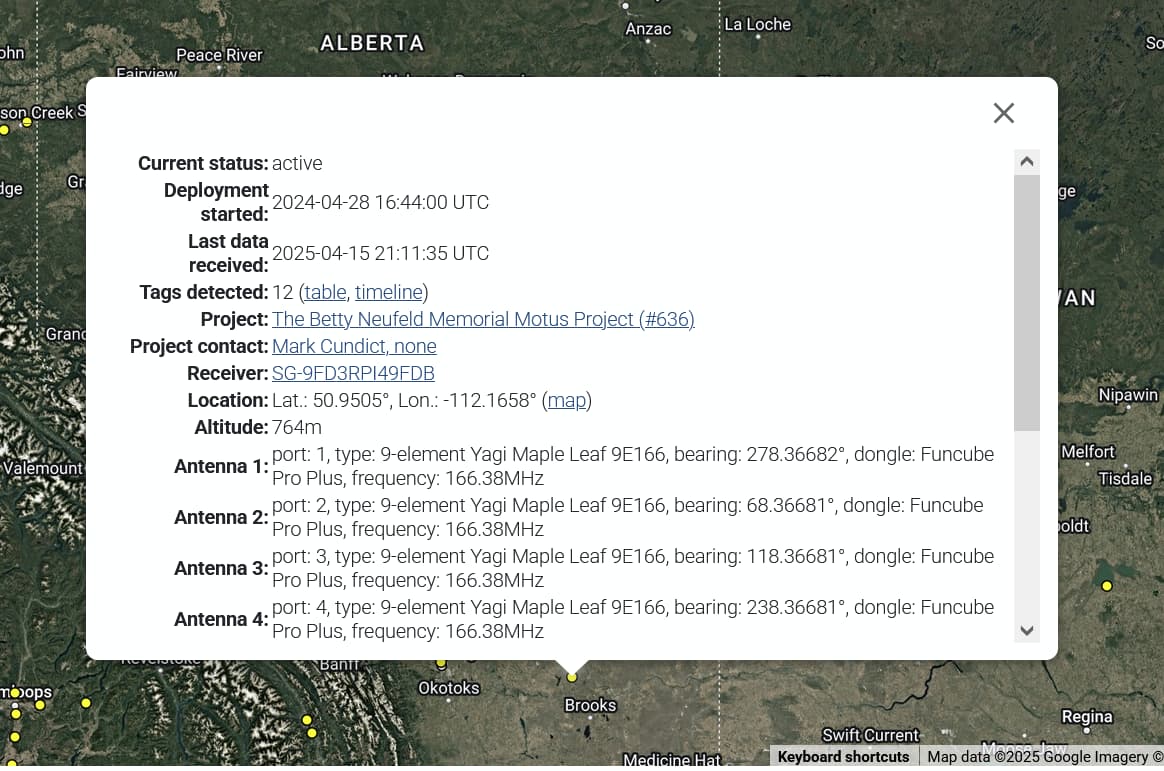

Seems the “Last data received:” is getting further behind realtime for SensorGnome (SG) stations. CTT stations seem unaffected.
The SG Hub shows all is well and up to date, so I’m guessing it’s just a graphics bug.

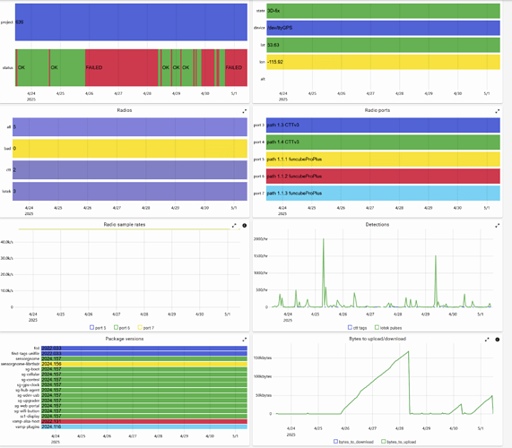

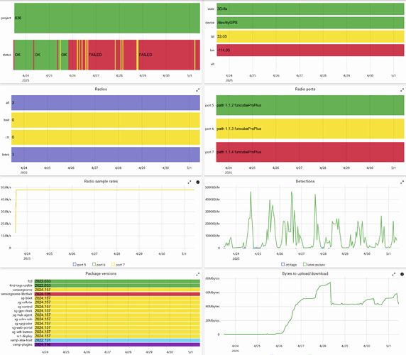

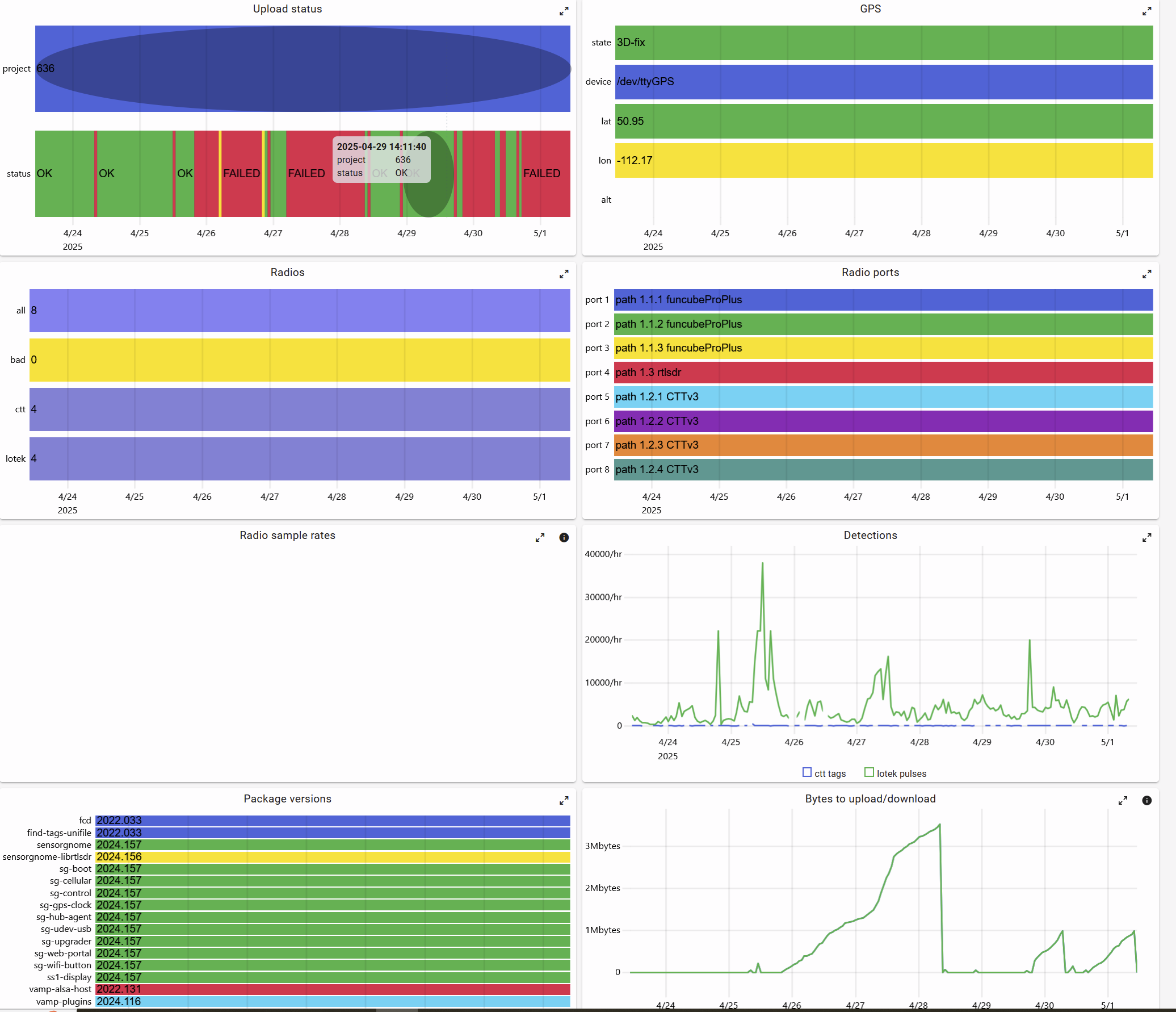

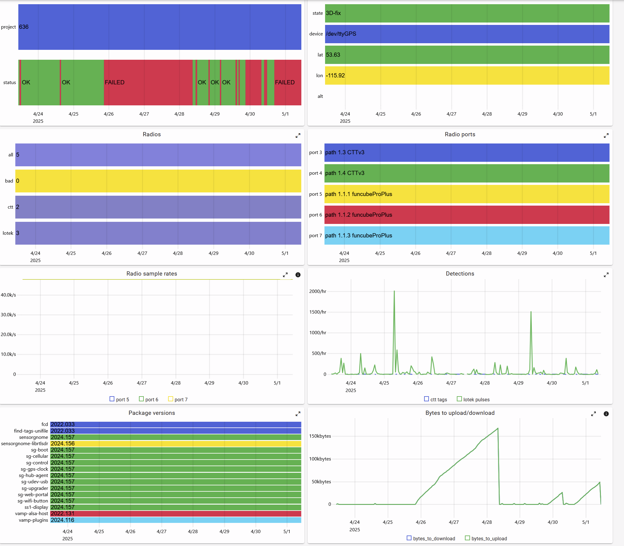

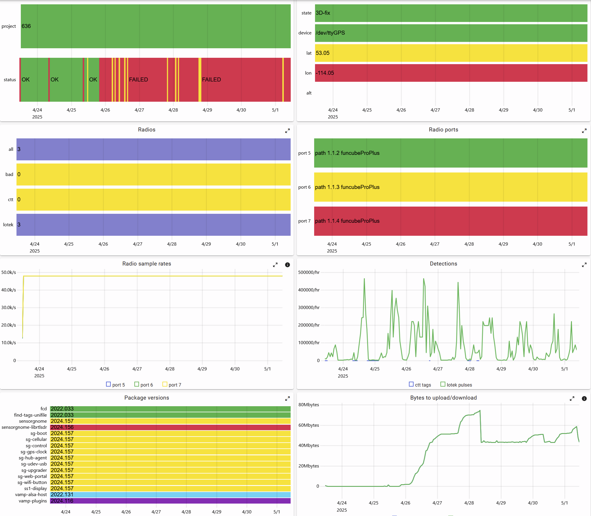

Hi again,
Could this be caused by the recent high failure rate on uploads (to the main server from the SG). Seems most of the SG’s I checked on the SG HUB are experiencing a lot of upload failures and the red / green pattern is very similar between SG’s.
Could there be a bandwidth issue on the server as more stations are being brought online? Don’t remember seeing this much ‘red’ last year?
First capture is from SG-9FD3RPI49FDB Gem AB (moderate file sizes)
Second snip is from SG-DB47RPI40A9E Carrot Creek AB (small file sizes, very clean site)
Third snip is from SG-77BFRPI4B4A1 Pigeon Lake AB (very large file sizes, a very noisy site during the day)
Just some observations. Hopefully helpful.
Mark
Hi Mark, we’ve been experiencing a lot of server related issues in the last couple weeks which is undoubtedly responsible for some of the issues. Just today again, the server was down temporarily. It’s easy for even a short outage to create more issues since processing can get backed up pretty quickly. Something like this may also affect uploads as you suggest as a large number of SG’s attempt to upload data around the same time when the server comes back online.
