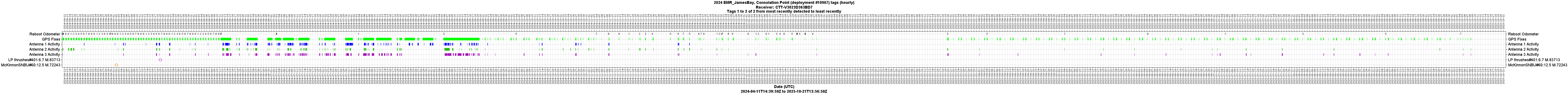

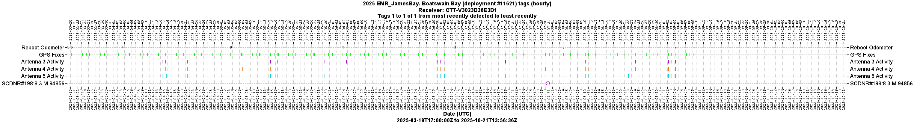

The deployment plots for the two stations are below. You can see the reboot odometer does not update each time it starts collecting data, which helps confirm there is no reboot occurring. My best guess is that it’s as if the SensorGnome Control process is breaking and then restarting sometimes. I have asked our partners to download the SG logs next time they visit either station, but it may not be for a while due to how remote they are.

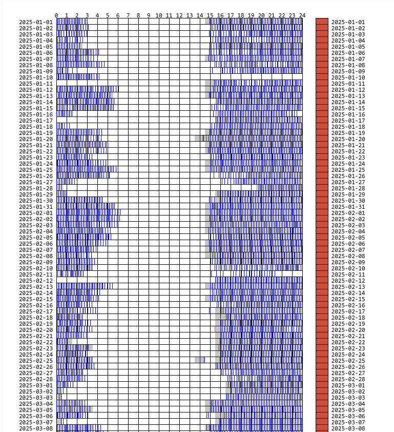

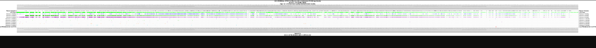

Lucas, what kind of power setup are you using, and specifically what type of battery? We have some stations that look exactly like the second screenshot you have here, where in the colder parts of the year (and in some cases year-round) the gps bar is choppy and the station is rebooting daily. We have seen some correlation with using LiPO4 batteries, and my theory is that the onboard battery management system is causing the battery to shut down overnight when it’s even colder. See screenshots you can see in the receiver timeline what time of the day the active gps hits are coming through.
