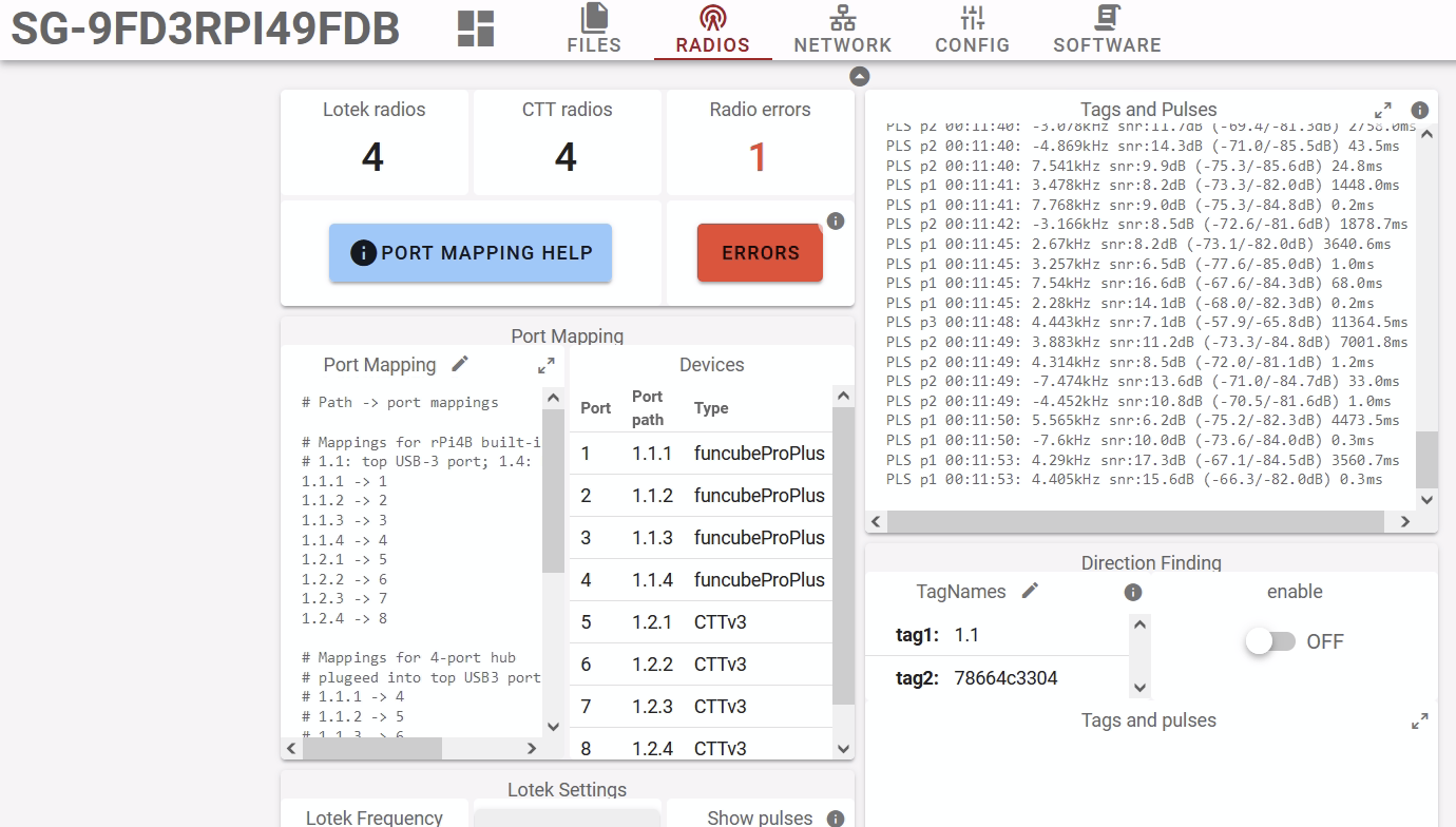

First two SG_Ugrade’s went well. The first station has two Lotek antennas on a 4 port USB hub. The second station has three Lotek antenna’s on a 4 port USB hub

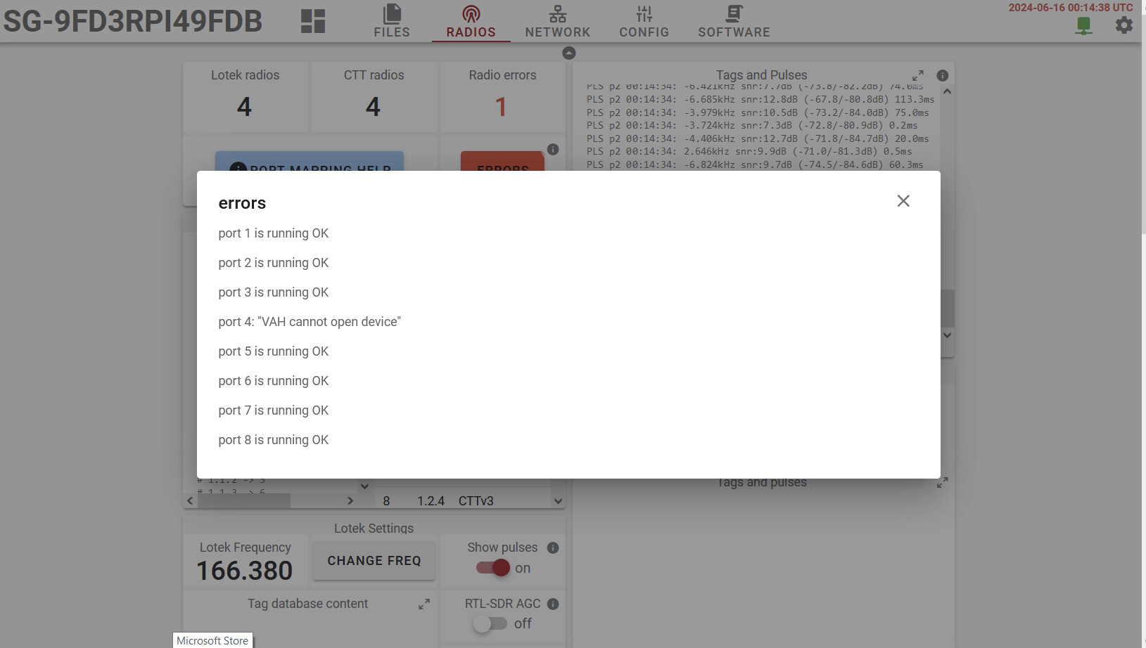

Third station now has an error message I haven’t seen before.
when I click on the red “ERROR” button I get
This station is RPi 4B, using two 4 port USB hubs: 1-4 Lotek, 5-8 CTT.
Any ideas?
1 « J'aime »
Yup! Please read about the FCD issues and my rPi recommendations: FUNcube sample rate dropping and disconnecting - FIXED. The new software is highlighting problems that went unnoticed before (at least that’s what it’s looking like). You may have better luck if you spread the FCDs across the two hubs. But it may also be a different issue. I’ll take a look at the logs when I have a moment.
Update, looking at syslog:
Jun 16 00:01:53 localhost kernel: [4174395.837152] usb 1-1.1.4: reset full-speed USB device number 16 using xhci_hcd
Jun 16 00:01:53 localhost kernel: [4174396.010931] usb 1-1.1.4: 1:1: cannot get freq at ep 0x81
Jun 16 00:01:53 localhost kernel: [4174396.011196] usb 1-1.1.4: Not enough bandwidth for new device state.
Jun 16 00:01:53 localhost kernel: [4174396.011214] usb 1-1.1.4: Not enough bandwidth for altsetting 1
First line is reset of the FCD, second is a normal “error” message, third and fourth tell the story. I haven’t tried 4x FCDs on Pi4B, you may be able to get it to work by placing 2 on each hub if they actually are Multi-TT hubs. If they aren’t, each hub can only take one FCD, see that other thread I linked to.

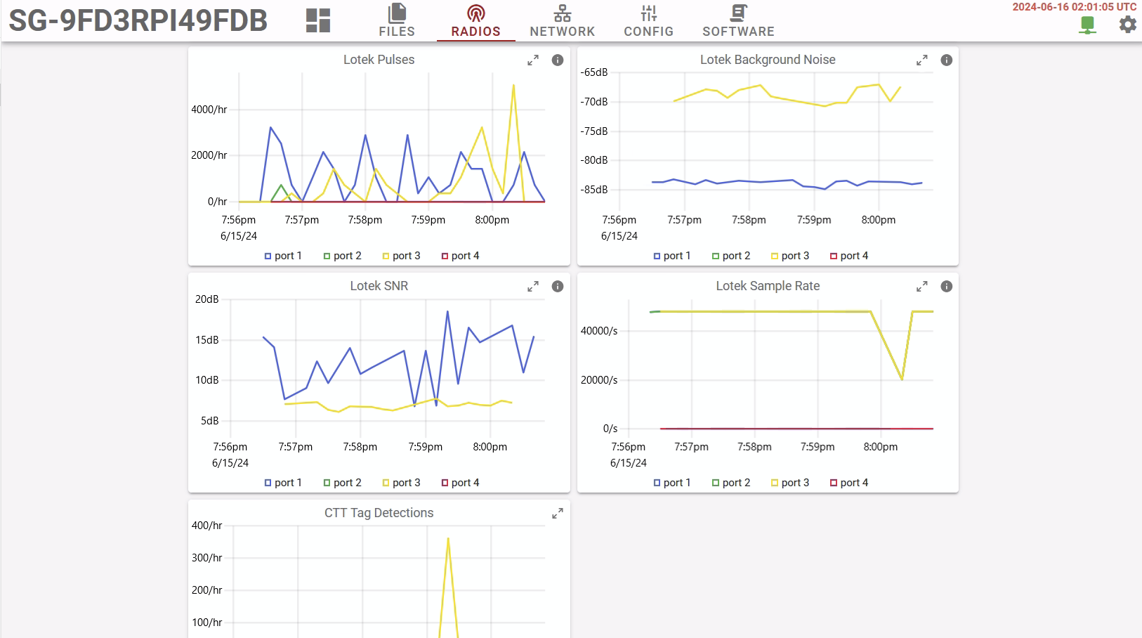

Rebooted, and so far no more errors! However the sample rate for port 4 now shows zero. Sigh.
The next time I’m out at the station, I’ll try a few things (and bring along an
RTL-SDR or two).
Update: Just checked the R files for that station… indeed positive and false positive Lotek tags have been seen only on ports 1 thru 3, none seen on port 4. Looks like this station has had this port 4 issue for a while and the new software has made the issue obvious enough for me to notice. Thanks.
