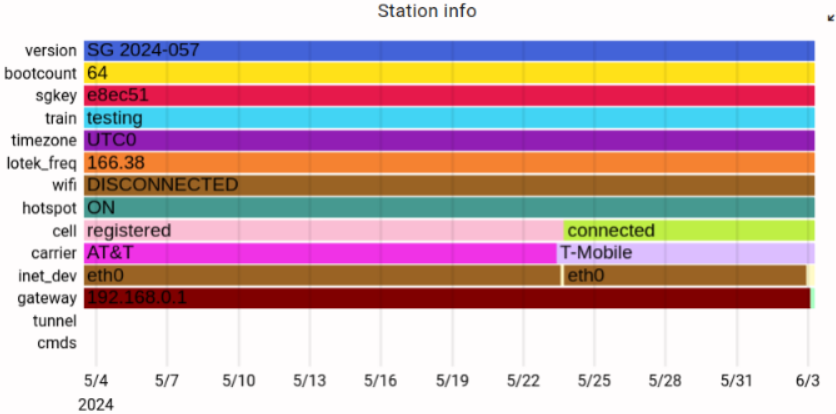

SGhub currently has some of this info (see bottom 4 lines), is this what you’re looking for?
Yeah that carrier info is present; wonder where (or when) it was that I wasn’t seeing it!
