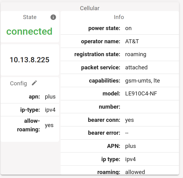

The first place to look for information is the cellular panel in the web UI, the Info portion shows some error information and while the modem is searching it typ. shows the set of carriers heard by the modem (scrolling down may be necessary).
Web UI panel
The cell modem stat field is the first place to look, it has a small help pop-up for the meaning of the various values:
- no modem: no hardware detected, is the USB cable plugged in (even if it’s a HAT)?
- disabled: SG software has not enabled the modem yet
- enabled: modem is trying to register (“connect with”) cellular network, this may take time and never change if the SIM does not provide service
- searching: modem is trying to locate a carrier to connect to, or in the process of connecting to a carrier; this may be transient if the modem is going from one carrier to the next or it may be more persistent if no carrier is found, the info panel should have a list of carriers seen by the modem
- registering: transient state attempting to register with cellular network, at this point the modem is talking to a tower and trying to get the SIM accepted
- registered: connected to the cellular network but no internet access; this could be due to an incorrect APN, a SIM that is not fully enabled or out of data allowance, or a SIM that does not allow roaming on the carrier chosen by the modem; my modem sometimes reverts to this state due to an error which requires a modem reset (ugh)
- connected: connected to the cellular network and internet access according to the modem
