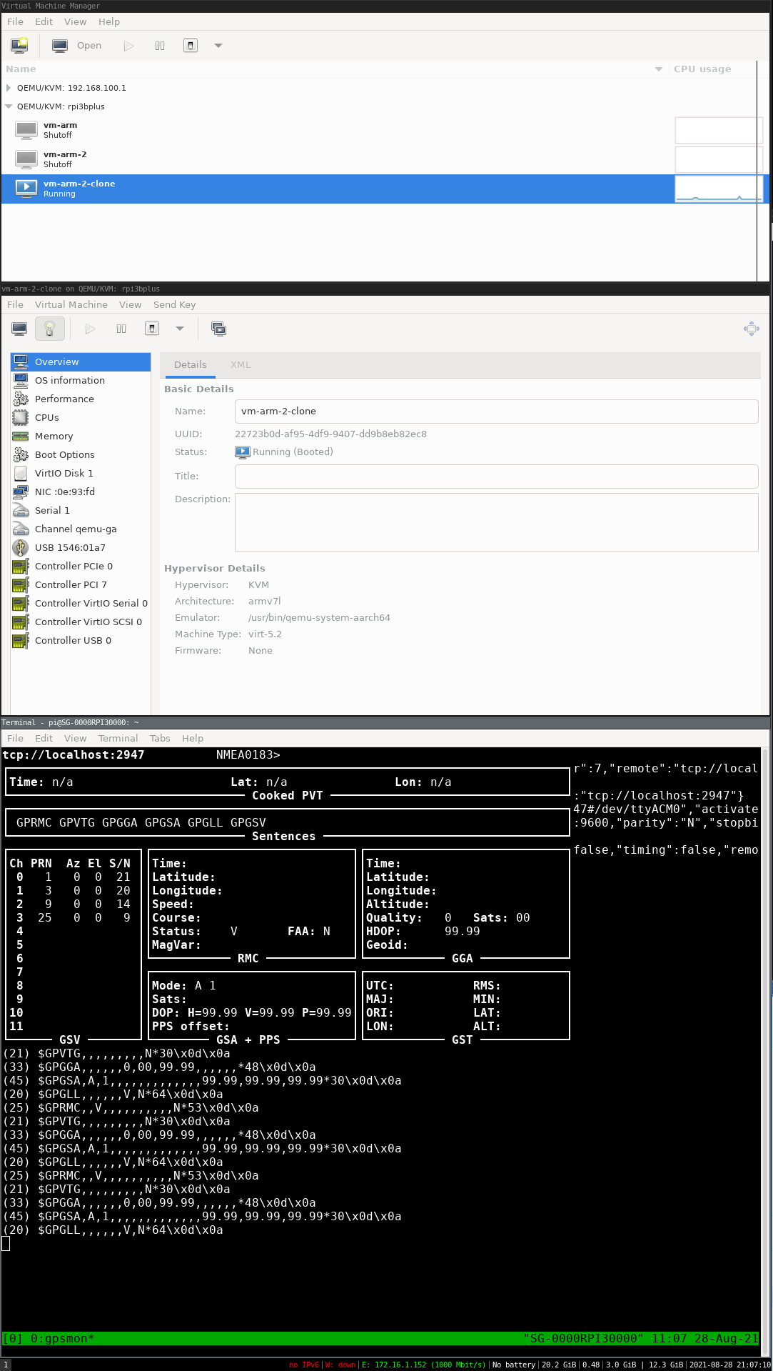

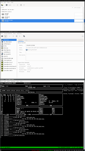

Hi Team.
I have the 2018 image booting in a VM on an aarch64 host with usb passthrough for GPS time working.
TL;DR is new kernel with LPAE and CONFIG_PCI_HOST_GENERIC=y, plus the virtio drivers.
Further work to get the system working by this method is still going to require modification of the init scripts.
I’m yet to investigate booting the 2018 image with a new kernel on a 3bplus.
Still yet to investigate manual .deb install process on a generic 32 bit Debian image
I am yet to investigate rpi-gen / build_raspbian.py.
Regards,
Evan.
