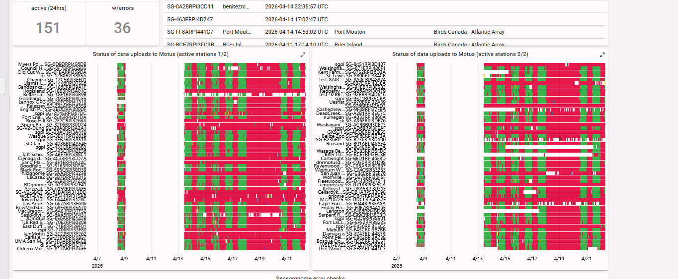

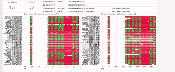

@TvE looking at the last couple weeks on sensorgnome.net, I’m wondering what the implication is of the periods of sever issues on data uploads. Are the missing blocks just reflective of missing logs, or are there also data files that weren’t uploaded during the apparent down time?

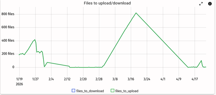

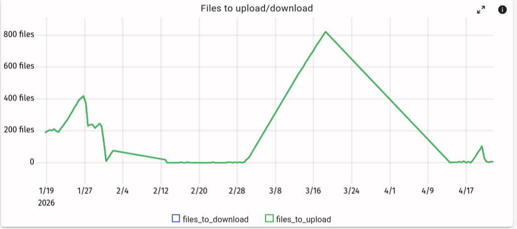

The gaps only affect the stats and logs sent to sensorgnome.net, they are not related to data uploads to Motus. Those are performed independently. If you’re concerned about a specific station you can look at the “files to upload” chart on the station tab. For example:
This shows that currently there are practically no files to upload, thus the uploads have caught up with any backlog.
