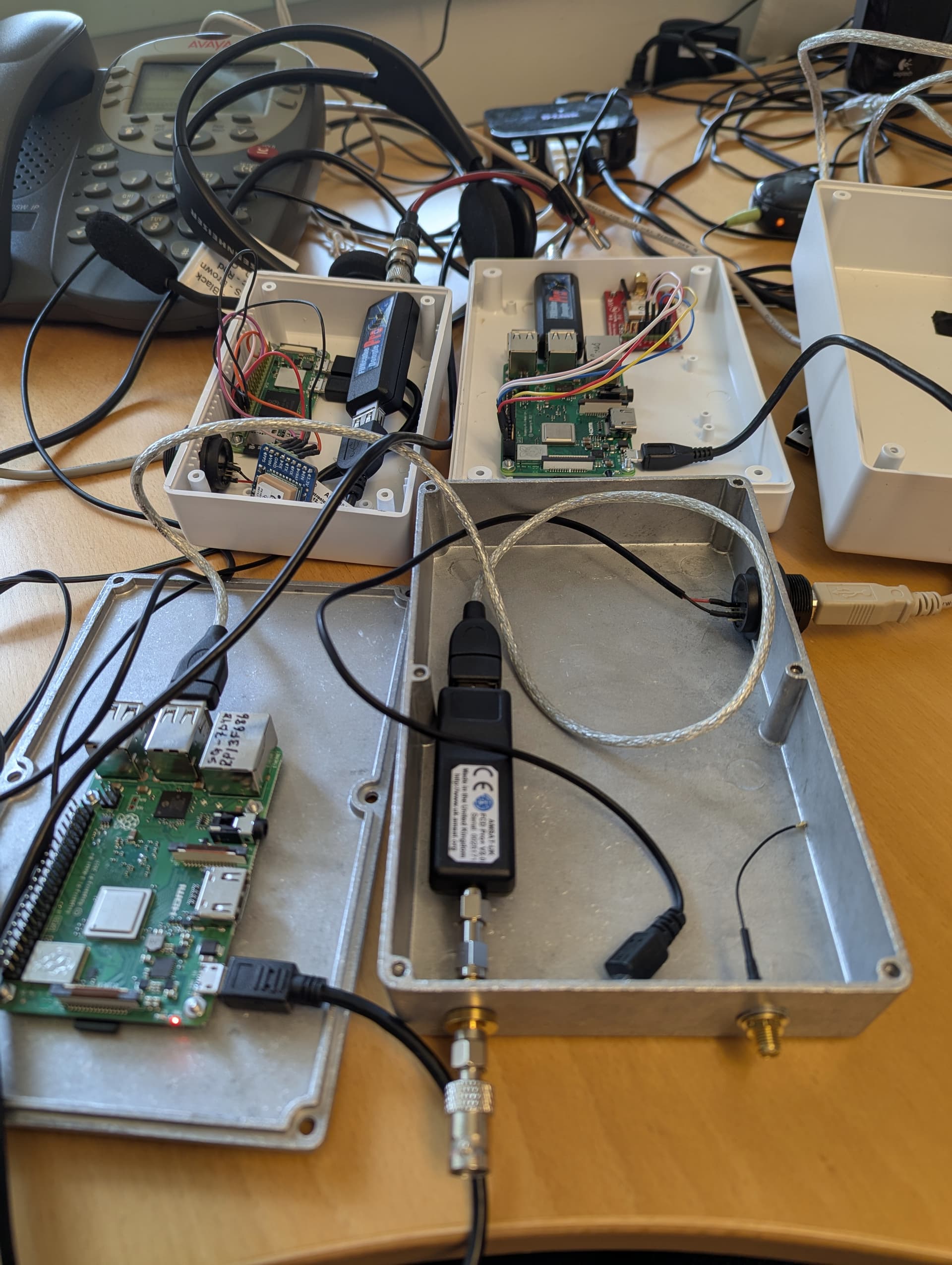

Did anyone consider adding audio to a V2 sensorgnome? I am building a portable SG to be used with a handheld directional antenna and a wifi-connected smartphone, and it would be nice to be able to hear the change in amplitude while turning the antenna.

However, I don’t want to bring a laptop in the field, so I am looking for a more compact solution. The Pi3 has an audio output, so it would be a matter of routing the USB audio from the FCD to that output.
I am a radio engineer, unfortunately not a Linux nerd, so I am not sure how to create that connection. ;-)
I might add that I build my own sensorgnome stations, much smaller than the commercial versions.
