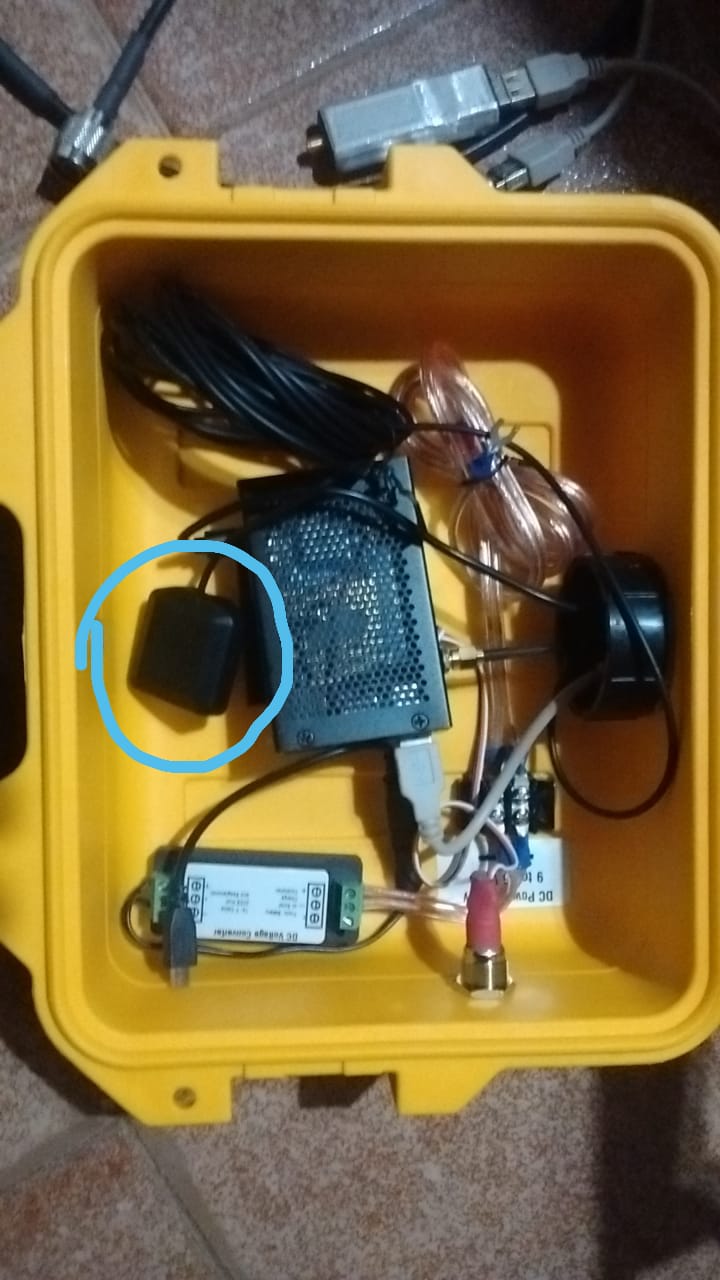

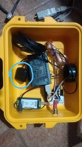

Hi, thanks for your help. Maybe I need to backtrack a little. Is this the GPS (circled in blue)?
The person who gave me the SensorGnome told me that this is the GPS. But my collaborators, who now have the SG in Argentina, say that the GPS seems to be inside the Raspberry Pi:
“When we put the black square outside to try to get a signal we had wifi but no GPS.
When we put the yellow box outside with the raspberry pi we got GPS.”
Sorry for the confusion; I am 10,000 km away troubleshooting via text message.
Kristina
Hello Kristina,
It looks like you already have what they need. That thing you circled is what I was going to send. It is a GPS antenna or “hat”. All you need to have them do is take that hat, unwind the cord and feed it out through the hole in the box. If it won’t fit, it should be possible to unscrew it and thread the little end through the hole and screw it back in. Then you just need to get that hat up above the roof someplace. It has a built-In Magnet for attaching to anything iron. You ca. also just cable tie it to a nail or something.
Feel free to have them contact me directly if that is helpful.
