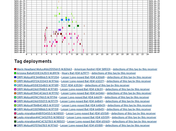

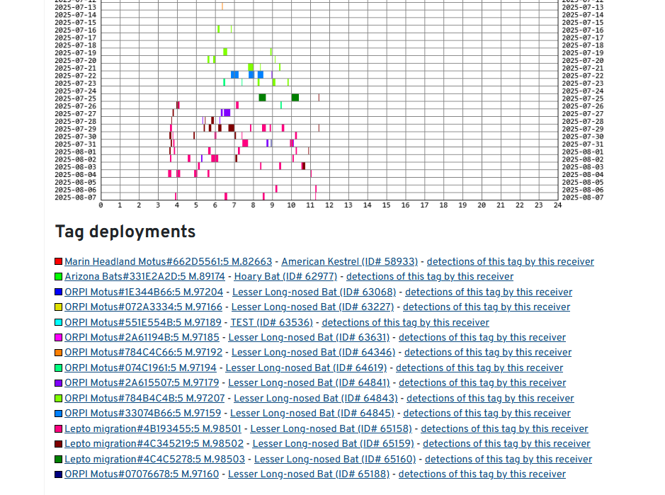

Has anyone had a chance to review the bat species showing up twice in Motus under “bats” and “mammals”? Also, do you know if having it listed twice will interfere in data analysis or not?
Hi Holly, it’s due to how they are being summarized on the explore dashboard and wouldn’t affect the underlying data. Assuming that yours are like Cory’s and aren’t actually duplicated deployment records. Does everything look as expected to you if you view these on the old explore pages: Motus Wildlife Tracking System?
