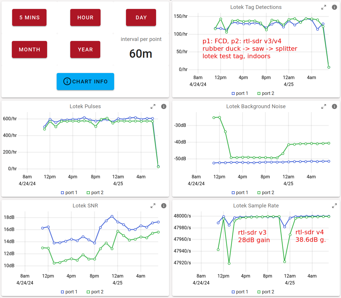

For example, in blue FCD, in green rtl-sdr.com v3 from ~1:30pm to 12am; rtl-sdr.com v4 after 12am.
The RTL-SDRs both detect more tag transmissions than the FCD. The FCD picked up more pulses than the RTL-SDRs, but evidently fewer were aggregated into tags detections.
As expected the SNR seen by the FCD was higher than that seen by the RTL-SDRs. The SNR reported by the rtl-sdr v4 seems to be a tad better than the v3’s but this may be related to the fact that I tweaked the gain on the V4. (This particular test also had a filter in the chain, but I’ve seen the same type of scenario in other tests without.)

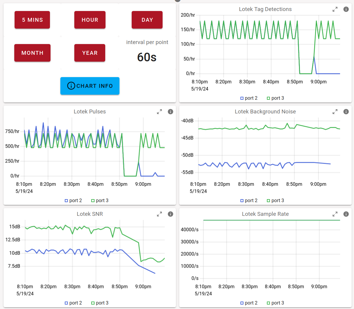

The SNR of the FCD is not always higher than the RTL-SDR. For example:
For these charts the receivers were on the station Yagi and the tag was on my deck ~50m away, off axis from the antenna. The SNR of the RTL-SDR (green) was significantly higher than that of the FCD (blue) until I moved the tag 2m over at which point the FCD’s SNR improved and its reported noise dropped a lot. I have no explanation.

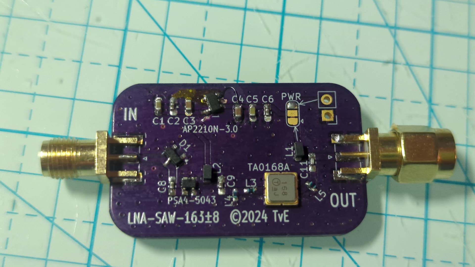

After the conclusions reached with the filters a couple of weeks ago I designed a little LNA+filter device:

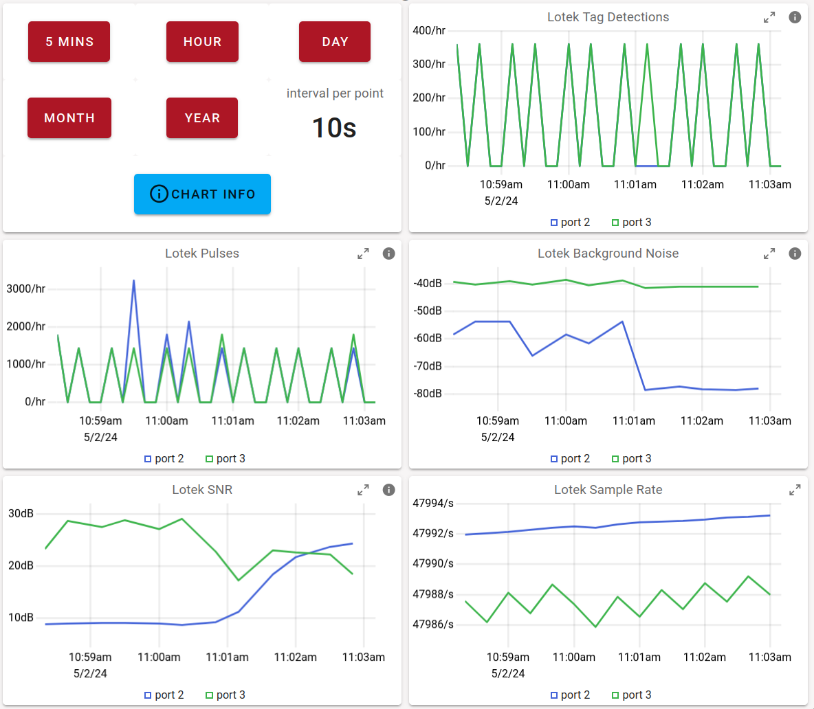

I finally managed to test it, although the set-up is not ideal. I have an rPi4 with an FCD and an rtl-sdr.com v4 dongle. In front of the rtl-sdr I have the LNA+filter, and then the yagi antenna is attached to a splitter which feeds the FCD on one side and the LNA-filter-rtl-sdr on the other.
The test tag is placed some 50ft in the back of the antenna a bit off-axis and come in at around 10-15dB SNR where I first placed it. I used a little plastic bottle with a sponge and water for a total of 30g to simulate a bird body and taped the tag to that. The bottle fell over at 8:52pm causing no more reception. I placed it in a slightly different spot just before 9pm where the reception seems to be a bit more marginal. Here are the charts with the rtl-sdr in green on port 3 and the FCD in blue on port 2:
The most important chart is the tag detections one. Before the change of location both receivers produced identical results. Since the change of location only the rtl-sdr has been producing tag detections.
The most informative chart is the SNR one. The SNR reported by the rtl-sdr is consistently higher than the FCD and the reason the FCD no longer produces tag detections is because the SNR barely makes it above 6dB every now and then.
