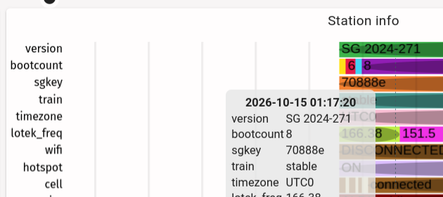

Yes but not without SG-ID… You can also look it up yourself on www.sensorgnome.net
Hi Denis/ Thorsten,
Oh, it IS on the SensorGnome page - I had somehow managed to miss that, despite many, many visits.
Thank you very much, that was exactly what I needed. :slightly_smiling_face:
