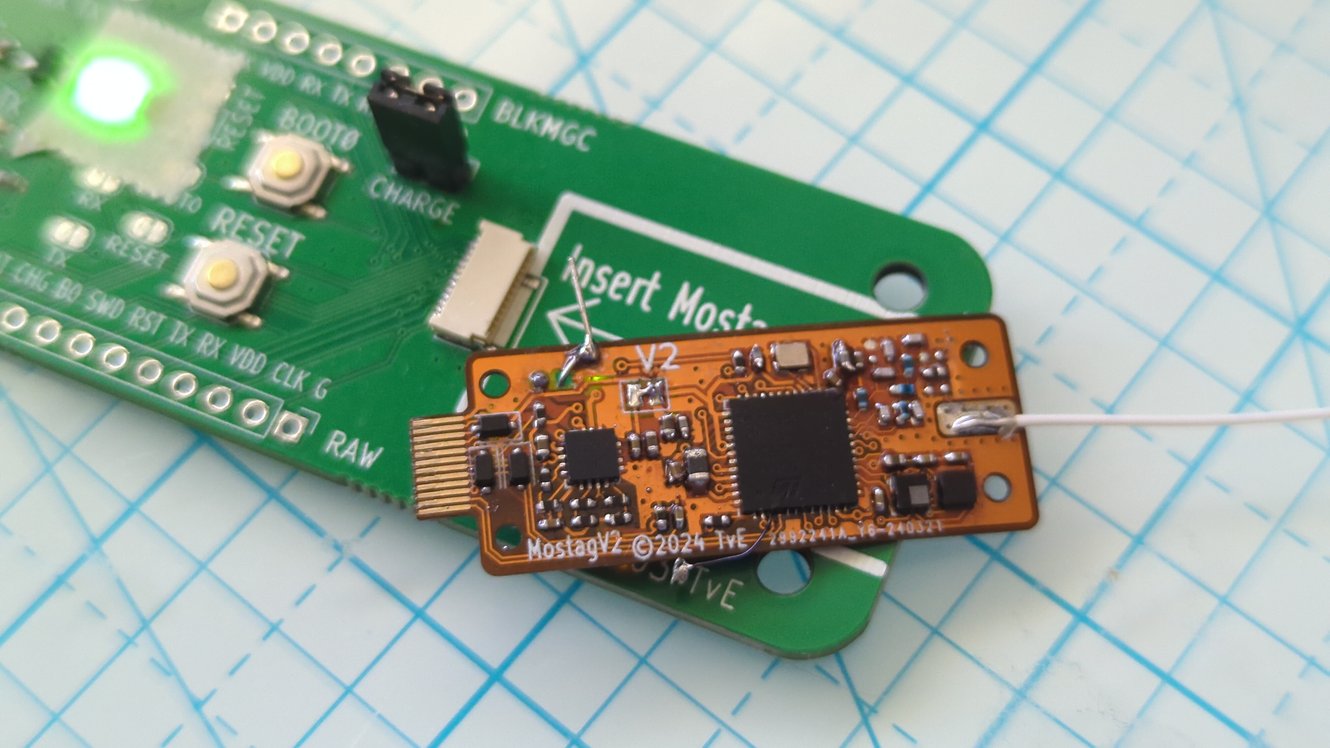

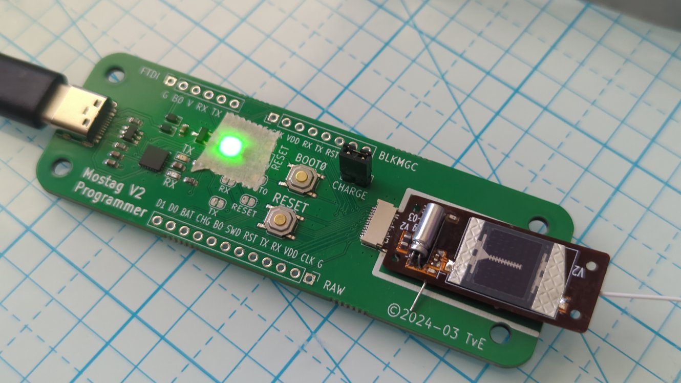

What I’ve done since march is to produce a small number of 1 gram tags that are fully Motus compatible (433Mhz) and have a pressure sensor as well as an accelerometer on-board. At each ‘beep’ the tags transmit their ID and the pressure reading, from which the flight altitude can be estimated. Here are two photos of a tag laying on top of a programmer board and inserted into the programmer:
