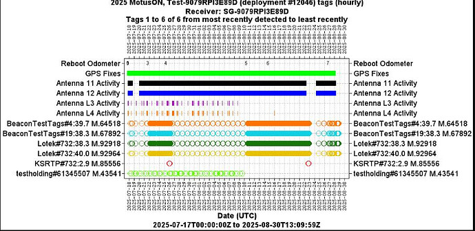

We recently put up several stations and since our 7-port USB hub does not seem to map ports similarly to the port mapping guide, one or several Funcube pro-s seem to end up in ports 11 or 12.
In Sensorgnome hub (we use software 2024-271) we see an error: eg. port 11 cannot be recorded (port number must be <=10). Motus website however allows us to map ports from 0 to 15 and the stations with port numbers 11 and 12 have gotten tag detections and seem to be working fine.
That rises the question of do we have to change the ports to <=10?
When trying to change the path manually, the typed in path gives an error that it’s not registered in Motus and second error is that port 11 is missing. Can anyone help with these questions?

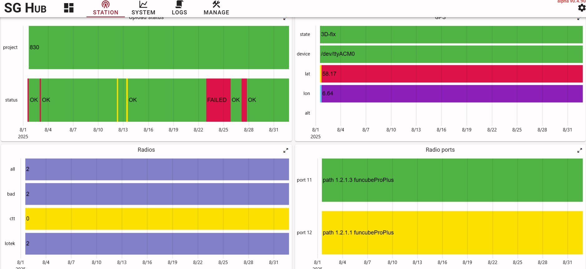

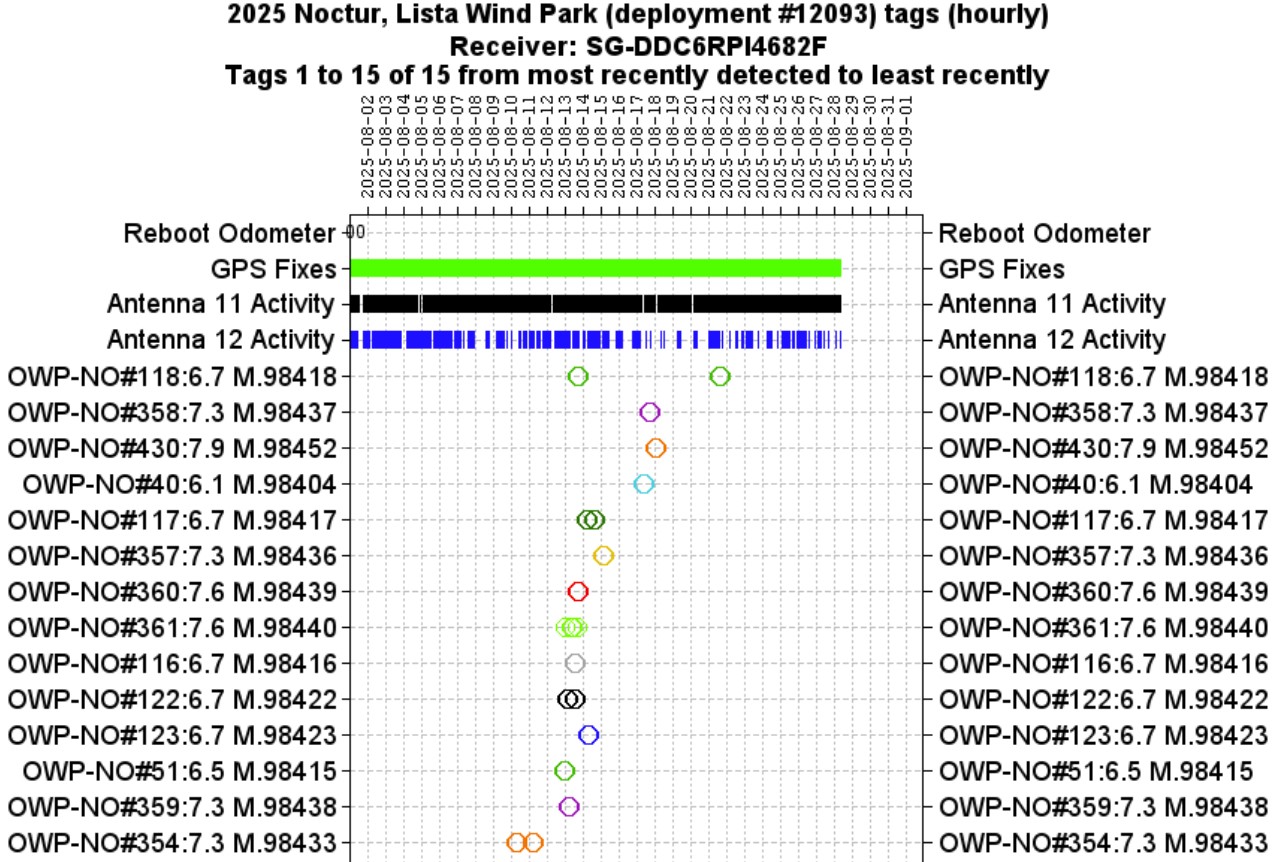

I’m a colleague of Maris’s also working with this issue. One of our stations appears to working correctly from what we can see on the Motus website and SG hub (Lista Wind Park; SG-DDC6RPI4682F, see attached images). This station also has had the most motus tag readings of any of our stations so far, so it appears to be reading tags okay. However, we continue to have the error message “port 11 and 12 cannot be recorded (port number must be <==10)”. Should we be concerned that there is an issue with our station or assume that it is working properly and ignore the error message?
A belated update to this: we made changes to the database and web interface to support data from port numbers 10-15. (Actually, the system will still process data even up to port 25, but you can’t associate an antenna with that number on the web interface).
However, though data will still be processed, the automated port mapping could be different after a reboot or power loss, meaning antenna auto-assigned 11 right now could become auto-assigned12 in the future. So if you have more than 1 antenna > 10 you’re better to map it to something to ensure consistency across reboots.
