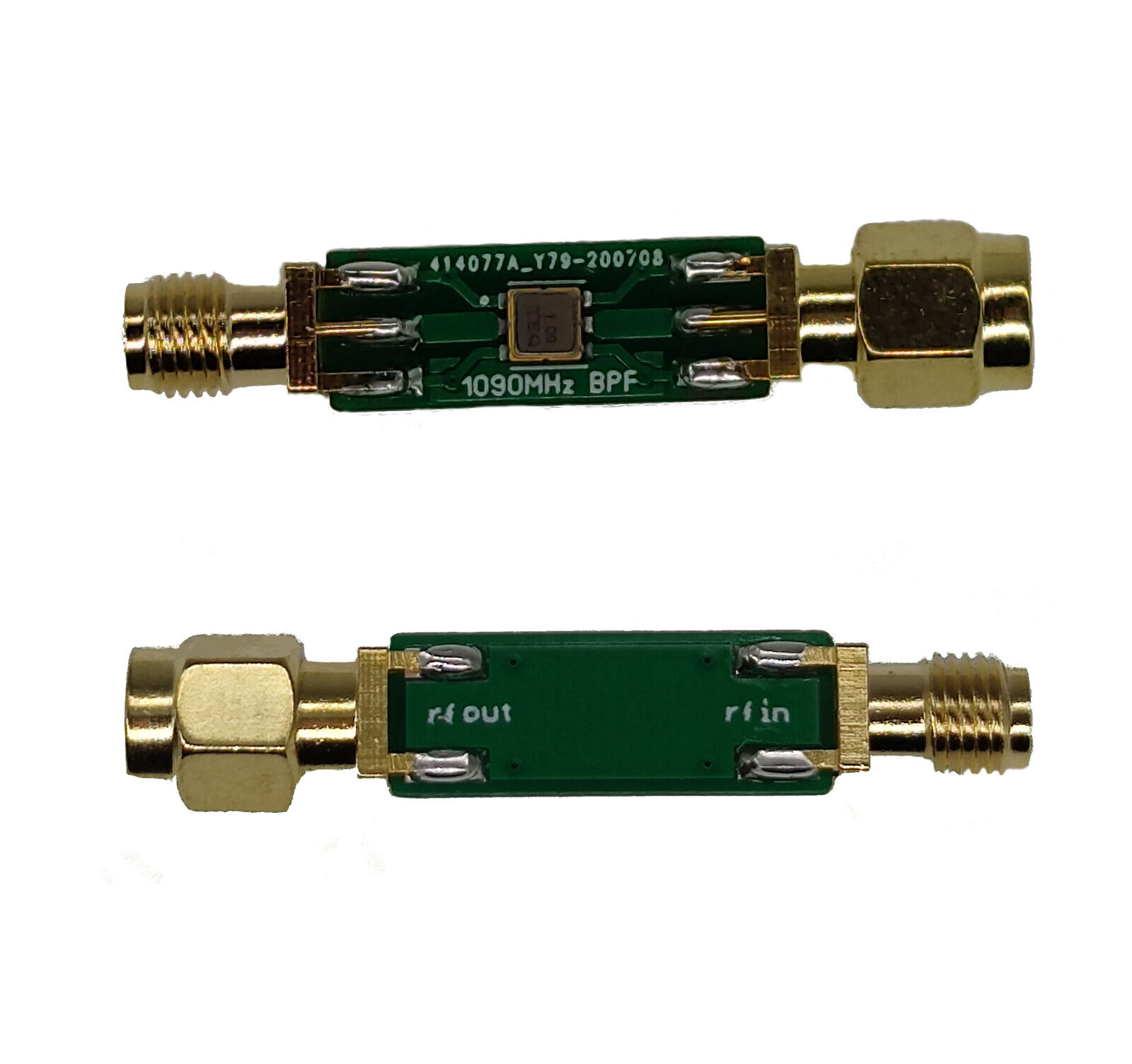

I’m not sure I’m interpreting your sentence correctly, but it’f you’re into antennas and such… I’ve added a couple of SAW filters to my Digikey shopping cart:
https://www.digikey.com/en/products/detail/tst/TA0168A/16907020
https://www.digikey.com/en/products/detail/rfmi/SF2170D/12178623
These are pretty narrow 8Mhz respectively 20Mhz filters around 166Mhz. They are just SMD components, so “some assembly required” onto a very simple PCB like
Dunno whether that’s up your alley and also dunno whether that ends up helping at all…
