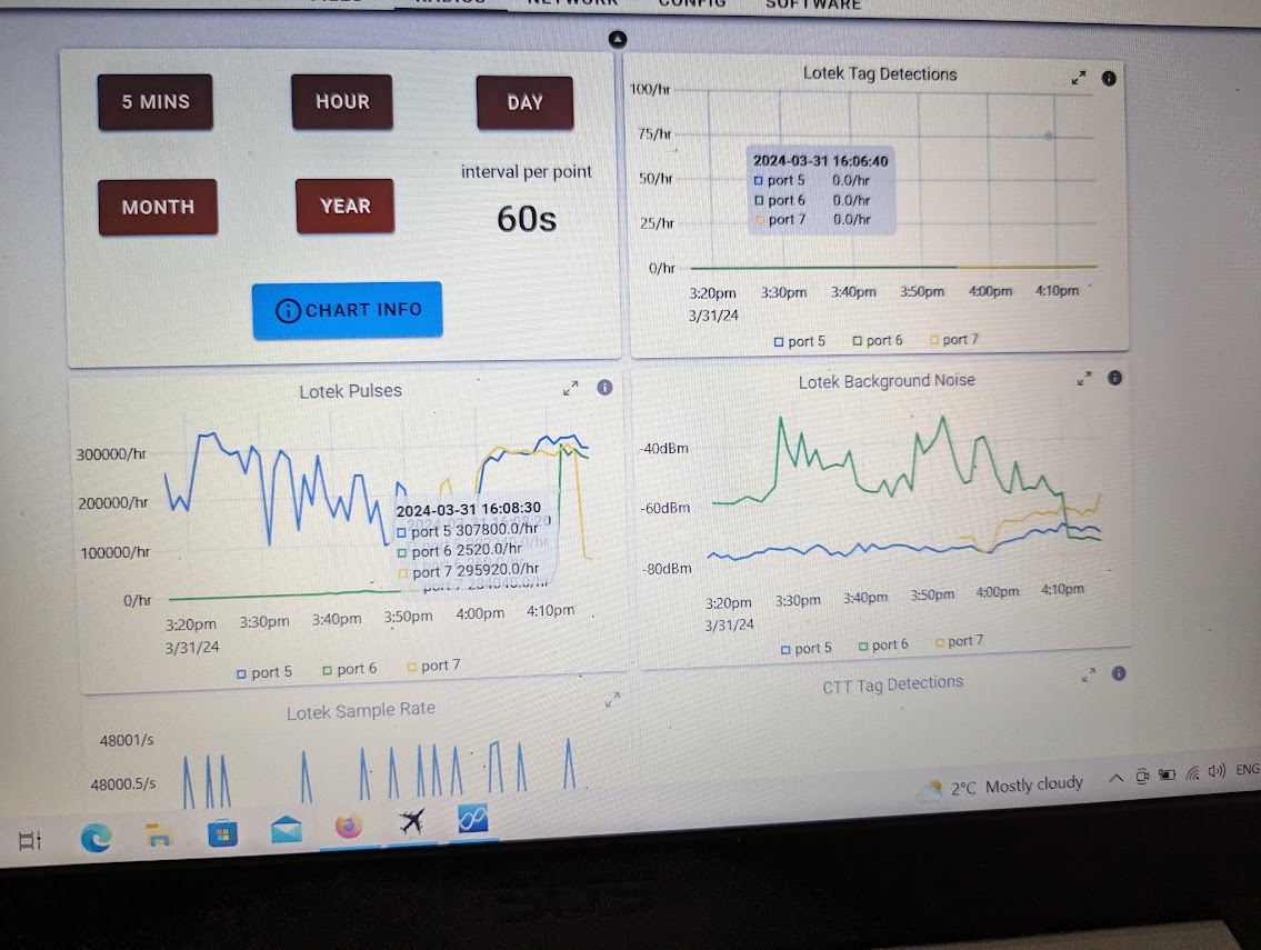

When I logged into the actual sensorgnome user interface (UI) (via the IP address on the SG Hub page for that sensorgnome), I saw no increase in the Lotek Tag Detections on the 5 min or Hour time length (or any other time length) the value stayed at zero. However, within 24 hours the test tags appeared as detections on the main Motus.org website for that station.

It would be very useful to see these detections real time on the UI.
Thanks for the feedback ;-) I just noticed that the help text available from the (i) icon in the Tag Detections chart doesn’t say that only tags described in the tag database uploaded to the SG are shown. The software cannot detect tags that are not in the DB. This is most likely the problem here (and I’ll fix the help text). Let me know if that’s not the issue.

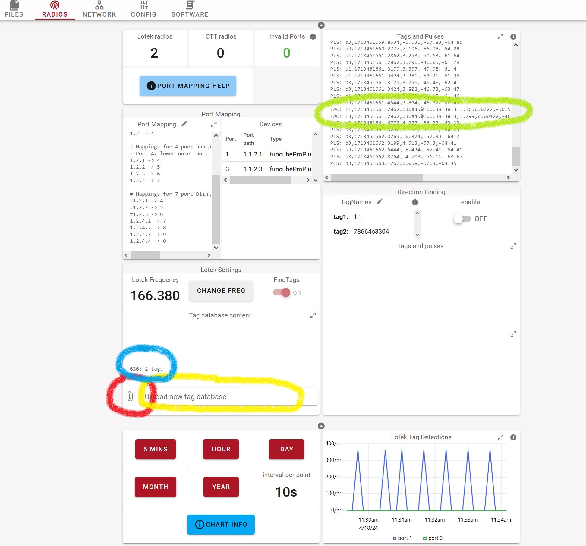

There is an upload button on the radios tab which accepts .csv and .sqlite files. The SG comes with a minimal sqlite file in /etc/sensorgnome.

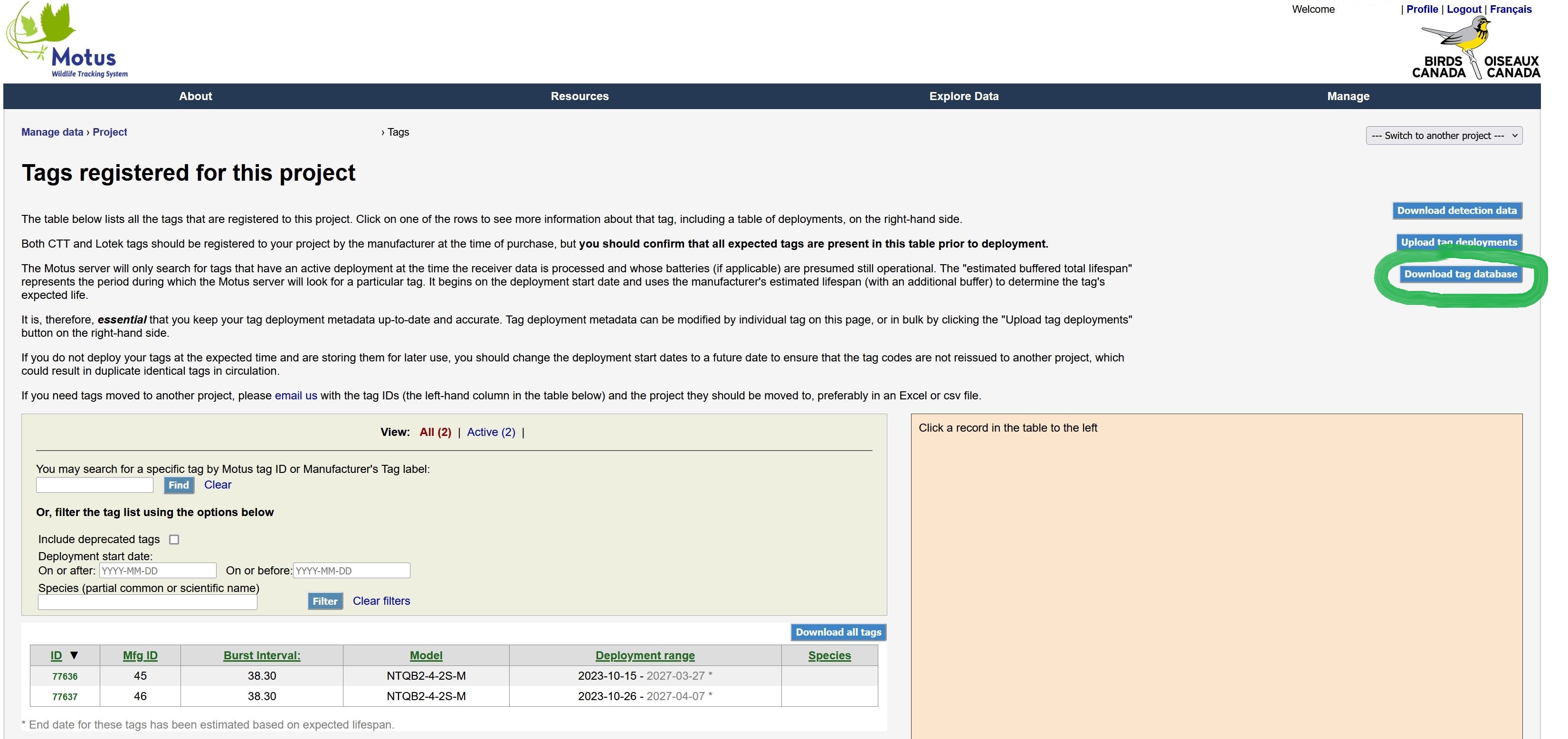

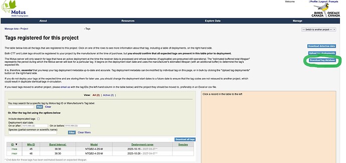

Hi Mark, you can download a sqlite database of all your project’s registered tags from your Manage Tags page. Just click “download tag database” on the right hand side. Then you can upload this to the SG.
Then Thorsten’s local UI has a wonderfully simple import system (better than a squirrelled away text input field and a button!).
just click the paper clip icon (in red)
this will open a file explorer
select the tag database you just downloaded
then click the “Upload new tag database” (in yellow)
That’s it. You’ll see the the text change in the blue circle.
Then you’ll see your tags in the “Tags and Pulses” section at whatever interval your tags transmit at (circled in lime green) and the “Lotek Tag Detections” graph will start to show detection values.
