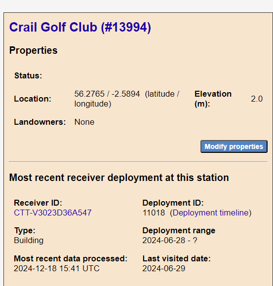

I have one that says it is sending data but is now >2 weeks delayed. I am not sure what it is about this particular receiver (CTT-V3023D36A547 - Receiver - Motus) as I know it is connected to wifi and the website says it is processing the data, yet when I download in R, I can only get up to 30th November.
Hi Lucy, this receiver appears to be up to date. I can’t access your CTT Portal (which you should check if you aren’t seeing up-to-date data on Motus for a SensorStation) but on your project page, everything looks fine here. Most recent data is up-to-date, and nothing looks amiss in the deployment timeline either.

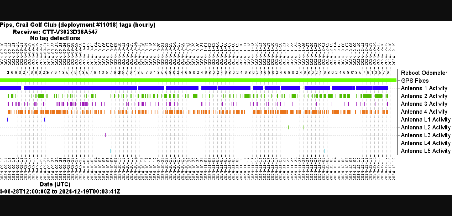

Going back to basics - was the tag you tested with registered?Antennas connections all OK? How many antenna attached to the SS?From trouble-shooting team:The receiver deployment plot shows activity (antenna noise but no detections in this case) up to the current date. It also shows the receiver has been rebooting at least daily since 2024-09-11. Looking at the raw pulse data from 2024-12-08 when they were doing testing, although I see an increase in pulses recorded compared to the previous day, there’s no sign of coherent tag bursts, just random-ish looking noise at around -64dB. There are no bursts detected by the tag finder because there aren’t any to be detected. So, I suspect there’s something wrong with the receiver or the test tag(s). Probably not the same issue as #1560, there were bursts visible in the pulse data for that. Download of data through R should have succeeded, just reported 0 detections. Is that what happened, or was there some other error?

So based on the information posted above, and as indicated by Stu as well, the receiver is regularly sending data and the “most recent data” date is up-to-date. The activity on the deployment timeline looks normal as well.
But there are no detections whatsoever on the Lotek frequencies, which are the only antennas you have connected based on the deployment record.
I had a look from the database side and though there are pulse counts in many of the uploaded batches (reflected by the coloured bars in the deployment timeline) there isn’t a single resolved hit in any of them. That seems strange considering you are testing a tag nearby.

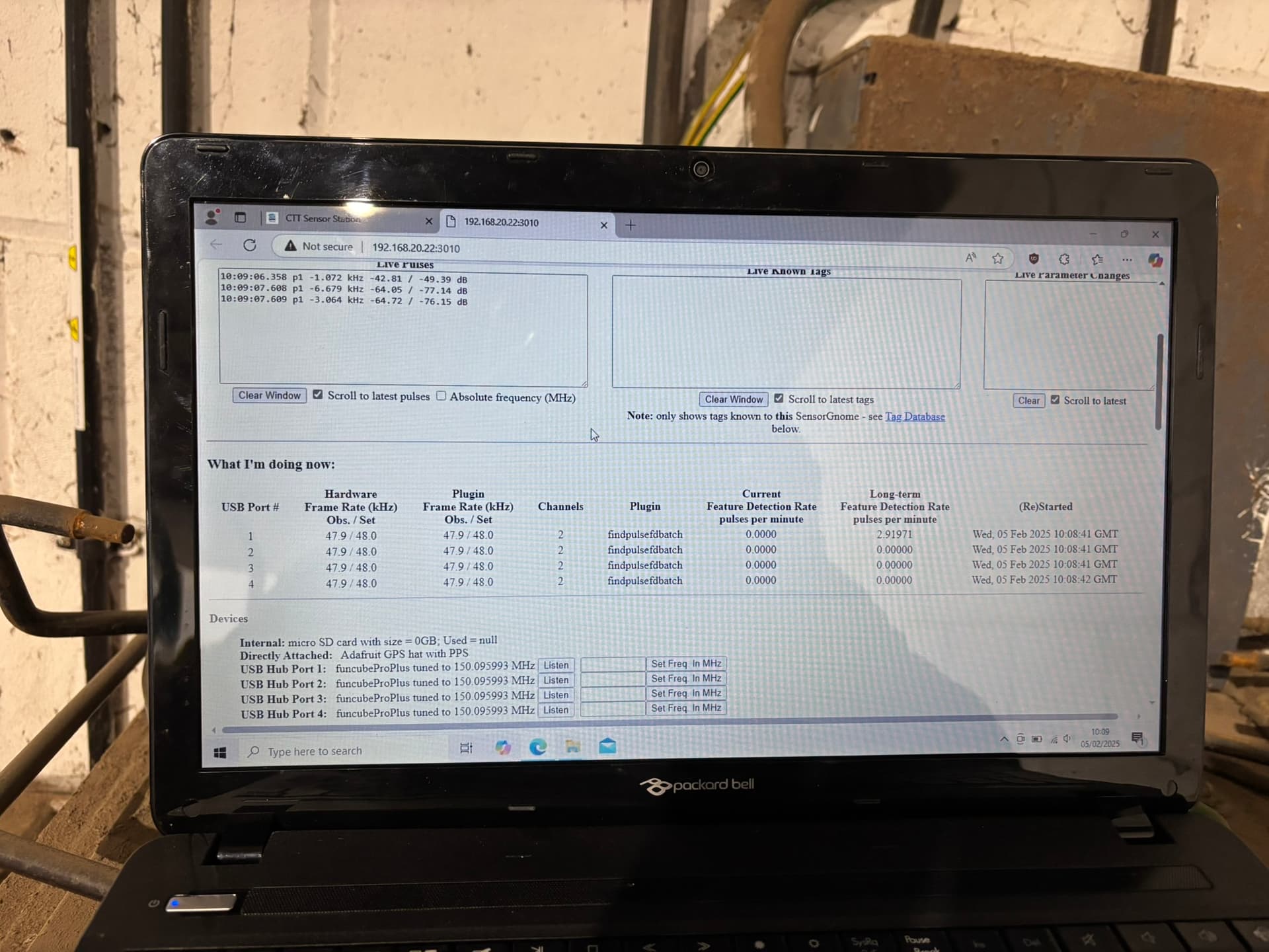

This actually looks a lot like this issue. The next time that someone is at this station, could they connect to the SS web interface and confirm that the FunCube frequency is set to 150.096 (150.1 minus 4 kHz). There is more information about the frequency setting here.
As for why you are seeing some data in R up to the 30th/31st, that has to do with the integrated 434 MHz CTT radios. Even though you don’t have any antennas connected to them, they can and will often pick up ambient noise. In fact you can see evidence of that noise on the deployment timeline above, where there are occasional blips on all 5 integrated 434 MHz radios (the ones with the “L” prefix). And occasionally that ambient noise will resolve to an actual CTT code. It’s not impossible to pick up real tags on the integrated radios without antennas attached, but considering all of these just have a run length of one (single hits) they are most likely false positives.

I downloaded the data from the CTT account page SOC Motus-CTT-V3023D36A547-000078-2025-02-24T09-24-27.7920P-all.txt.zip (41.7 KB) I see larger files over the last few days which matches with someone out with the test tag #23 from project 365. I’m waiting for it to be processed to download through R… I received this picture from the installer - dongles tuned correctly, and seemingly functioning (CTT page shows consistent functioning as well…)
There is a disconnect somewhere, and I can’t see where it could be now!
