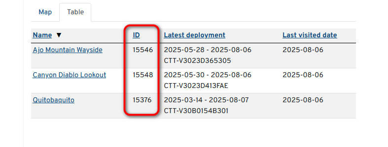

(For future reference, it’s actually the database ID that we need, not the receiver serial number. The nomenclature is admittedly somewhat confusing…)
Is there any way to keep the data from ID 15546 prior to this month associated with the Ajo Mountain Wayside location? On motus.org, the former data from Ajo Mountain Wayside now appear to be associated with El Pinacate, which is incorrect. The SensorStation moved to a new project, but can the previous data remain at the old (correct) location/project? The station was taken down in August, but reinstalled at El Pinacate this month.

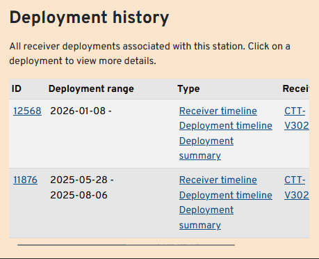

Station_id 15546 has been moved to project 357 as requested. That station used to be called “Ajo Mountain Wayside” based on the screenshot above but now it’s been renamed El Pinacate". But the station, and the two receiver deployments (12568 and 11876) remain the same.
What I’m guessing happened, based on this other post is that this receiver was deployed at Ajo Mountain from 2025-05-28 to 2025-08-06 then was physically moved to a different physical location for 2026-01-08. Is that correct or am I misunderstanding?
@jsrs that is correct– the station was physically moved from Ajo Mountain Wayside to El Pinacate.
Ok that makes sense then.
What you’ll want to do is create a new station for Ajo Mountain Wayside in the original project. Then add the receiver deployment 2025-05-28 to 2025-08-06 receiver deployment to it, and delete the one from station 15546. We’ll have to delete the old deployment from our end, but I think you’ll be able to create the deployment for the new station first.
