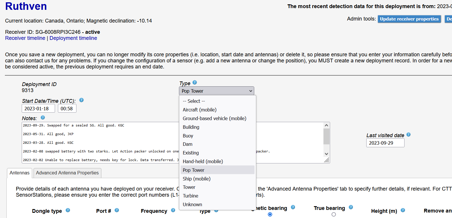

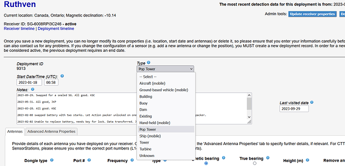

When it comes to your deployment metadata, there are a few “mobile” options, including for ship. You’ll have the opportunity to select these when you add a receiver deployment to your station. It’s at that point you can select a “mobile” option. I’ve attached a screenshot from a random Ontario station deployment as an example.
Josh
