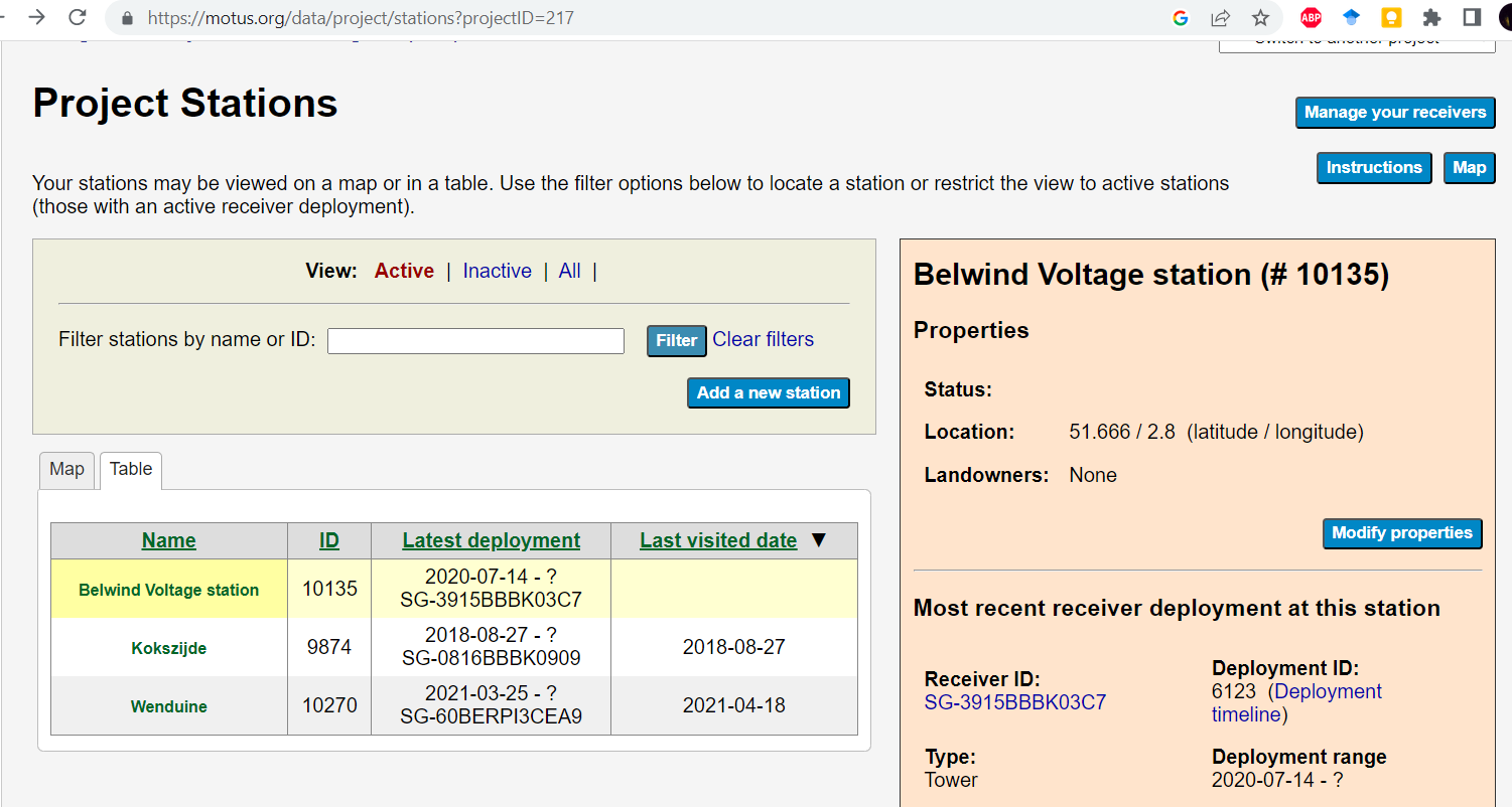

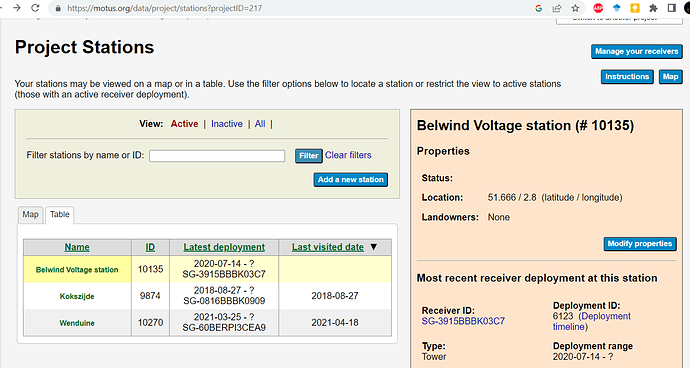

Hey Bart,
I am sure you are more familiar with all options To be sure: you are
aware of the option Deployment timeline in the Project station list?
See included screenshots below.
René

@rene yes I know these screens, a list with ALL the active receivers and the last upload date. It would give a one second view of all our receivers.
Bart

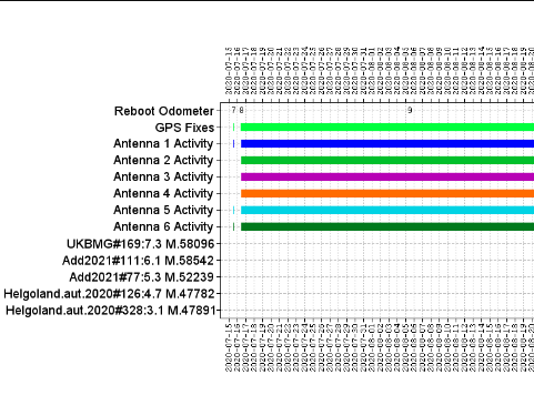

Hi René,
It would be useful to know if receivers that are deployed are actually operational ("active"), and the second plot you showed seems to get at this with the GPS fixes and antenna activity logs.
I've seen these plots before but not how to construct them or where to find them. Can these data be accessed in the Motus database for any receiver we are interested in?
Thanks!!
Yolanda

Hi Yolanda,
You can get the plots by entering this url: https://motus.org/data/receiver/deployment/plot?id=XXXX where you can notate the deployment ID of deployment on the four X
What I'm looking for is an overview of ALL active receivers in one list stating last upload date: A bit like the old sensorgnome page (but that is outdated and shows all receivers for all projects) https://sensorgnome.org/status/
Bart
