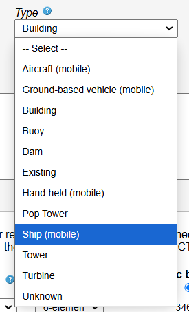

Hi Michael, you got it. The “mobile” status is set at the deployment level. So you’ll create your station, then when you create a deployment to add your receiver to it, you’ll see an option to select type. Ground-based vehicle is what you want.
Note that the main thing this does is bypass some of the location based data validation and alerts in your Data Issues page that normally would be triggered if a particular station moved so much. And of course, it reminds the operator (and others, if their tag happens to be detected by it) that thing is actually moving!
Would a station on a marine vessel also be a ground-based vehicle? It probably doesn’t matter that much, but for offshore vessel-based Motus stations, it seems a bit funny to classify them as ground-based.
There is a “ship” option which should work in these cases.
