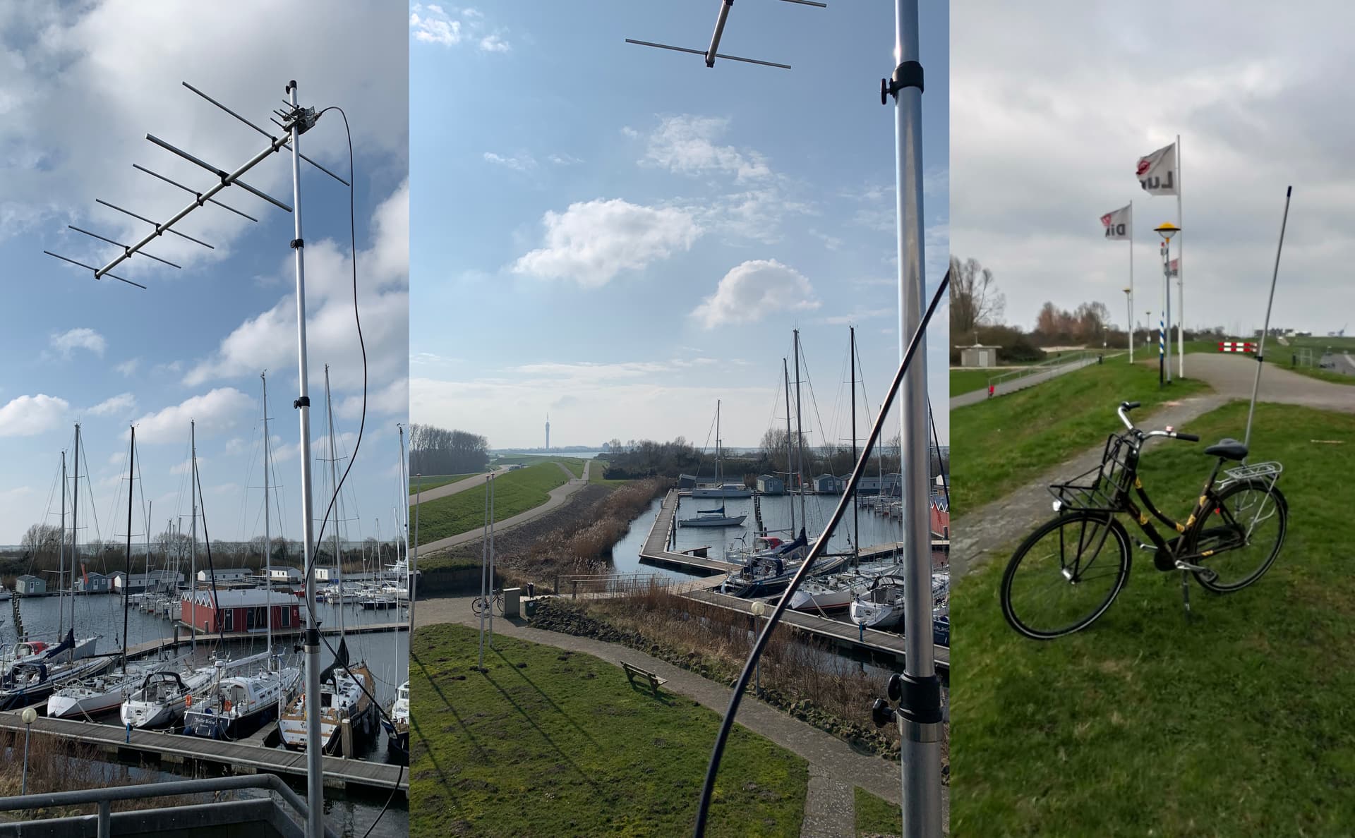

We have a project that will involve setting up Motus stations for the detection of Nathusius’s pipistrelle bats. Due to the small mass of these bats, in terms of tags, we are limited to Lotek nanotags. In particular, the tags that I’ve been testing are the NTQB2-2-M nanotags (0.32g, 150.1MHz, burst interval 7.1 seconds).
The Motus stations we plan to install will need a detection range of at least 2km (and preferably more) to get full coverage of the area we want to monitor. I’ve been trying to optimise a testing setup to get as large a detection range as possible. I’ll go into a lot of detail here; you can skip ahead to the bold part below for a summary of the questions I have. The testing setup is as follows:
  • A 5-element (Laird Y1505) or 6-element (Sirio WY 140-6N ) Yagi antenna. The Laird Y1505 is gamma matched as per the instruction manual. I’ve mostly been using one antenna at a time for measuring. The antenna is attached to a telescopic metal pole, which in turn is attached to a fire escape. This gives the antenna a height of ~9m above the ground, and ~2m above the metal railing of the fire escape.
  • The nanotag is attached to the end of a metal pole, which is attached to a bicycle, putting the tag ~2.5m above the ground. The bicycle is then cycled up to the dike, where I can continue cycling on top of the dike for a few kilometres while keeping line of sight to the antenna.
Antenna output has been analysed using a SensorGnome, a SensorStation, and a Lotek SRX1200. For the SensorGnome/Station, the SDR used was a FunCube dongle pro+. I’ve also looked at raw radio signal from the FunCube using SDRsharp.
During an initial test, the tag could be detected in the raw signal up to a distance of ~1300m, where the signal is barely above the noise level. Of course, this doesn’t mean that any software would also detect the tag, so we tested it with the SRX1200. With the antenna gain set to 71 (as high as it’d go without pelting us with a flurry of false detections) we were able to detect the tag up to a range of ~1100m. We didn’t have the SensorStation at this point, so we unfortunately couldn’t test it yet with these same conditions.
The SensorStation arrived last week, and I’ve been busy trying to at least replicate the 1100m result with it… but to no avail. Over the last few days, my testing has become extremely inconsistent, and I simply cannot figure out why. Using the same setup as before, I’ve gotten a detection range of ~700m with both the SRX1200 and the SensorStation… once. With that same setup, and the pole holding the tag attached to a sign at ~600m, two out of three times the tag was simply undetectable. I checked the raw radio signal as well, and it didn’t show up there either, so the problem must’ve been the tag itself. Other times, I could clearly still see the radio signal (quite a bit stronger than the 1300m case earlier), and the software still wouldn’t detect the tag.
I’ve been trying to tinker with the SensorStation settings in the deployment.txt file, but it seems like the important ones are completely undocumented (regarding a lot of SDR gain/filter settings).

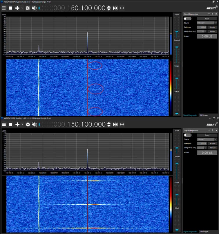

You may want to consider modifying your attachment so you do not place metal next to the tag where it can influence the antenna. The recommended set-up is to use a non-conductive pole (e.g. wood, PVC, fiberglass) and to attach the tag to something that simulates the animal body. The reason is that the antenna needs a counterpoise to radiate effectively. The two “popular” methods are a piece of hotdog or a small plastic flask/bottle filled with a sponge and saline solution. Both should be sized/filled to weigh about the same as the target animal. Then attach the tag to that with the antenna pointing in the expected direction, for example, horizontally to simulate a bird in flight.
Those are pretty cool screen shots! I have not been able to capture the signals with SDRsharp, they go by too fast for me. The only app that has worked for me is SDRangel, which has an “interesting” UI… But if SDRsharp works for you all the better!
I have been primarily working with RTL-SDRs, see the thread on RTL-SDR vs. FUNcube, but I may be able to help a little. On Sensorgnome V2 the file that controls some of the SDR detail settings is /etc/sensorgnome/acquisition.json, on SSv3 it lives at /data/sg_files/deployment.txt. In that file there are “plans” for rtl-sdr, funcubePro, and funcubeProPlus. Be sure to edit the plan that pertains to the SDR you’re using (e.g., "devType": "funcubeProPlus"). After editing, you need to restart the main process, on SSv3 that would be sudo systemctl restart sensorgnome and on SGv2 that would be sudo systemctl restart sg-control.
In terms of changing the devParams, I have only experience tweaking the ones for RTL-SDR. You mention the tuner_gain: that this setting is for RTL-SDR and not FCD. The FCD plan has gains for various stages and not being intimately familiar with FCDs I can’t comment on the default settings. The filter settings control the frequency band filters that the FCD can switch in/out and these are extremely unlikely to be wrong.
In terms of detection sensitivity: a Lotek tag emits bursts of 4 short (2.5ms) RF pulses with a spacing of up to ~100ms which encodes part of the tag ID, and these bursts are repeated every few seconds (7.1 in your case). Each pulse needs to rise at least 6dB above the surrounding noise (that’s the minsnr setting), where surrounding is ~20kHz in frequency and some ms in time (I don’t know the value). You will see the raw pulses in the Web UI (the SGv2 UI shows SNR, which I find very helpful in this context). In order to show a tag detection in the Web UI two things need to happen: you need to have uploaded the tag definition to the SS/SG and it needs to see at least two pulse bursts with the correct burst interval (it accepts 2x the interval as well).

On the topic of what to attach the tag to:
We’ve heard before that it’s best to attach a tag to a dead animal of whatever species you’re interested in. The biomass would increase the signal strength emitted by the tag+animal combination compared to just the tag by itself. For want of dead bats, we did try a few other “biomass” objects, such as a damp sponge, and we’ve tried wrapping the tag in leaves as well. In a “from the office” test with the antenna on my desk and the tag attached to the wall (2m or so between the two), the leaves in particular seemed to improve the signal a lot. For longer distances, however, we didn’t get any improvements by putting the leaf-wrapped tag on a pole. If the tag needs a ground to function properly, I’d personally have expected the pole-bicycle setup to have acted as one. I have noted that pinching the tag between my fingers does significantly increase the signal strength.
The metal pole is a bit baffling to me as well. You’d expect it to mess with the signal emitted by the tag and to cause all sorts of interferences, but so far, it’s given us the best results. I’ve tried attaching the tag to both a wooden pole and a plastic tube, and in both cases, the signal only got worse.
In all cases, I’ve had the tag attached in a vertical configuration, and the yagi’s polarisation plane has been vertical. I’ve read that this maximises the signal strength. From a physics perspective it doesn’t make the most sense to me for the yagi elements to be perpendicular to the electric field from the tag - how would this field induce standing waves in the elements - so it makes sense to test out the horizontal configuration as well.

We’ve been able to get a detection range of ~700m with a 5-element Laird and a SensorStation & FCD combo. The antenna is at ~4m and is not surrounded by any structures, just a dike and water. The tag was taped to a wooden pole, and that wooden pole was taped to a longer metal pole for additional height.
Since other tests were (still) giving inconsistent and plainly bad results, we’ve bought an antenna analyser. The antenna as it was when we got 700m had a VSWR of 1.7. We’ve adjusted the gamma match that comes with Laird antennas to where the VSWR reads ~1.18. With this adjustment, using the exact same setup as earlier, we got… 200m.
The antenna can’t be the cause of issues at this point, so I’m looking in other directions. Any information about the following would be great:

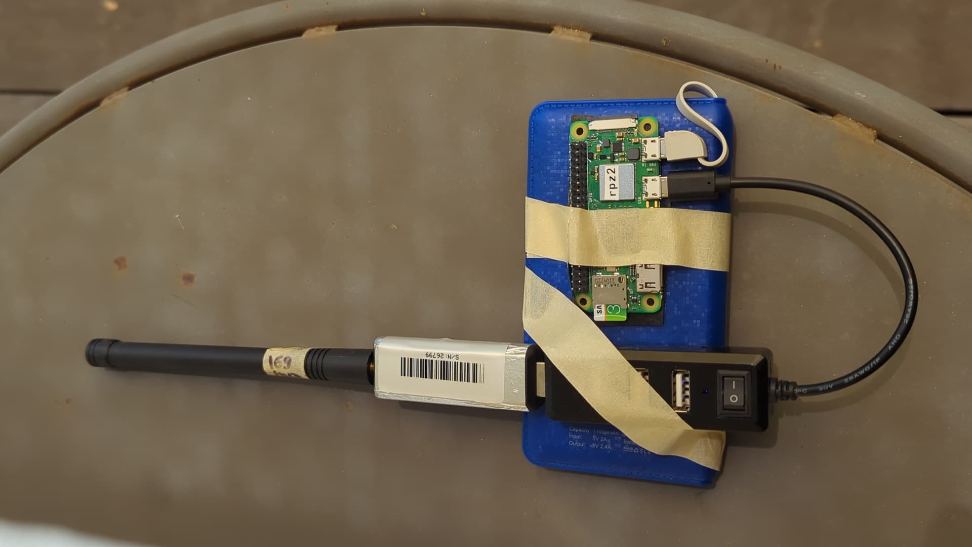

Since I gave so much “do this and that” advice I thought I’d try some of it myself :blush:

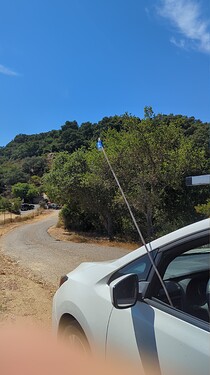

So I grabbed an rPi Zero-2W, and FCD, and a small 169Mhz antenna, which is broad enough to work reasonably at 166.38. Then artistically strapped that to a LiPO pack:
Since I was doing this alone I decided to do it the other way around from what I suggested and I placed the tag somewhere and then walked around with the Sensorgnome and my phone talking to the SG’s hotspot.

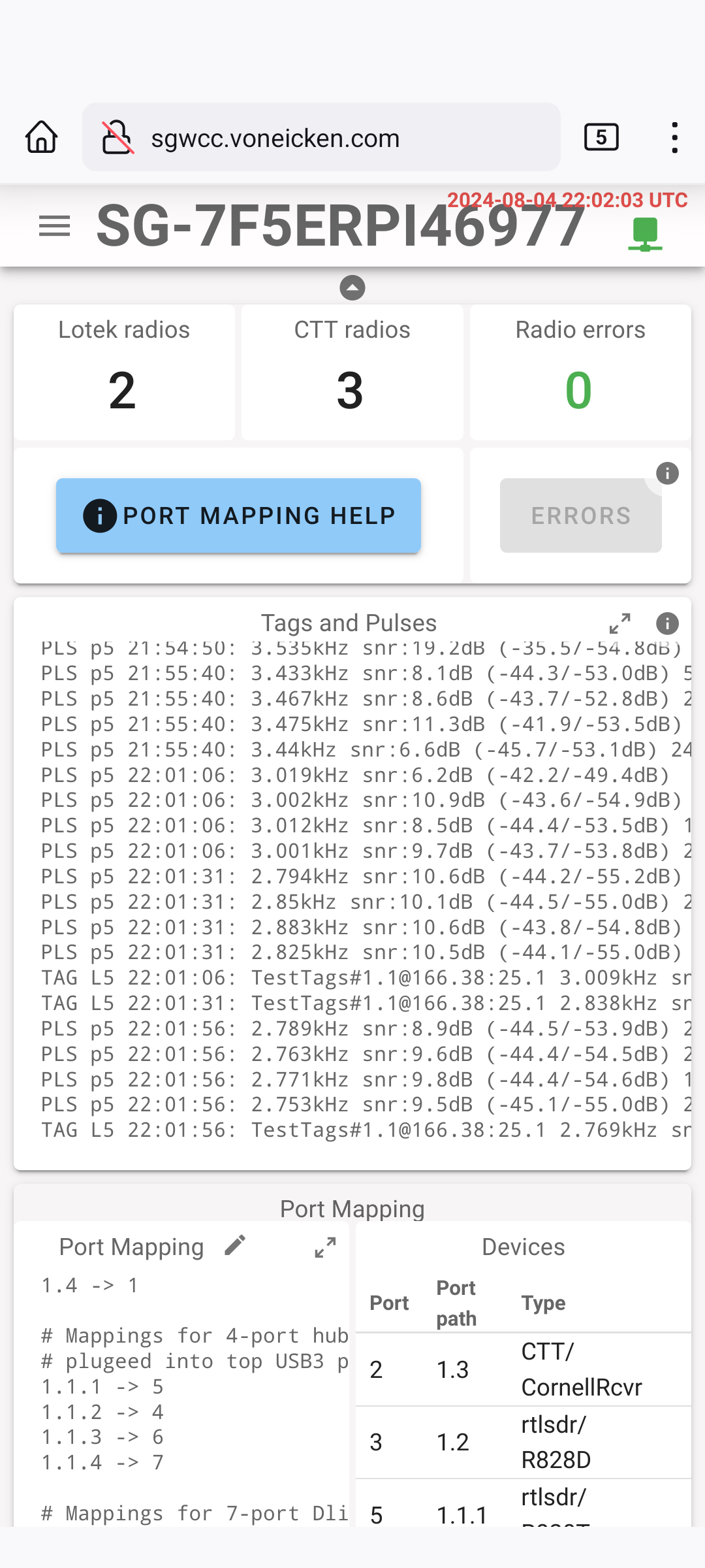

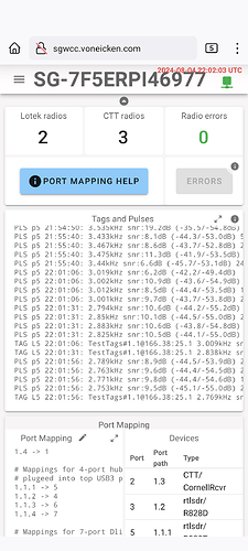

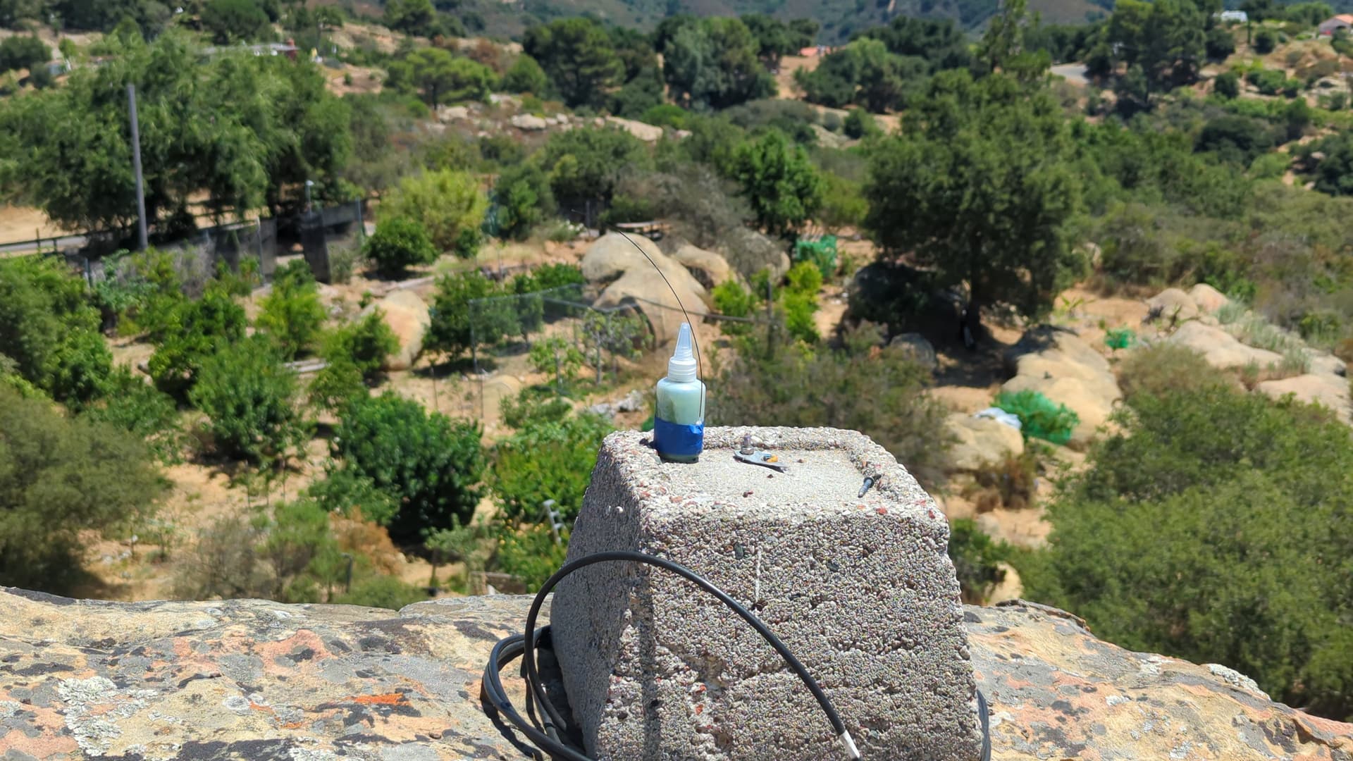

Here goes the tag, taped to a little bottle with a sponge holding saline solution, about 34g total weight:
I first had the SG laying on the rock about 1m from the tag and saw:
SNR: 25dB, sig/noise:-21/-46dB
I then walked climbed about 10m away, held the SG up above my head and looked at my phone and recorded:
SNR: 8dB, sig/noise:-28/-37dB
I didn’t like that SNR but notice how the issue was more the noise level rising.
Then at 30m, 40m and at 70m:
SNR: 7dB sig/noise:-30/-38dB
SNR: 9dB sig/noise:-28/-38dB
SNR: 6-7dB sig/noise:-33/-41dB
At 70m the tag was not always recognized. This is what it looked like from 70m, the tag is on top of that big rock up there:

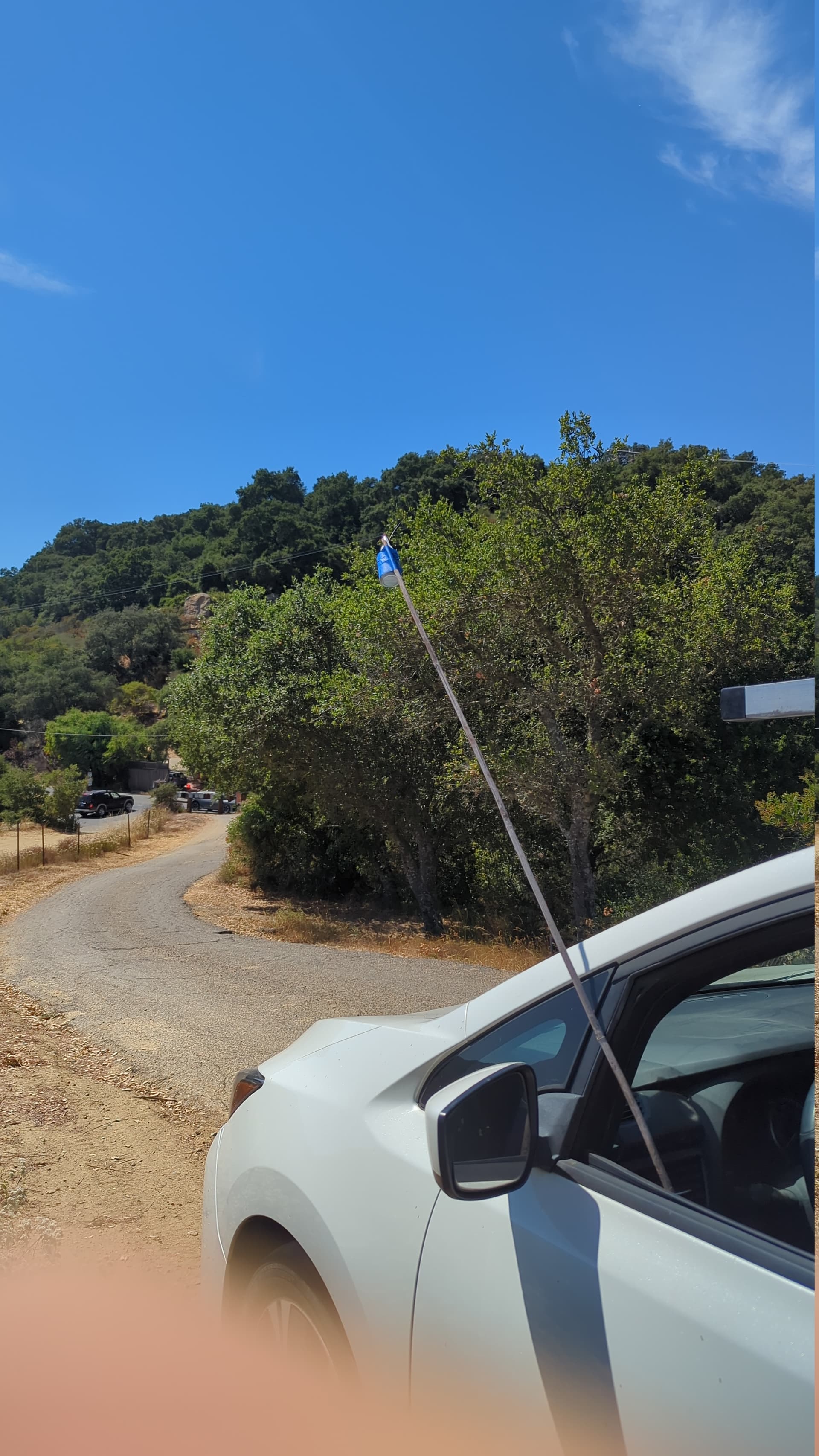

I then tried to get a couple of long range detections using the 9-element Yagis I have on the tower. The first test was at a distance of 455m nicely in-line with one of the yagis. The result was:
SNR: 9-10dB sig/noise:-44/-55dB
This is the view and the tag:
I then tried a longer distance, about 5km and that didn’t work. It’s about 30 degrees off from the other Yagi at my station. I will reorient the antenna a bit and do some more tests (then I can also test some intermediate distances, which is difficult here in the mountains…).
So my test got further than your 200m :roll_eyes: but 5km a bit off-axis was a no-go.

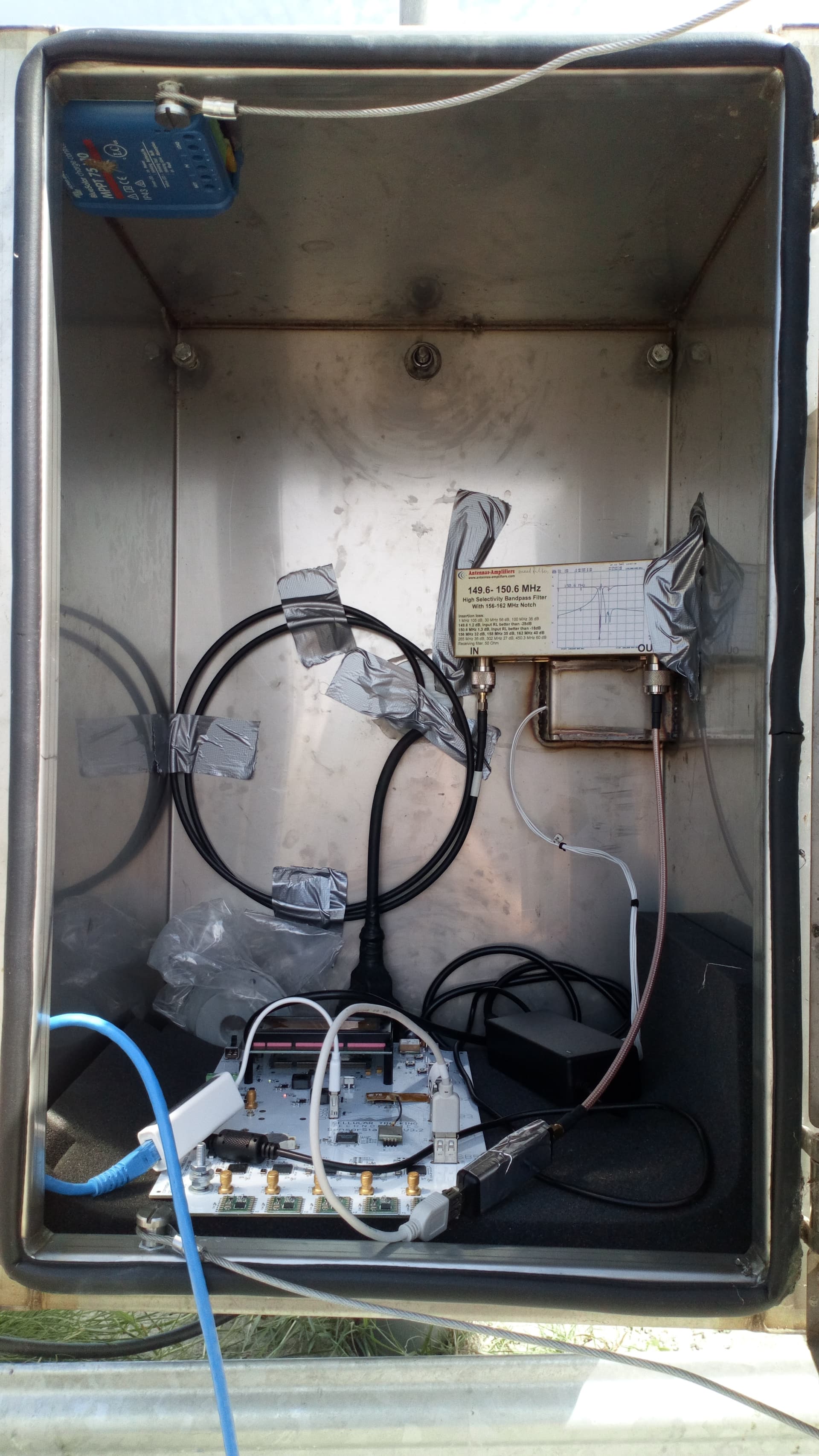

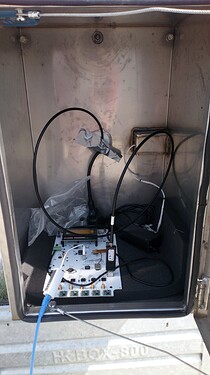

So possibly the coax cable connection has been the culprit with regard to the inconsistencies we’ve experienced. That’d make sense, since every time you build the setup, the connection is going to be different if you don’t pay attention to possible tensions in the cable. I think we’ve tried in the past to make sure the cables weren’t being strained, but we didn’t notice any difference at that point.
With the cable as in the picture (we’ll have to think of something going forward, so it’s a temporary solution for now) I got:
  • -35dB to -36dB signal with -64dB to -65dB noise @100m
  • -43dB to -44dB signal with -67dB to -68dB noise @200m
Which is a 6dB drop in SNR for a doubling of distance. Tomorrow we’ll test how far this gets us - if it keeps dropping by 6dB every time, we should be able to get to ~1600m.
With regards to possible coax straining problems: has anyone else experienced anything of the sort, i.e. a ~8dB increase in noise just from the coax being in a certain configuration? I know coax cable can be rather sensitive to strain, but I wasn’t expecting an effect to be quite as strong.
Glad you’re finding something! Your cable is broken. This is not about moving the coax and it being sensitive. Most likely the connector crimp has failed, possibly the center conductor is broken. RF signals are wild and don’t mind jumping a tiny crack … with attenuation depending on the crack dimensions. If you re-crimp the connector or replace the cable I expect you’ll be fine.
WRT the 6dB: you should loose 6dB when doubling distance, but that’s the theory, measurements vary… Your measurements show a bit more than 6dB going from 100m to 200m, which can be due to a variety of factors. SNR (as the name implies) also depends on noise, which shouldn’t change for a given fixed installation but does change with location and antenna orientation.
For example, at 1km the radius of the fresnel zone is 13m so antenna height and animal flying altitude start to matter. Fresnel Zone Calculator - everything RF

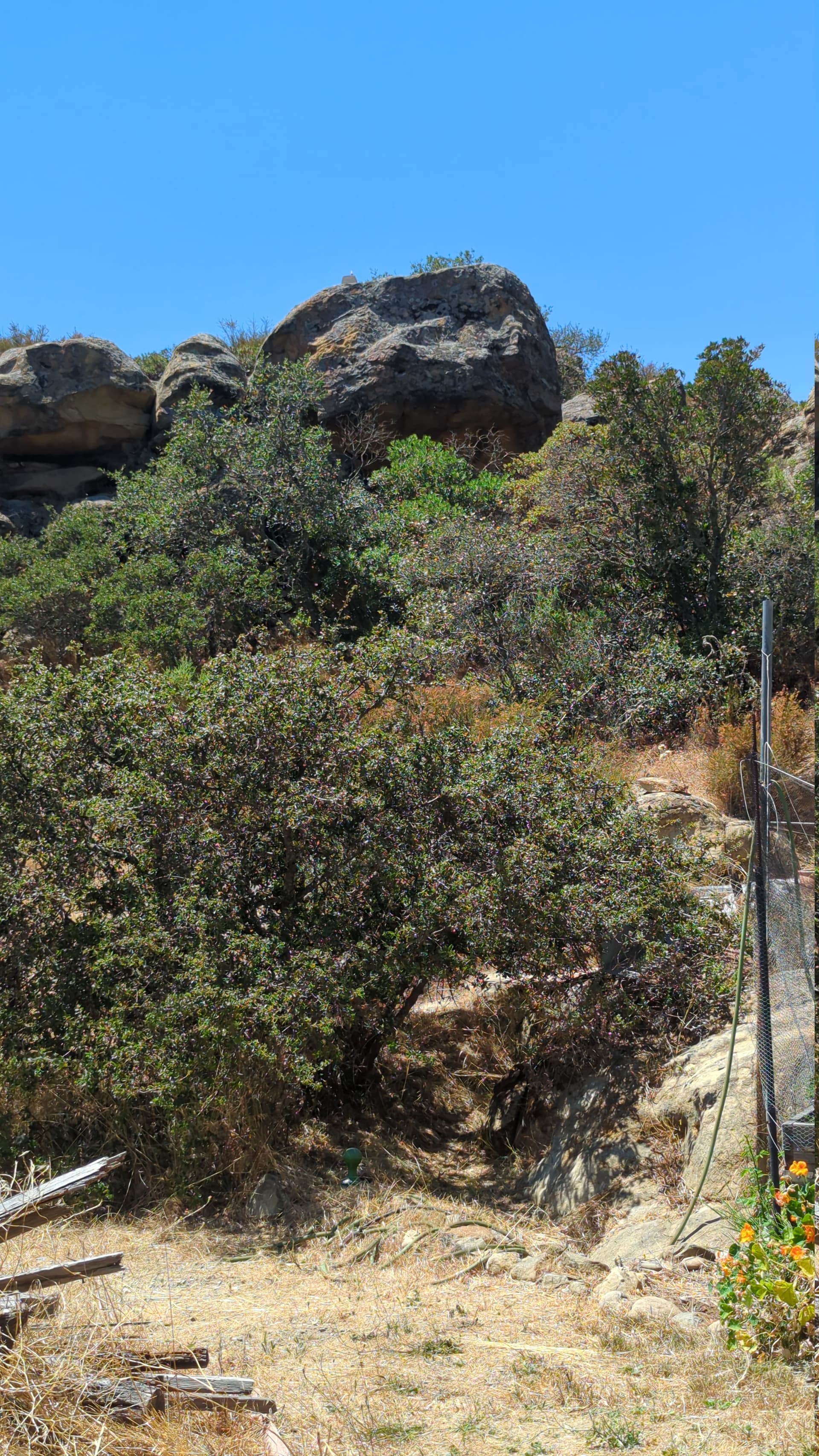

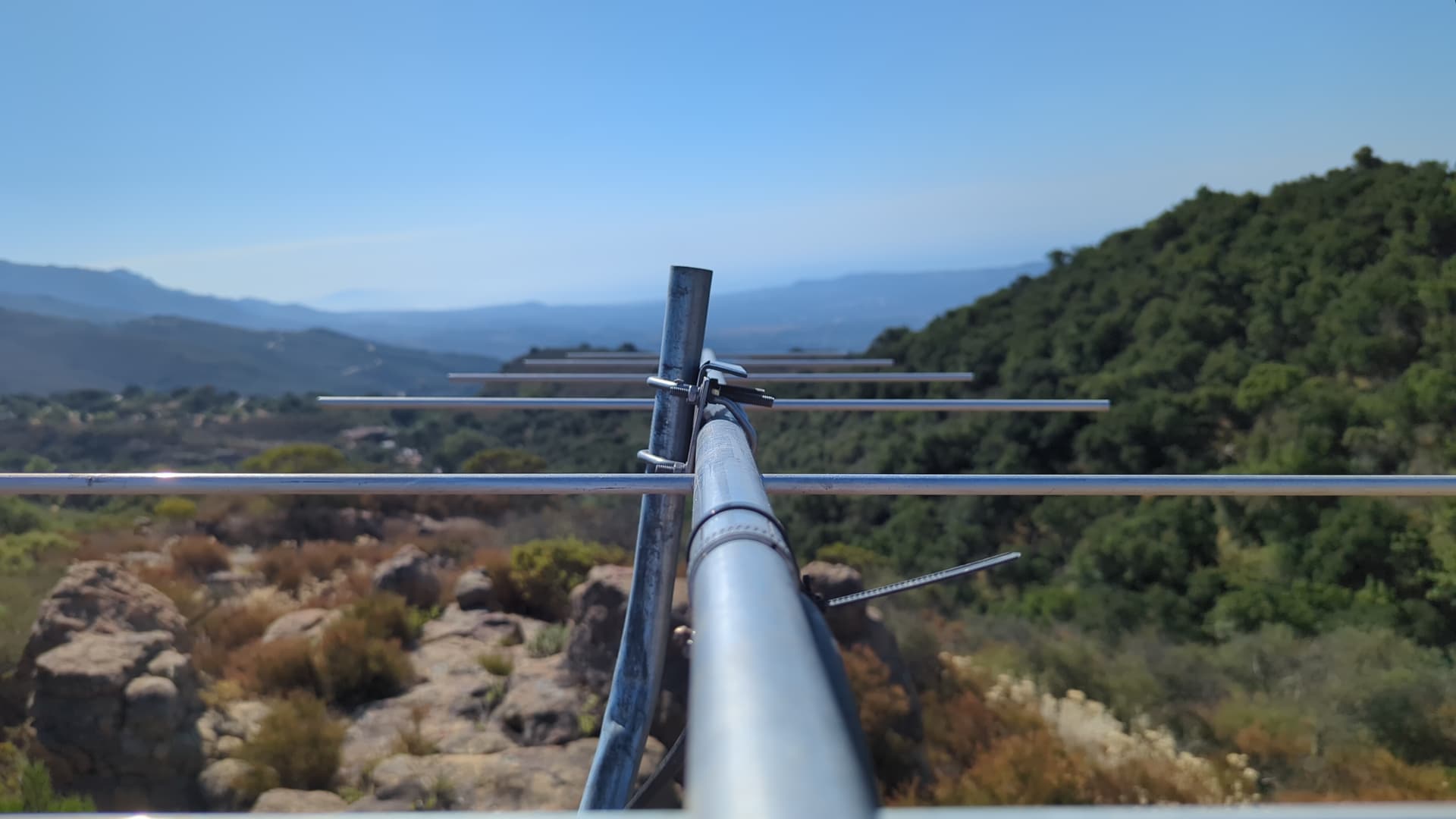

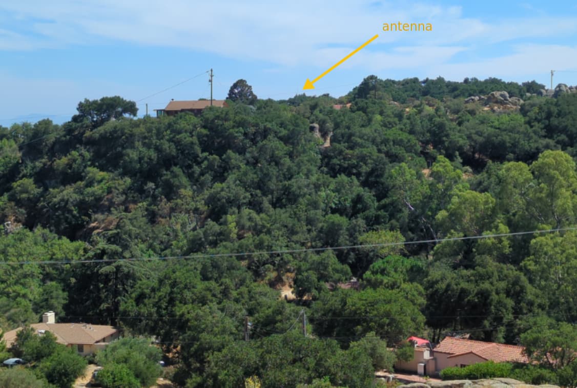

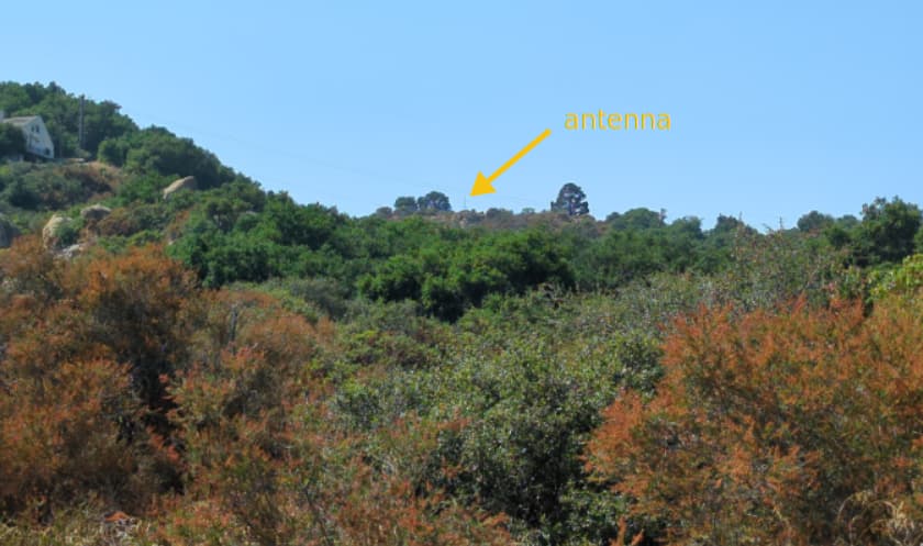

I’ve continued doing some tests. First I reoriented one of the 9-el yagis on my station to point more into the terrain a few km away.
Then I placed my test tag on a boulder on that ridge coming down from the right in the photo. The view back:
The distance is 570m and the FCD is barely picking up the tag with an SNR just above 6dB. Sometimes it only sees 3 out of the 4 pulses:

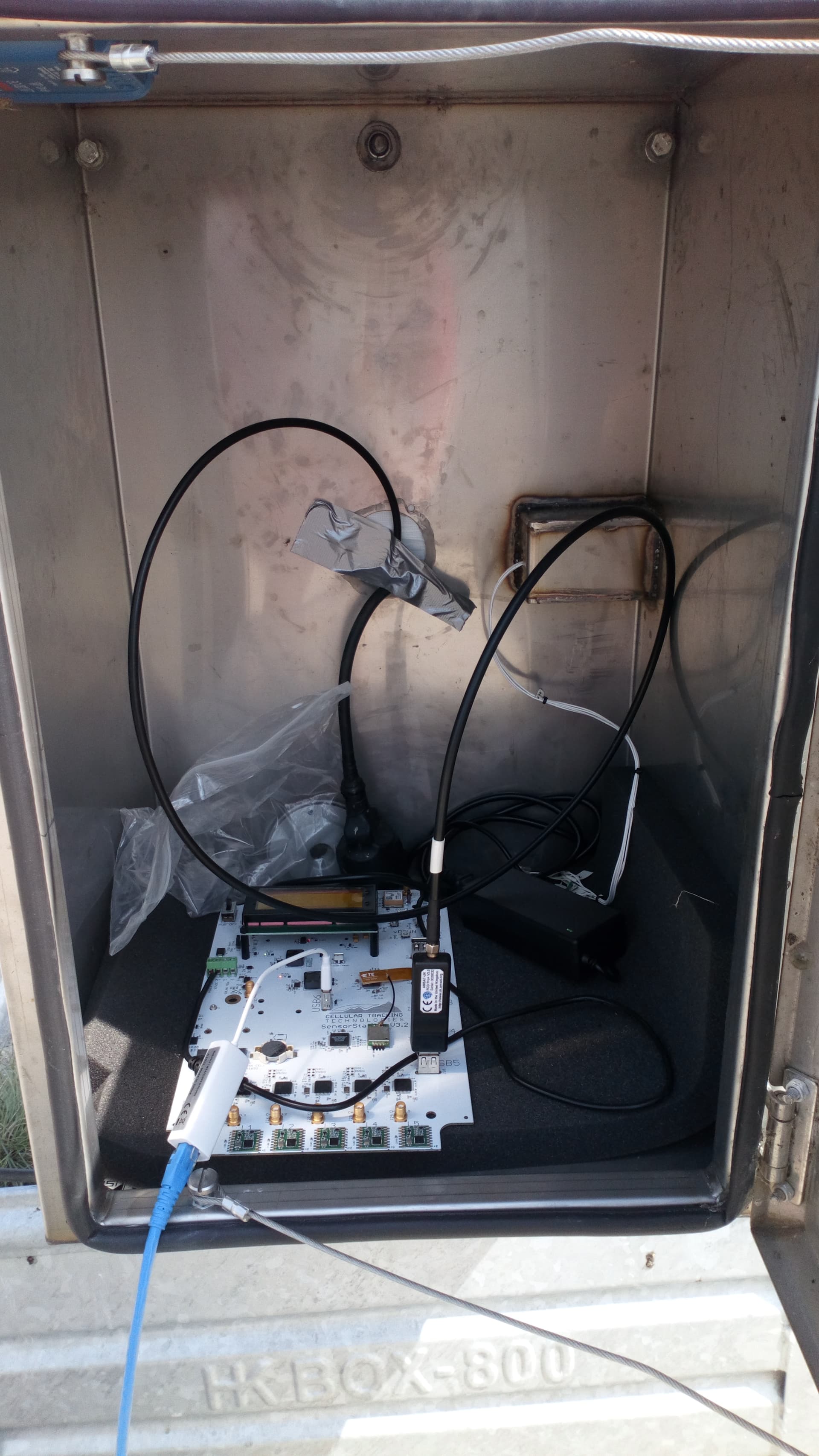

Hi Thorsten,
Tuesday I did some more testing, still with the same coax cable (which you suspect might be broken). After taping the coax cable to the back of the steel box, the signal got quite a bit better. There’s also a 149.6 - 150.6 MHz bandpass filter between the antenna and the FCD now.
This way, we got:
  • -34 to -36 dB signal with -67 to -68 dB noise at 100m
  • -45 to -46 dB signal with -73 to -75 dB noise at 200m
  • -67.5 to -68.5 dB signal with -75.5 to -76 dB noise at 800m
  • Occasional singular live pulses at 900m, but no tag detections at that distance.
Detaching the coax from the back of the wall can increase noise by ~8dB or so, but firmly taping it to the wall seems to consistently optimise signal strength for the time being. We’ll have to take down the mast and replace the coax to see if it’s truly broken. There are likely more optimisations that can be done in terms of cable/electronics management, so we’ll be trying some other things soon as well. Suggestions are welcome!
Problem with the filter is that it adds noise and thereby reduces range. Anything in the signal path adds noise. If you don’t have an intermod problem then the filter only hurts. The device I use is an LNA plus filter, the LNA has a lower noise figure than the rtl-sdr front-end and the gain compensates for the losses and noise added by the filter. It’s not without downsides either but it can actually reduce noise.
Your coax looks pretty thin… Something else you could perhaps try is to get a 3m USB cable and attach the FCD directly to the antenna? I don’t know what the distance is, but might be worth a try.
Overall it seems our results are compatible. You’re getting a lower noise floor and lower signal, but I’m using a higher gain antenna and I’m pointed right at town. I’m planning to point the antenna in a different direction tomorrow and see what that does.

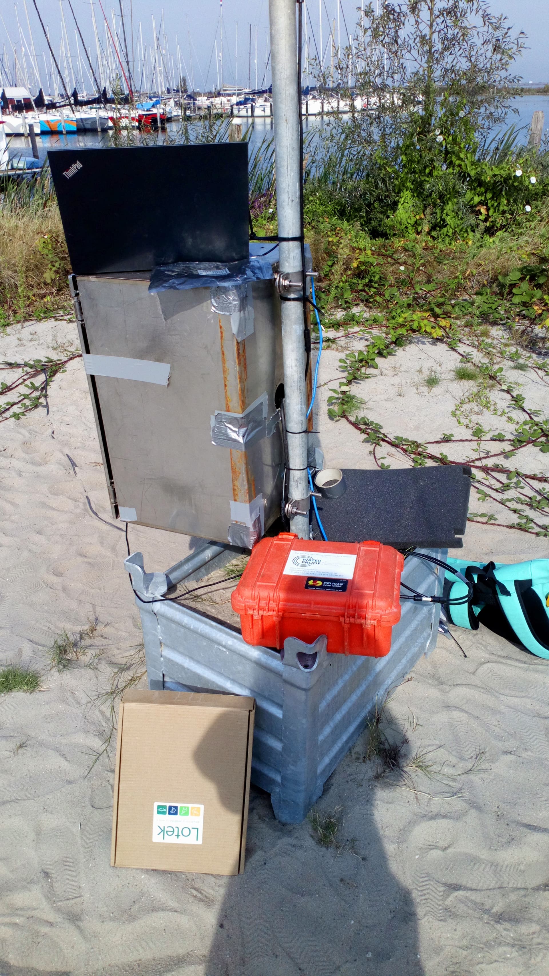

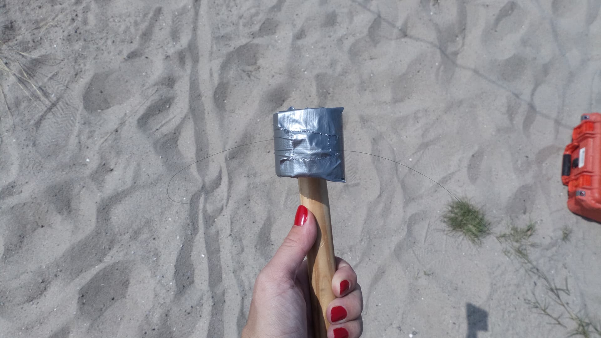

For my most recent tests, I’ve attached the tags to the sponge container horizontally, and I’ve oriented it such that the tags are perpendicular to the antenna’s boom (and thus parallel to its elements). For me, this configuration has resulted in the best signal strengths. This would also imply that a fly-by is easier to detect than an animal approaching the antenna head-on.
Below an image of how I’ve had the tags attached to the sponge container for the last few tests. I’ve had one pointing left and the other right so that symmetry won’t affect signal strengths.

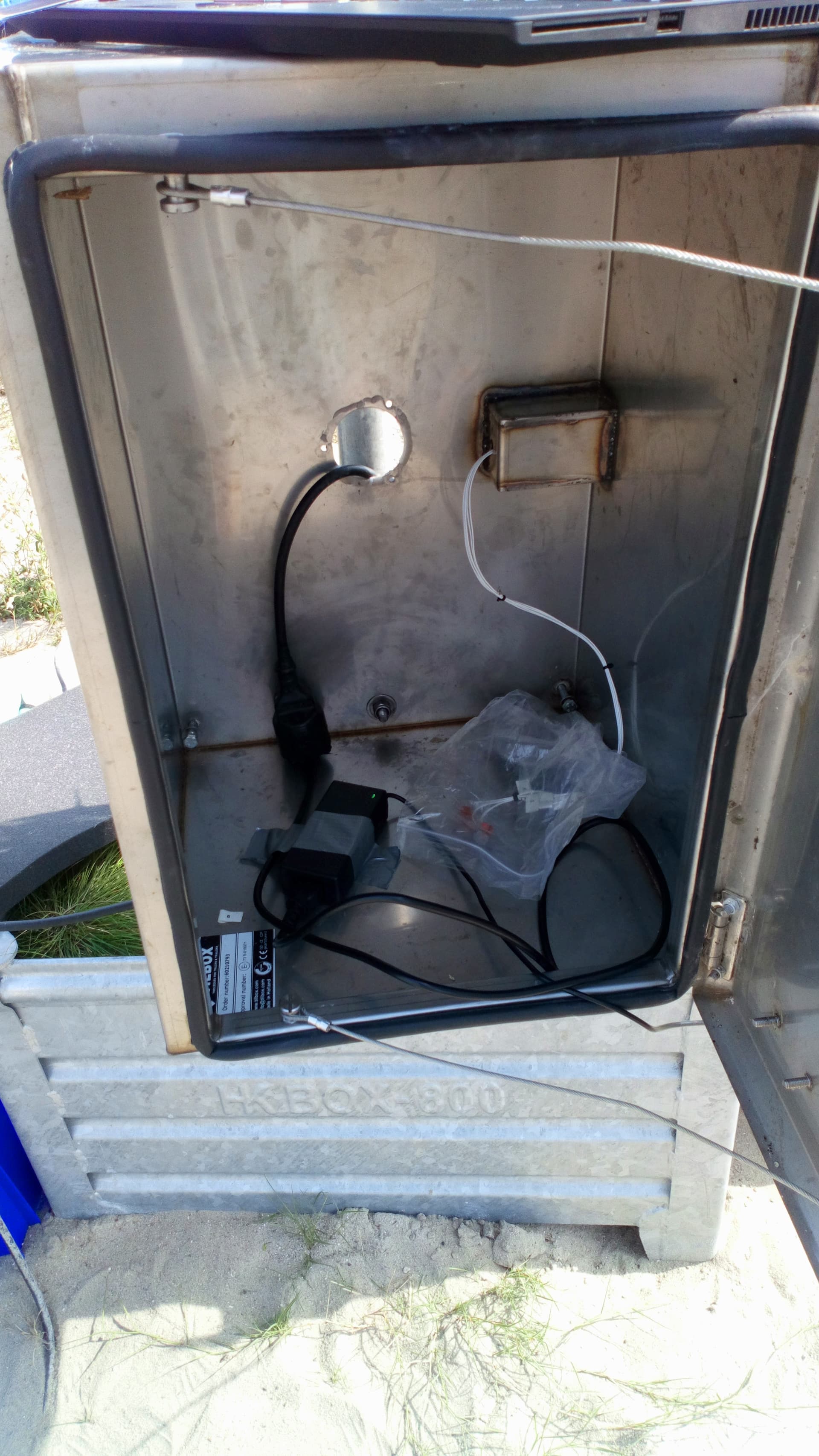

Update on the measurements:
I’ve taken everything out of the steel box, except the 230V AC → 12V DC adapter, as it is likely a noise source that affects the shielding in the coax cables. I’ve also removed the bandpass filter, as it did not seem to consistently reduce noise levels. For these tests, the SensorStation was inside a small Pelican case. A 6-element Sirio antenna was used, with a VSWR of ~1.12. There are ferrite clamps on various locations along the coax cable, as well as at the point where the coax cable connects to the antenna.
I was able to get noise levels of ~-80.5dB by closing the door to the steel box. Noise would be ~4dB higher with the door opened. With the door closed, the noise levels were quite consistent. A few averages of signal/noise at distances:
  • 100m: signal -35dB, noise -65dB
  • 400m: signal -56.5dB, noise -80dB
  • 800m: signal -70dB, noise -80.5dB
  • 1000m: signal -73.5dB, noise -80.5dB
  • 1100m: no tag detections. Live pulses were detected at -74dB with -80.5dB noise.
1000-1200m was the range I expected for a setup with our antenna at ~4m and the tag on top of the dike. It likely would have ended up as at least 1100m, but the signal dropped a bit faster at the 200m to 400m range than in some previous measurements. We ended up with 2-3dB lower signals, but also ~5dB lower noise, yielding a net improvement in detection range.
From all the testing I’ve done so far, the culprit in my case definitely seems to have been the power supply. Moving it in certain ways can easily swing the noise by up to 10dB in some cases. Completely isolating it inside the steel box has given me the best results so far. Luckily, for our actual motus stations we won’t have to deal with an adapter so close to the coax cables, but this noise source can definitely mess with testing setups and waste a lot of time if you’re not aware of it!

Late to the discussion, but using NTQB2-2-M on Myotis lucifugus I have been able to detect the tag at an estimated distance of 35 miles (previous record 30 miles) using a 5-element yagi antennae elevated on an extending painter’s pole and a Lotek SRX800-M receiver.
We have not been able to duplicate this distance in detection or anywhere near that from our stationary automated receiver stations (temporary motus towers with similar antennae).
What max distance did you discover? Please reach out if you’d like to discuss further!

I’m interested to hear about your setup. 35 miles is 50 times as much as our 1100m, and it’s much further than I’ve heard from many other people. With our current setup (which uses a linear AC-DC power converter), I have reasons to believe the main limiting factor is the Fresnel zone. I’m guessing that your pole-based antenna is watching over a valley of some sort, and the 35-mile detection was on an animal in flight. We are possibly planning to do operational tests using a suspended tag (kite-based or plane-based) to see whether that improves the detection range.
What I’m most curious about is the numbers (signal strength + noise) you’re getting. Our station gets down to noise levels of about -80dB, and with the 6 SNR, that means we detect signals down to -74dB. Do you have those numbers for your 35-mile detection? Additionally, if feasible, it’d be very interesting to place a test tag somewhere (on top of a pole or such, a few m off the ground) and see what numbers you get in such a case. I suspect the in-flight numbers will be much higher.
My personal observation / conclusion is that most of us that have done experiments around tag range arrive at disappointing numbers where the only valid conclusion seems to be that Motus cannot possibly work, yet it does! I suspect that the difference has to do with tags on flying birds vs tags on poles (although drone experiments should compensate for that), dielectric properties of birds in motion vs test tags on unchanging pieces of sausage or saline water sponges, differences in noise floors in many experimental set-ups vs. true backcountry stations, and more… It’s been a rather frustrating experience so far…
