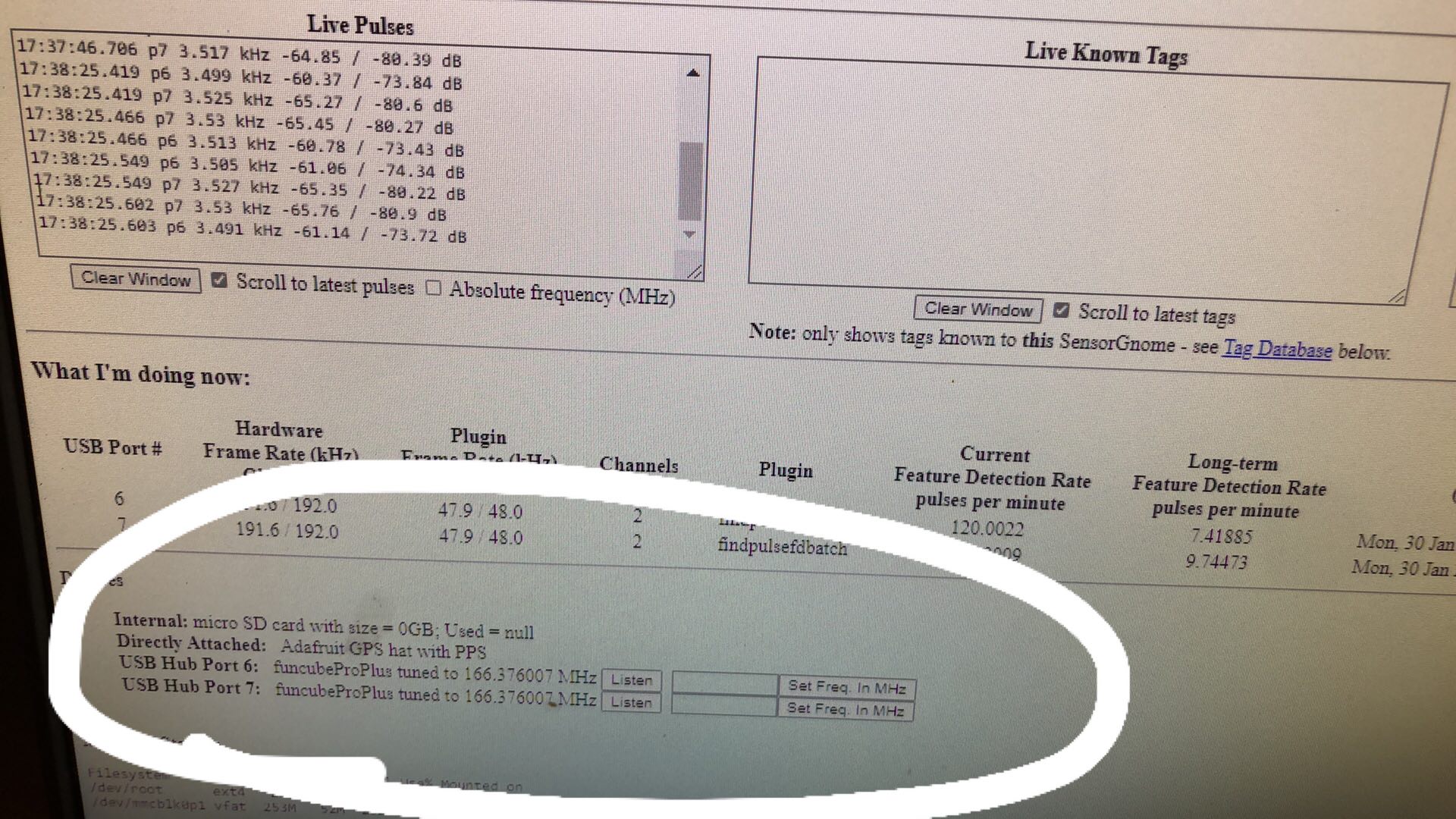

When we plug the sensor station into the computer, we can see some live pulses but no known live tags. This is likely because we haven’t uploaded a tag detection database to the funcubes but my understanding is that this shouldn’t affect detections showing up on Motus. I’ve attached a screenshot of the web interface and it looks like everything is as expected (I think).

Hi Heather. Is the SensorStation offloading data automatically (cellular, WiFi)? If so, the data goes through CTT servers first and there can be a delay (sometimes several days or longer) before the 166MHz data makes it to Motus for processing and display. Everything looks fine on your screen shot.

For your purposes, if you know the burst rate of your tag, you can watch the Live Pulses window for regular detections at that interval and be fairly confident that your tag is being detected.
