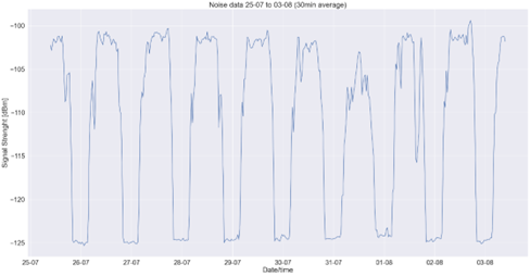

Yes I have seen serious disturbance by solar panels on our tagging frequencies, this was at a test location with permanent equipment installed, it showed a nice day/night graph. So at test days’ the complete solar parks were shut down for our tests.
In this case no sun was no disturbance!
I don’t think all solar panels / converters generate a lot of noise. But some do for sure!
This graph was generated 30m from the solar panels, and noise was 6dB lees at every double distance to the receiver.

Hello Ewan,
