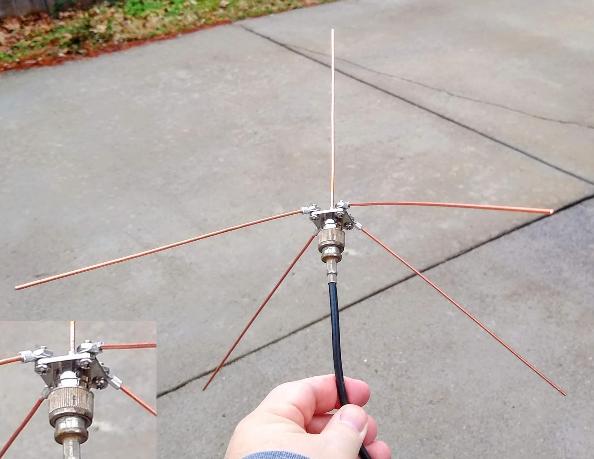

If you are okay with an omni-directional antenna, this one was made specifically for the 433 Mhz band but can be cut for any specific VHF/UHF frequency. It uses copper wire for the elements. Small machine screws hold the ground elements in place (see insert). It was made using a SO-239 connector. Gain is nothing to write home about, around 3db if ground elements are bent at a 45 degree angle downward so height above average terrain is your friend. Google image search “diy SO-239 ground plane” for more details.
