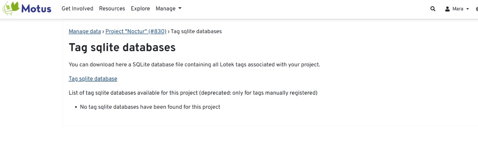

Me and my team are fairly new to Motus but we are building several stations in southwestern Norway now and in the coming weeks. We are struggling to find up to date and relevant information in the Motus docs for how to download the tag database from the website so we can upload it to our sensorgnome and thus test tags while deploying our stations. The tags we are testing are registered on the Motus website and are successfully activated (verified with a handheld receiver). See attached error message when we tried to download the .sqlite from the website. Any help here would be much appreciated!

In your image above, the relevant file is actually there. The somewhat confusing “no tag sqlite database” note refers to older deprecated versions that will still be present for older projects. You’ll see what I mean in the example in the updated guide.
Though note that, when I just tried to download the tag datatabase here, I ran into a temporary server error. That may have just been a temporary issue issue for me here, or you may notice it as well. So you may still have to wait to get it on your SG, but at least the updated instructions are there now.

Thanks so much for the quick help and guidance! We had a similar server error to the one you described when we tried to download the .sqlite file yesterday but then perhaps this service is down for the moment. We will try again in a few days and hopefully the issue is resolved by then. Thanks again for your help!!
