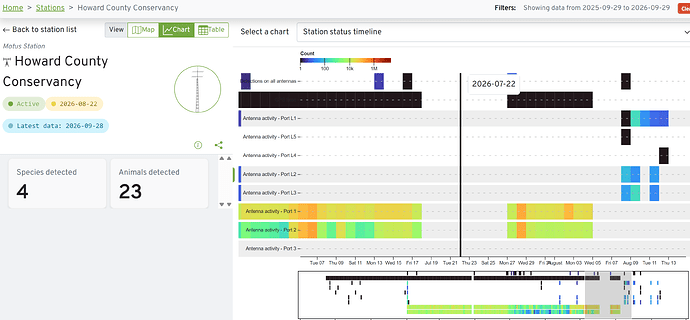

I have been monitoring the data processing, checking daily to see how the backlog is progressing. After the recent pause and resumption of data processing at Motus, my station is showing a gap from 18 July to 26 July. I am fairly certain that the station was capturing data during that timeframe. I have checked Station Status Timeline at other stations - some have the same gap, some do not. Is this a) a gap that will eventually be filled by Motus processing (if the station was operational during the timeframe), b) something I need to resolve if possible by uploading the data from that timeframe, or c) something that nothing can be done about?

Are you both able to share some more info about the gaps? – ideally receiver deployment into and screenshot of the timeline.
For me, It was less of a gap and just completely missing data for the year. All eight of my receivers were impacted. I’ll attach as a list. Since no data came up for 2026 the timeline is only showing past years’ data. I can still take a screenshot but I didn’t know how useful it would be.

Let me know what else you need… Attached is the screenshot for the Howard County Conservancy station, showing the gap I am wondering about. I can get more detailed information from the Manage Stations, but figured this was sufficient to show you what I am looking at.
Appreciate any insights you can provide.
Mark

Hi @mtc, you said there were a few other stations of yours with the same missing block? Can you share a serial number / deployment id?
Josh.. actually, they are not “my” stations. I randomly peruse the status of stations in the US NE region in order to see if our station is experiencing anything “anomalous”. I will check my notes later to see if I wrote down the station IDs. When I was first keeping an eye on the processing having started back up, I sampled a couple of sites and they had the same gap. Later, once I found sites that did not have the gap, I realized our issue was not Motus-wide. That’s when I posted my question here.
@jsrs I looked at my notes - I did not make note of other stations that had the same or similar gap. Perhaps it was luck of the draw. If the gap is not a systemic issue, then it seems like I need to look into resubmitting the data in that timeframe. Please let me know if you think otherwise! Thanks - Mark
Hi Mark, sounds like this is a known issue and affects a number of receivers. The missing block of data is in the queue but will it be a while before it gets processed.
