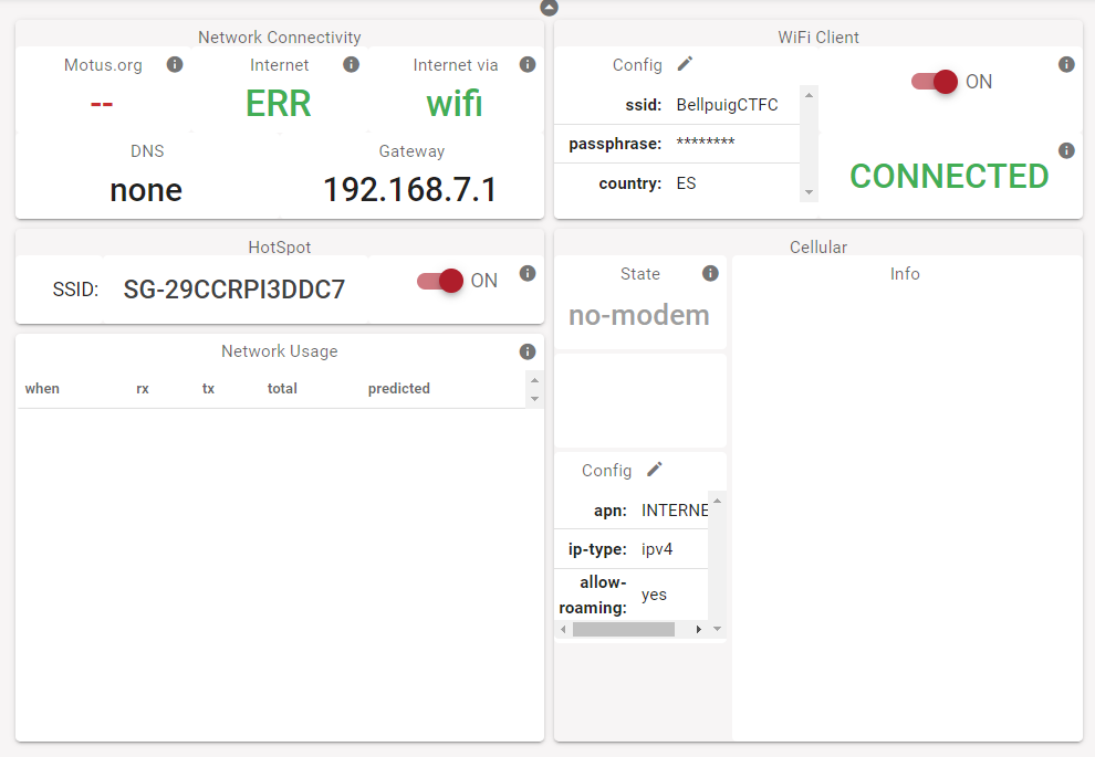

Hello everyone, I’m setting up a station in a remote area in central Spain, and I need it to be fully autonomous with a battery and solar panel. I also plan to add a Wi-Fi router so the data can automatically upload to Motus server. However, I’m facing some issues, and now I’m seeing an “ERR” message in the internet field.
Has anyone encountered a similar problem or have any suggestions on how to fix it?
Thanks in advance!
The problem is the “DNS: none” in the network connectivity. This means that the SG doesn’t know the address of DNS servers to use. This is expected to be specified via DHCP, so your wifi router evidently does not provide it, it’s a pretty standard thing. If you manage the wifi router you should be able to go into its settings and set a DNS server (for example 1.1.1.1 or 8.8.8.8), if someone else manages it you can ask them. I can also figure out how to set a default DNS server in your SG. It may be worth it to SSH into your SG and ping 1.1.1.1 and verify that you get responses, this will show that you actually have internet connectivity.
