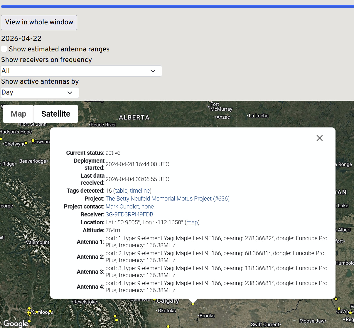

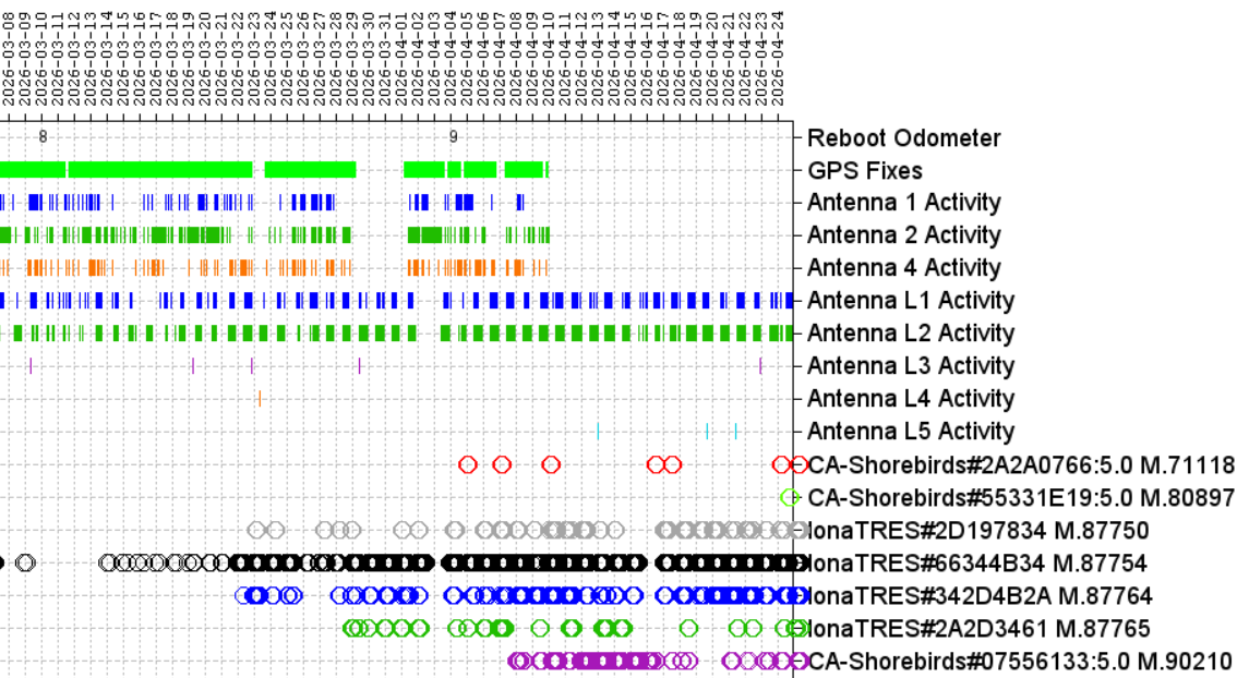

Looks like all our the DIY Sensorgnomes are falling behind by 17 days or so. Server issues or is the webpage reporting the wrong Last Data Received date?

Hi Mark, unfortunately the data processing backlogs remain an ongoing issue, due to a variety of related factors. For V2 SG that are internet connected, you should be able to confirm their connectivity at sensorgnome.net
