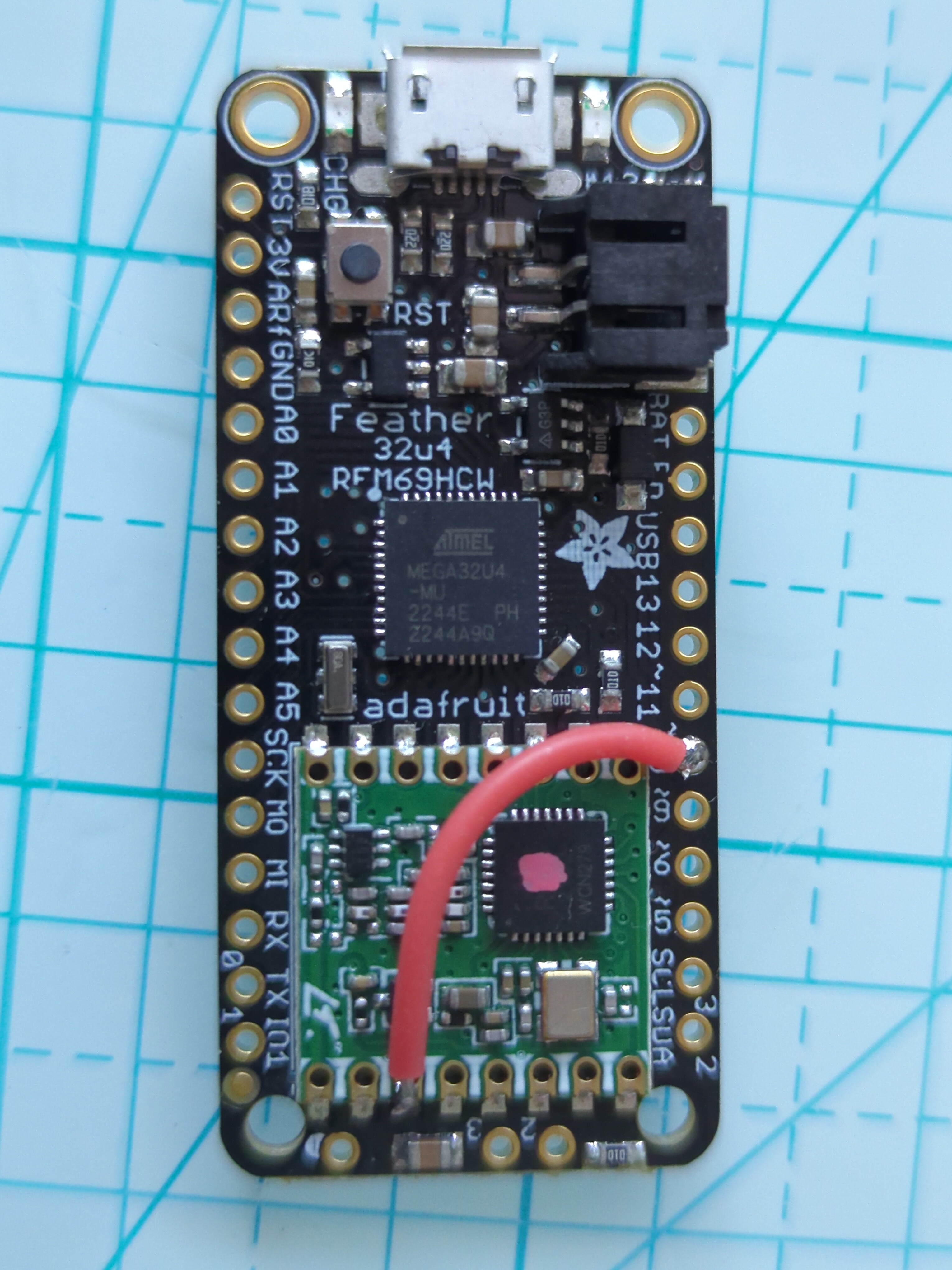

FYI, the V3 firmware requires the radio’s DIO3 pin to be connected to the processor’s pin 10. If that’s not done, all RSSI values show as 0 and often the dongle is not recognized by Linux. Here’s a pic of my wire (fat and red and routed diagonally for clarity, a thin wire neatly routed would work the same and look better…):
I’m in the process of releasing a new image of the Sensorgnome V2 software that supports this version of the dongle firmware.
Thanks for that Thorsten, I’ll add the wire.
Should have a couple ready to go by late next week, just waiting for the 3D printed boxes to appear from a friend. Adams instructions were very good, thanks Adam! (might want to add the wire to the instruction set whenever you get some free time. :) )
Thorsten, I’'d be happy to test your latest version of the Sensorgnome software anytime after that.
