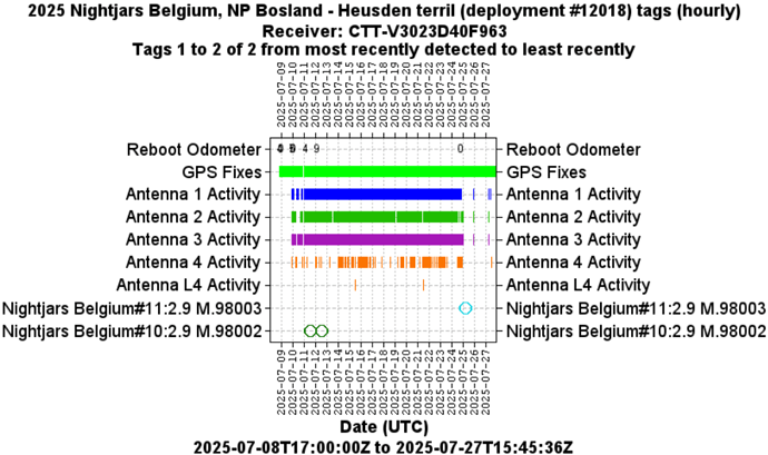

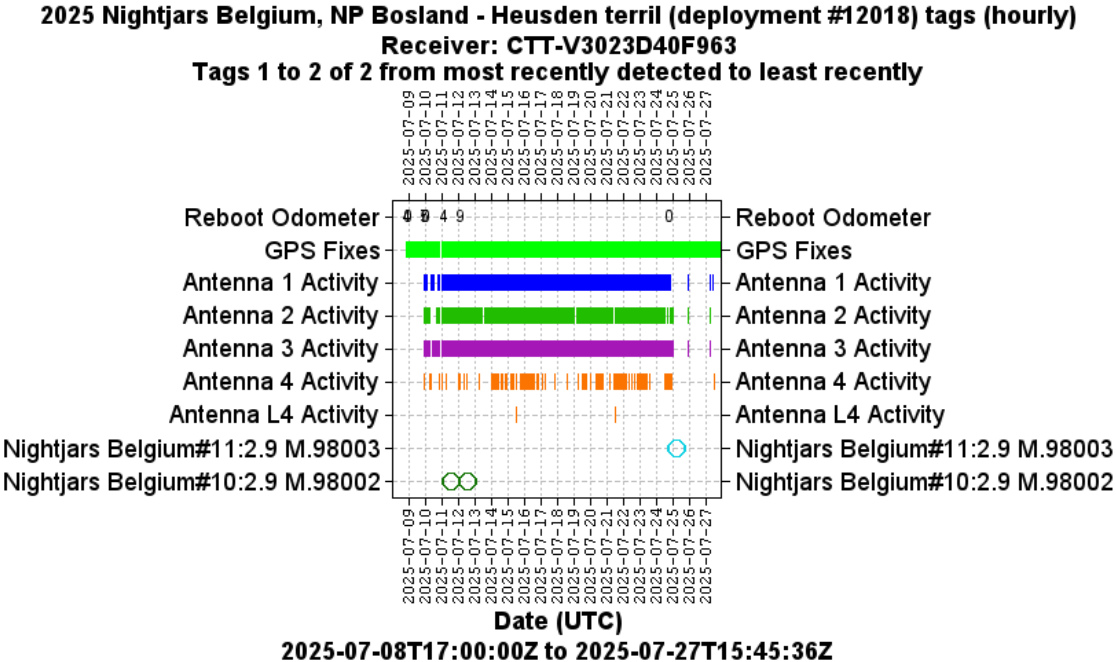

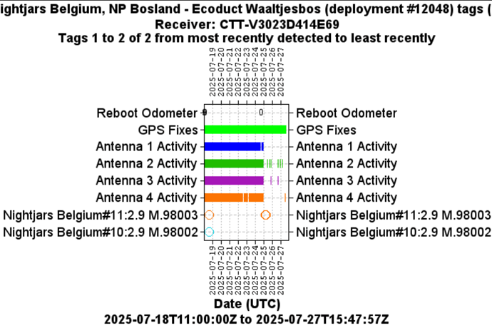

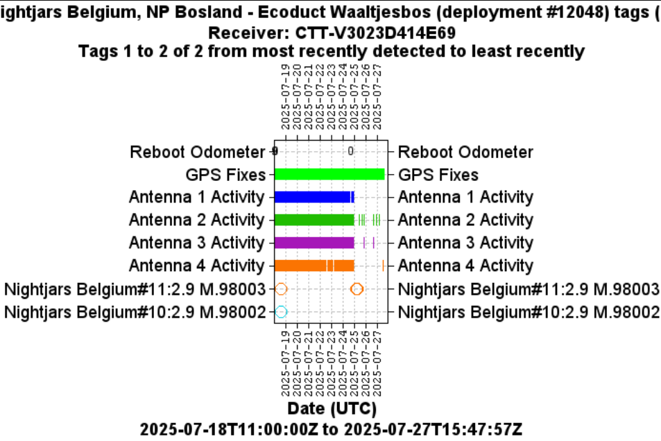

Two of our stations (#12048 NP Bosland - Ecoduct Waaltjesbos, and #12018 NP Bosland - Heusden terril) seem to be properly connected to a cellular network and send data from our test tags through. However, when I look at the deployment timeline on the Motus website, the activity on the antennas seems to be fragmented. Is this normal, or is this indicative of bad connections in the antennas/coax cables?

That antenna activity looks very normal to me, and tends to vary station-to-station and even between antennas based on local ambient noise.

As Nick says, the antenna activity on those timeline really does vary, and gaps aren’t unusual. And yes, it can also be due to bad connections or faulty antennas.
Something does look a bit odd with those though. The GPS bar is unbroken, so something is being transmitted over the cell network. All 4 FCD turn off right at the time the “reboot odomter” increments. Following that, several FCD do come back online, often at the same time, before cutting out again often at the same time.
This may be related to a very long-standing issue related to how multiple FunCubes are handled by some versions of SensorStations and Raspberry Pi-based SensorGnomes. The issue has been fixed by CTT in later versions of the SS software image, though there remains an inherent challenge in running more than 3 FCD while also running the cell modem and WifI module. The newer SS software provides toggles to turn the cell and / wifi off if needed. You can read more about that at the link below. Hopefully the steps here resolve your issue!

The coloured bars on the deployment timeline that you copied above represent hours in which any radio activity on a Lotek frequency was recorded – whether or not it resolved to something like a “hit”. The pattern in the timeline appears to show the dongles failing completely and recording nothing whatsoever. If your handheld detections occurred during those periods, it would make sense that you didn’t get any data.
But if, as you suggest, you also saw those tags on the SG interface, there maybe something else going on, and it may be related to the important differences between the standalone tagfinder that runs on the SG and the global tagfinder that runs on the Motus server. There is a little bit about that here. And there are multiple filters that the processed data goes through which might also affect what you’re seeing. Though the complete processed data is always available in R so you should see everything, even runs of length 2.
