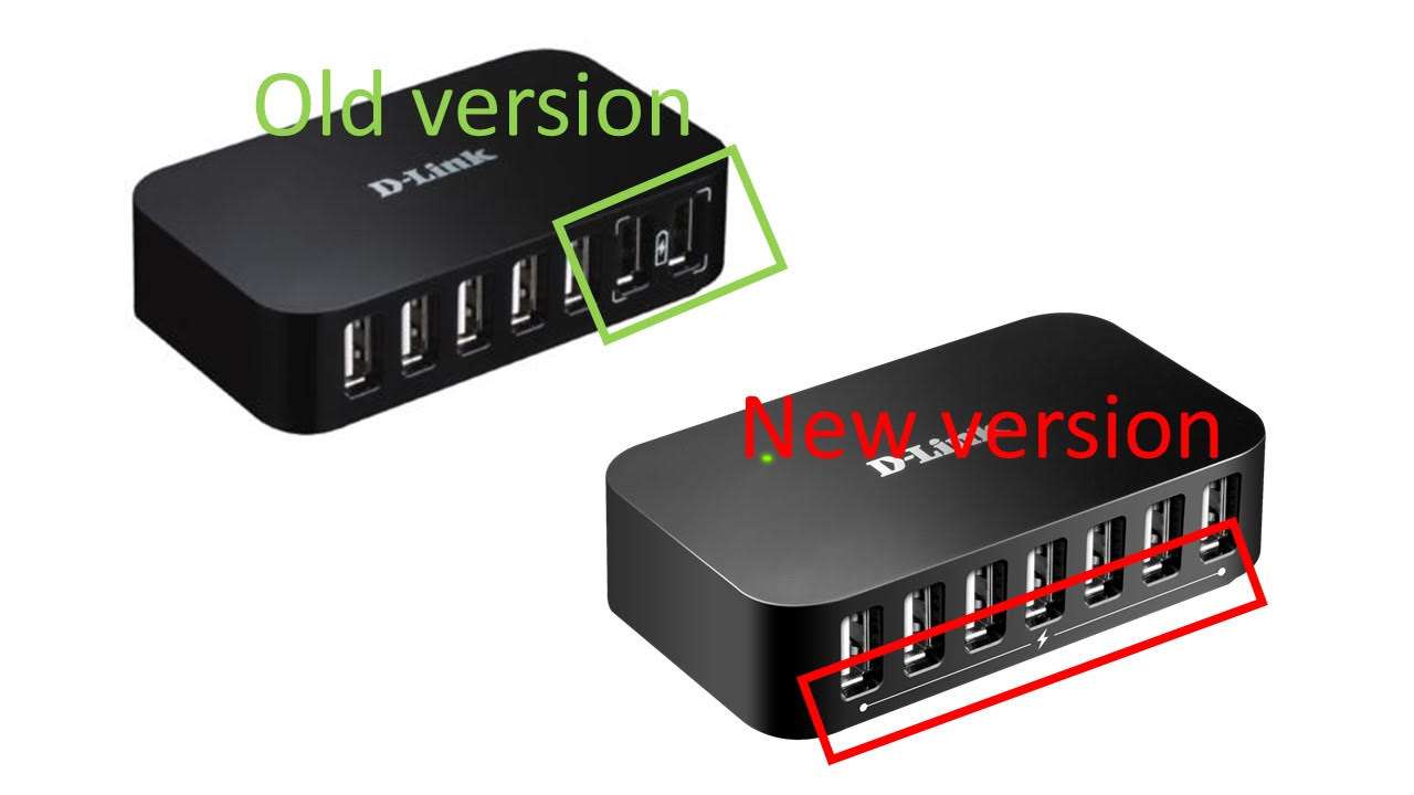

Hi Thorsten,
I struggled earlier with this problem and solved it by using the old version of the Dlink 7 hub in between. Why not using that? An Anker USB charger with two ports is noiseless, and can feed the Hub (by a such a USB to DC- cable and the pi).
René
Yup a powered hub works. But I’ve run into other low-level USB issues with hubs too, and the “old” version that you highlight seems to cost more than the cell modem… Plus it’s more stuff and more cables to fit into equipment boxes. Not an issue in some installations and painful in others, especially battery powered ones.
