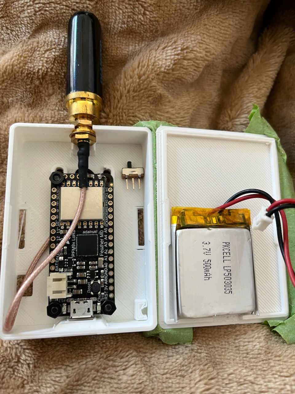

here is a picture of the test tag simulator that I built
It can simulate the test tag that I recently purchased. It is registered and deployed as a test tag. My SG sees it and it gets processed by Motus.org and I have downloaded the hits from Motus.org. The next question I have is if I take this to another station whether Motus will process the tag and provide me with data on the hit. I am just not sure what Motus’s programming will do with a tag that is marked as test. One of the thoughts I have had is creating one universal test tag for each kind that can be set up NOT expire so that everybody could have a cheap test tag to test their systems with. this makes sense from the stand point of tying up tags id and prevent the eventual re-assignment of a test tag to an active bird causing an aliasing nightmare for the researcher that gets it. So, I would think that both LOTEK and CTT would like to avoid this as well as Motus. So, in essence I agree with you and would be willing to use my tag for this purpose, 3, 000 days and counting. I think it is a necessary step towards increasing the coverage to a larger community as well. But this decision has to come from the others.
My relevant background is I have an active Tech class Ham license, and I am a retired programmer. While most of my career was working with databases and server programming I have been experimenting/learning about microprocessor programming.
William
