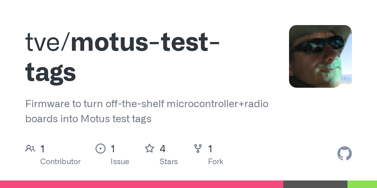

What did you use to flash them an what firmware was used?
I followed the below.. it worked great, and I didn’t have any complications flashing over USB as described.
Just to clarify, @mtc’s post is about using the feather essentially as a test tag, emitting a dedicated test tag code.
