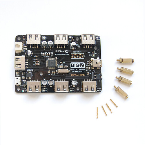

I went for the raspberry Pi 3 B+ option. I didn’t choose the “DLink DUB-H7” option, but the “7-port hub” option.
This USB hub connects directly to the raspberry. My problem is as follows:
the HUB is connected to the raspberry’s USB 2 port by default. As the HUB must be connected to USB port 4, I can’t have several funcube dongles on the HUB (they all appear to be on port 2…).
Has anyone ever used the 7-port hub? Is it possible to make the raspberry understand that the HUB is connected to port 2?

Do I gather correctly that you are using the old Sensorgnome software from 2018-2019? I can’t offer much help for that but I know that the port assignments are encoded in files in /home/pi/proj/sensorgnome/udev-rules. I can offer three solutions for you:
use the jumper cable that comes with the hub to plug the hub into the port expected by the software (as detailed in the SG instructions)
figure out how to change the files to represent the port assignment you get using the pogo pins connecting the two boards
use the new V2 Sensorgnome software, which has instructions for changing the port assignment via the web ui and with which I’m be happy to help you (see the separate post in this group I made a few minutes ago)
